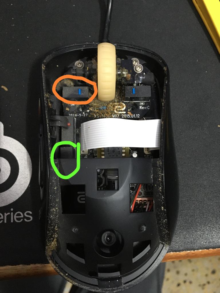

I have the same mouse and had the same problem, what I did was I replaced my faulty mouse click 1 button with the button from the side, in my case the bottom one was less used, so I swapped them. The faulty one works okay, it had the double click issue I think.
I bought this mouse in 2016 and opened it the very first time last year. Worked flawless for 6 years and it was used very roughly in counter strike. Still using it daily.
