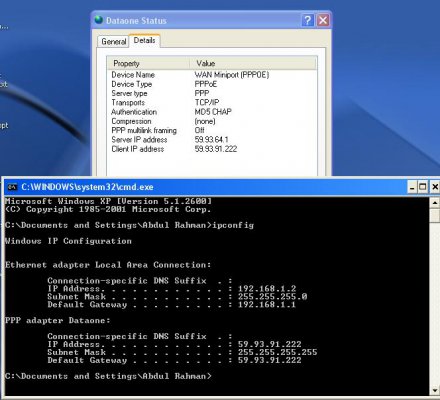

@super, i agree that the router does the assigning of IP, but once thats done the OS also knows about the current public IP of the system. Thats why the IP address is displayed under ipconfig , and even in the status window of network connections.So i was just thinking if there could be possibly a method of calling it directly.
no it's not :p
Wierd, for me it does :hap2:
Yeah , thats because i use bridge mode to connect
