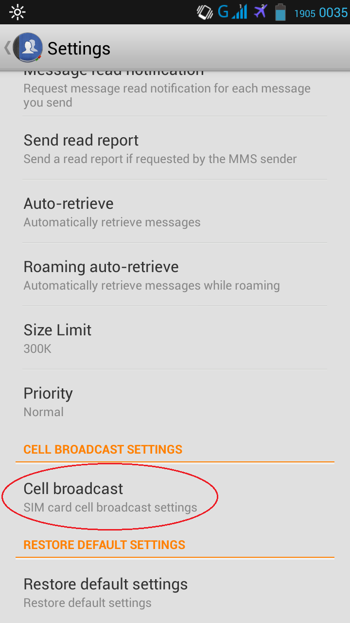

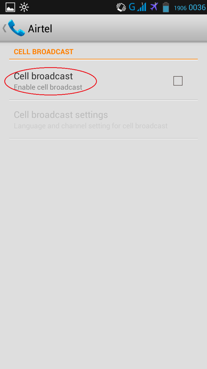

    getting cell broadcas msgs again and again after installing the cm rom. what to do ? hope they are not getting charged to me

    you can disable them. there'll be an option somewhere.

  12. Criminal
    Criminal Well-Known Member
    Veteran
    all ROMs have an option to enable/disable cell broadcasts for each SIM... check your messaging settings.

    i disabled all but still got them. anyway even whatsapp had bugs that i cudnt send whatsapp pics etc. downloaded cm10.2 which is 4.3.1. now working good and problems fixed.
