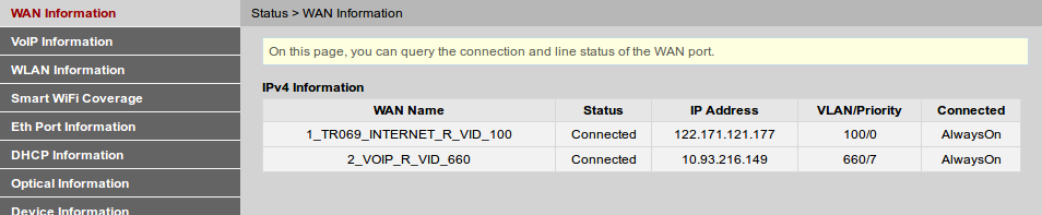

"if you are behind a double NAT" - this means ?
I am using Airtel vfiber. This is the WAN info I can see in my router. Will it work?

Should work, mostly. Lets see.
