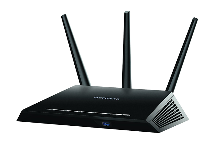

I am not sure if Netgear R7000 has good range compared to others. I have this router. Earlier I used to keep this in one room. If I sit in another room parallel to the first room (separated by a brick wall), there was no 5 ghz coverage. 2.4 ghz was not good enough either. I had to move the router to another room and setup a wifi extender to work around it. Mine is a single floor 2 BHK house (probably less than 900 sqft, max 1000 sqft). Another time, I compared the signal strength (at my parents house) with another router that came with BSNL (that has only 1 antenna, around Rs. 1500). Both were showing more or less same signal strength in an Android wifi strength analyzer app! I paid Rs. 12,749 back in 2015!:mad:
Edit: Just noticed its still Rs. 9600 in Amazon. So Rs. 4999 is a good deal (except may be for the range). Note that if you are planning to use 2 R7000s (one as router and another as wifi extender), Netgear firmware doesn't allow using WPA2 in wifi! Only work around I know is DD WRT.

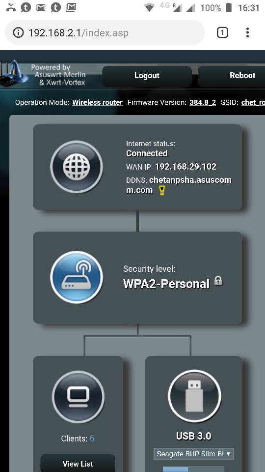

I recieved the router and flashed it with xwrt , from my previous router to this one I see that the pings in cs go have increased from under 20 to 40s,also I see that the entire house is covered now
