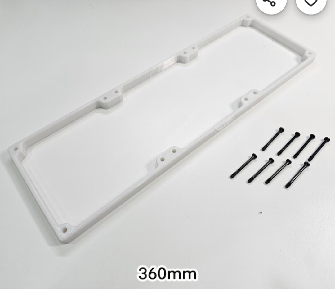

Can anyone suggest a free and easy to use tool to modify STL files? I have a simple requirement (see attached) and think I may be able to it myself by modifying an STL on Thingsverse. Any help is appreciated. Cheers.
