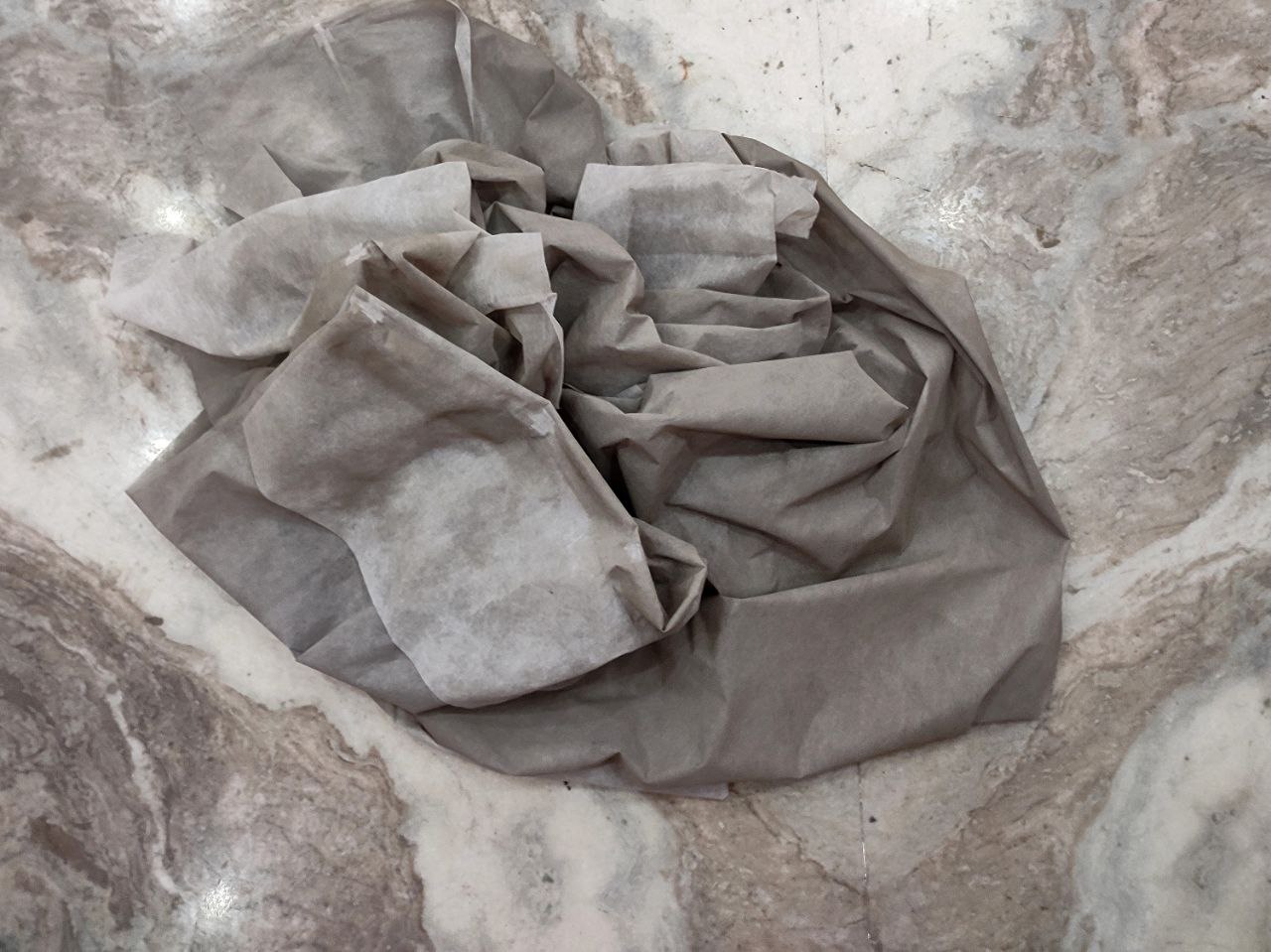

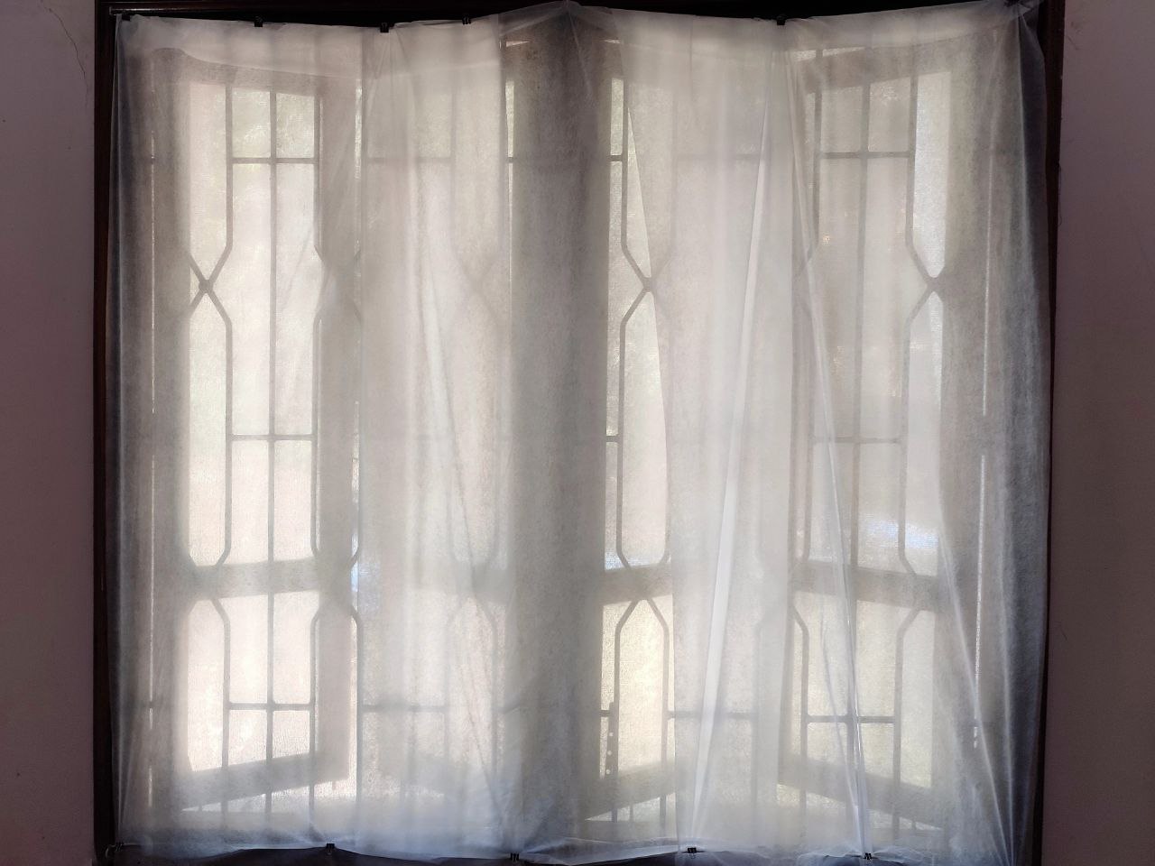

Put nonwoven sheets over your windows and you won’t need them.
One month Two week old sheets:
Fresh sheets:
It works best with stuff under 40gsm, I prefer 25gsm.
Also that window opens into the back of a neighborhood, facing a giant mango tree. Not any road or factory or hotel or warehouse. Just flats and houses. And neverending construction.
If I was in Delhi, I’d probably be changing them every three days. The sheets are just Rs 10 each, and even less if you buy locally instead of Amazon.
I have an diy active filtrator and that I change out every three days. Just made it part of my routine.
It’s made a difference because I like a breeze through the house, makes me feel like I don’t live in a concrete jungle. You can see the windows are barely open.

Have you used a sensor to verify how it works ?
It captures a lot of dust yes, but did you check PM2.5, nasty small stuff that can easily pass through things. Also you will need to do this for every window and door. Still nice to filter it at source. Ideally we need airtight house and then a filtered intake.
Also If there is airflow, the active component inside the house wont be able to do that much. That’s what i see with my room atleast.
Since you are a pretty nifty diy guy, maybe you can buy some cheap and good PM2.5 sensor and then diy that into something you can read.

We do have the house fairly sealed up, the kitchen and dining have open windows like this and so do the bedrooms and we have a bldc exhaust fan to help with the flow of air at a remote corner in the hall, it’s silent enough and never turned off.
This was meant to help with the dust in the air caused by construction in our area (still ongoing after three years).

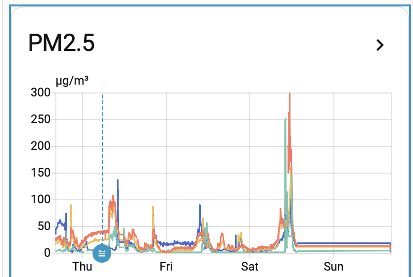

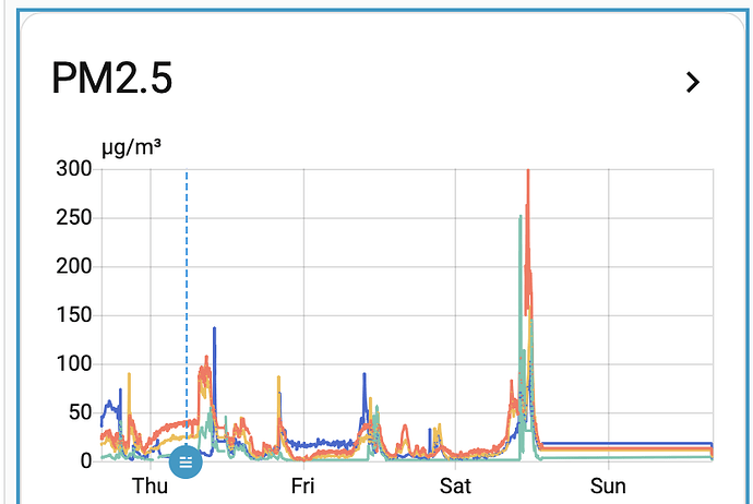

Here is the PM2.5 graph across 4 PM2.5 sensors from different rooms. Everytime you see a spike >20, it’s a door or window being opened for some reason. Big spike you see on Saturday midday is when all doors and windows had to be opened for some reason for 10 mins. 300+ PM2.5.

It’s wrong to assume that pollution stays outside.
It’s not rain that can fall only outside and wouldn’t enter your house.
You need to consider it as gas which enters your premises like Bhopal gas tragedy. Because, it exactly works like that. You’ll know that if you get air quality sensor. You open a window half way and within 10 seconds the sensor goes crazy in the next room.

That is precisely why it is recommended in the manual, that for best results the AP should be run with windows closed. Though not always practical.

I use this size for those windows and change them every two weeks, it works out to be around Rs 100 per month.
It is more tedious than an air purifier but adding something like this to your routine hosue keeping chores is trivial.
This stuff is way cheaper in the local market, less than half the price.
