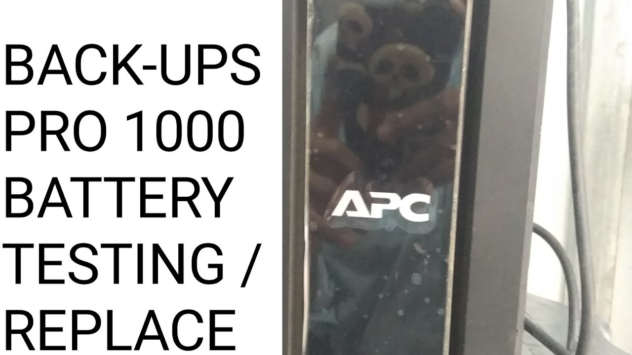

An update: I got my batteries replaced today from a battery vendor in town. They were seeing this arrangement for the first time but well were bit more brave than me to take it apart. Got Exide 2 × 7Ah 12V as the replacement since 9Ah wasn’t available/priced high. Cost me Rs. 2200 in total.
BTW, here’s a YT video I found that shows how it’s connected together. Just need to remove the stickers like @saidu said:
