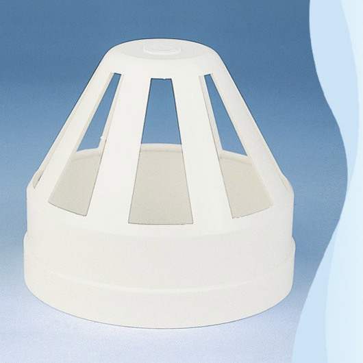

yes. the one that i posted earlier costs 300~400. buy it if you want to beautify that side of the wall. mine is visible from backyard, so i used this model. several cheaper but equally functional options are also available. one is this PVC drain cover which is used by 90% of the people in india:
another option is to wrap a piece of wire mesh (mosquito screen) around the opening.

Outside looks are not important here and will use the drain pipe.In our complex meshes are damaged by hyperactive pigeons.
