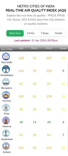

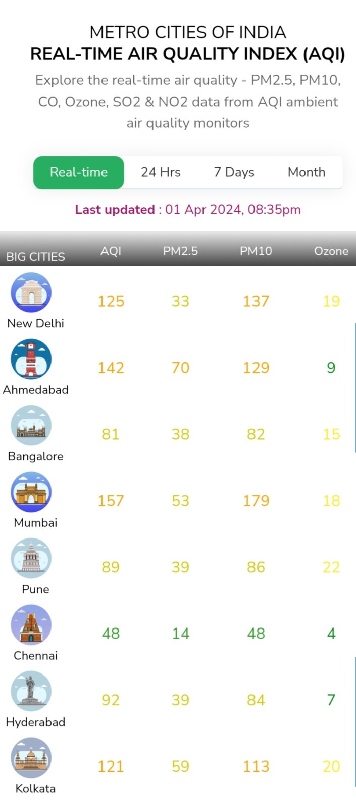

Chennai is the overall winner right now.
