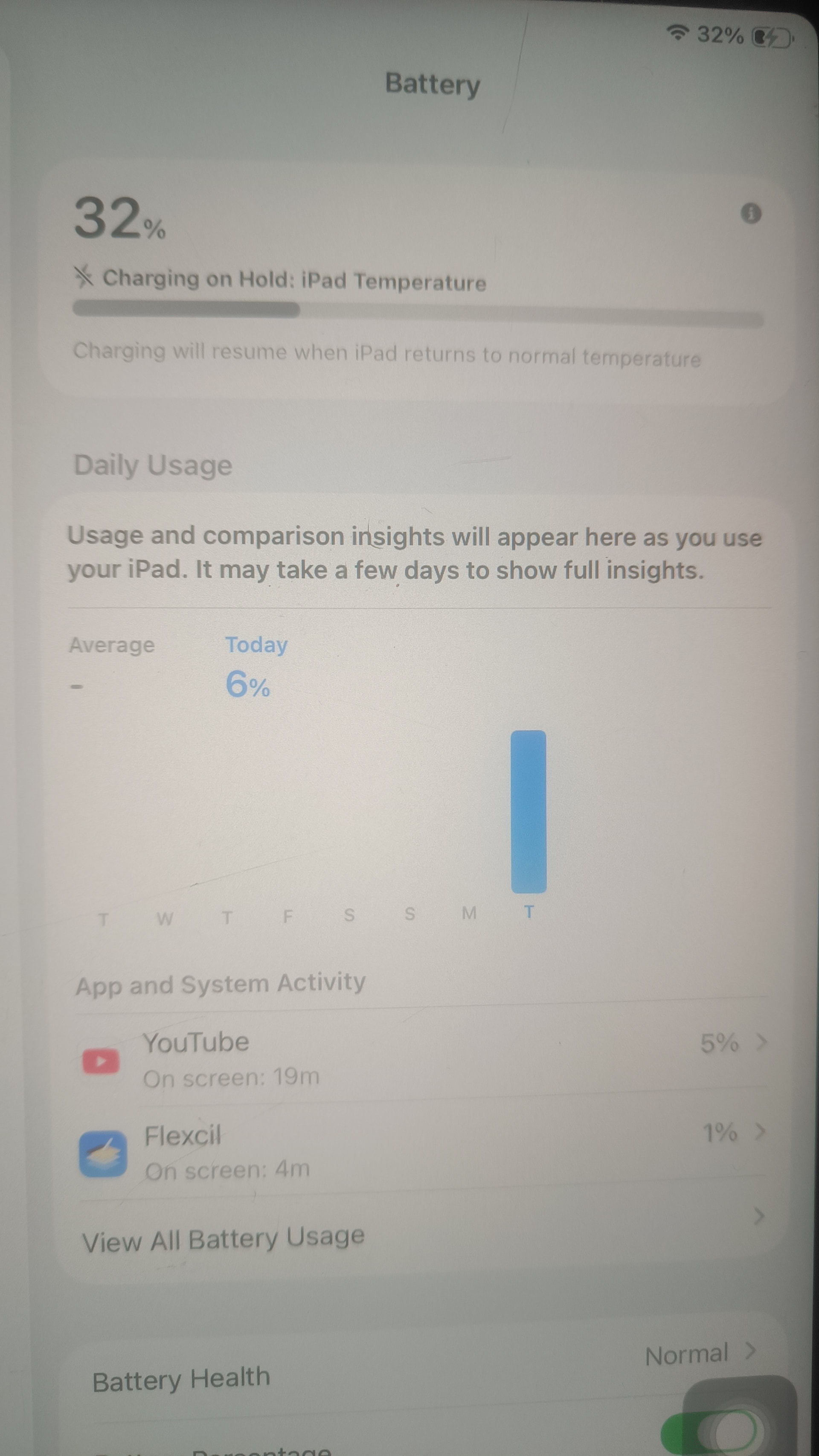

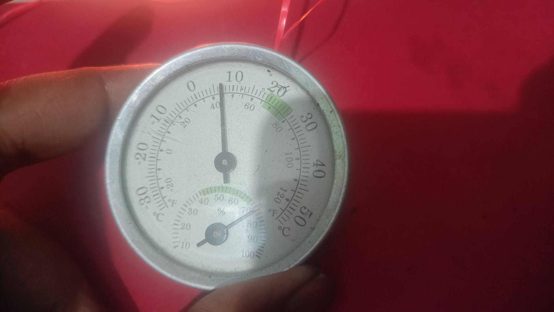

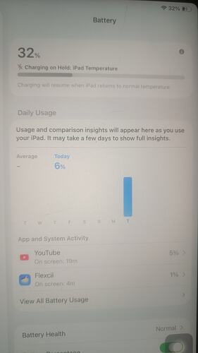

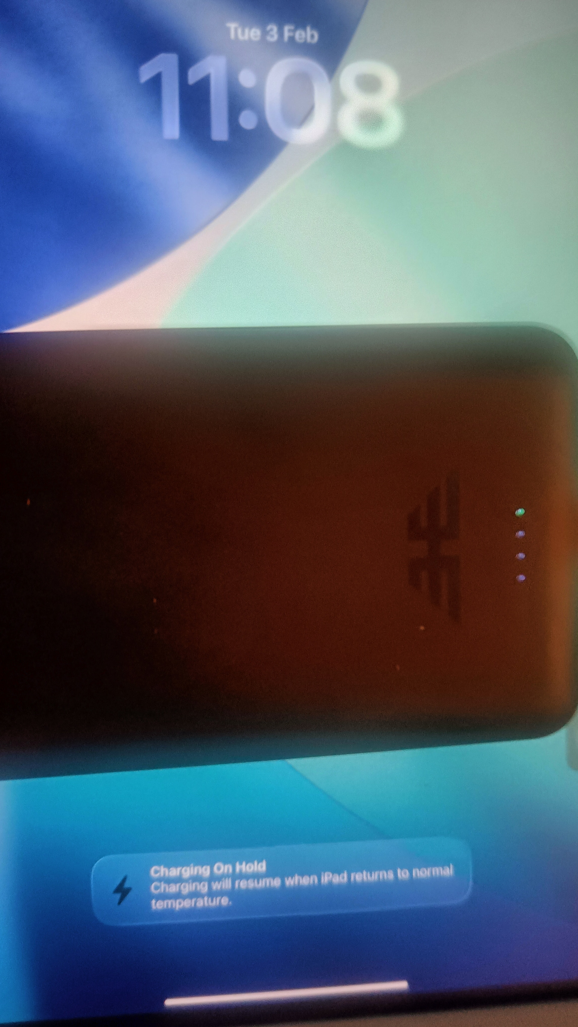

My ipad is keeping it’s charge on hold due to cold.
Though inside temperature is about 5-8°C.
outside temperature is about -3°C to -10°C

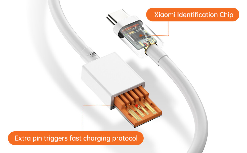

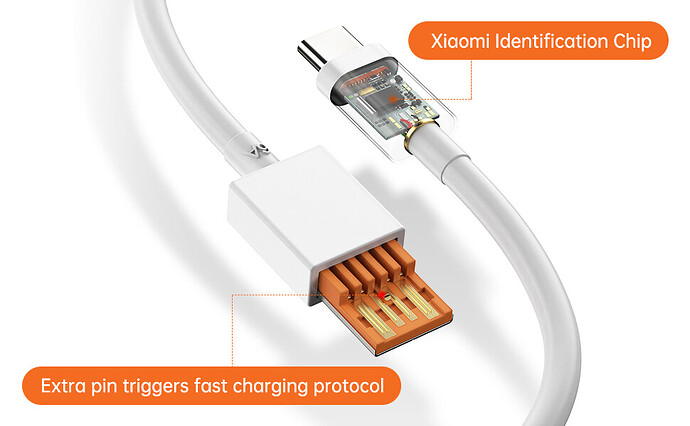

Xiaomi/Redmi have special cables with a non-standard type-A connector that trigger “turbo” fast charging:
Without this cable my Redmi Note 10 is “limited” to 27W charging, with it it’s bumped upto 33W.
This also means I’ll never get 33W charging from a type-c charger, only a type-A one and only a specific one sold by Xiaomi.
No,
Even on powerbanks with 22.5W
It goes on hold due to temperature.
But temperature in this case should refer to device being charged which in turn would suggest that charger/cable was outputting more current than what was required ideally because only outputting more than what is required for charging will result in temperature of device being charged increase more than usual.

To charge the ipad in cold ..I have to keep warm electric bag ( those like water pouch)
Under it ( but it is not in direct touch) there is a thick case plus have to keep them in sleeping bag.
Otherwise Ipad just refused to charge.
Tbh honest 4°C should not be an issue for it to charge.
God knows why it goes on hold for even that temp.
The operating temp is suppose to be down till 0°C.
Is charging temperature not same as operating temp?
Can’t find charging temperature details though.
