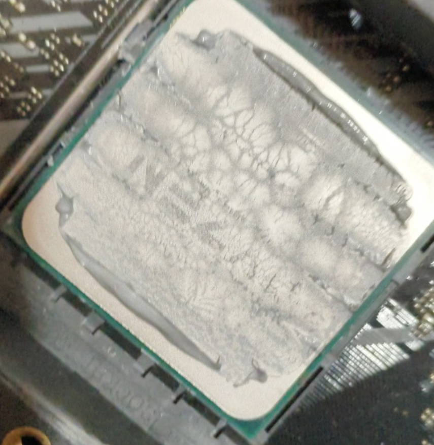

Let’s see some pics of the paste spread if you remove the cooler.

i removed it and its completely spreading to the outside which didnt happen with mx6
its not the best spread but dont really expect this to make the pc super slow. post a pic of the cooler bottom too? I am out of ideas TBH. I’d post picture of cpu cooler bottom too, try and resinatll the cooler if still face issues, post pictures of the installed cpu cooler too. else, I would wait for someone who might have better ideas.

Damn. Check if any of that ooze has seeped into the underside pins.

Paste (even if you use toothpaste temporarily) will not cause your processor to drop clocks or run at low power.
Time to check the socket and pins.

just checked saw nothing no issues
I think you want to post a lot more pictures mate. I think you can rule out issues with motherboard if COU is working and just slow. dont expect paste to create these issues unless somehow it has gone to pins and screwing up with cpu that way. the most obvious reasons to be bad mount, one way or the other and you want to post puctures of the mount to make sure it looks correct I think.
