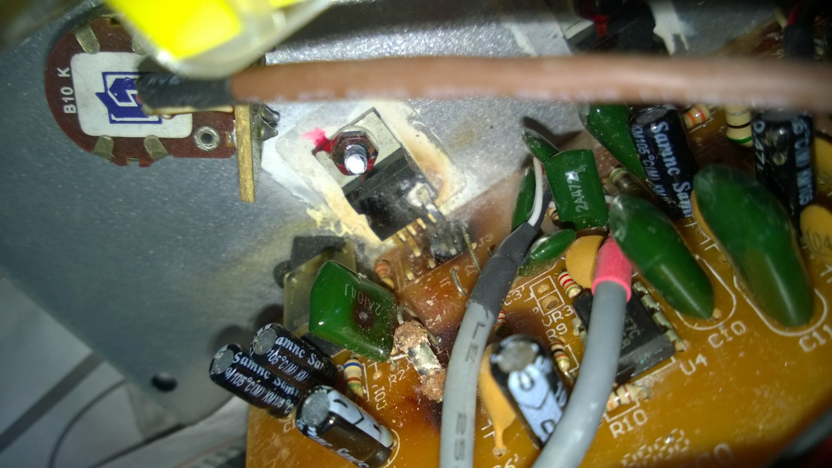

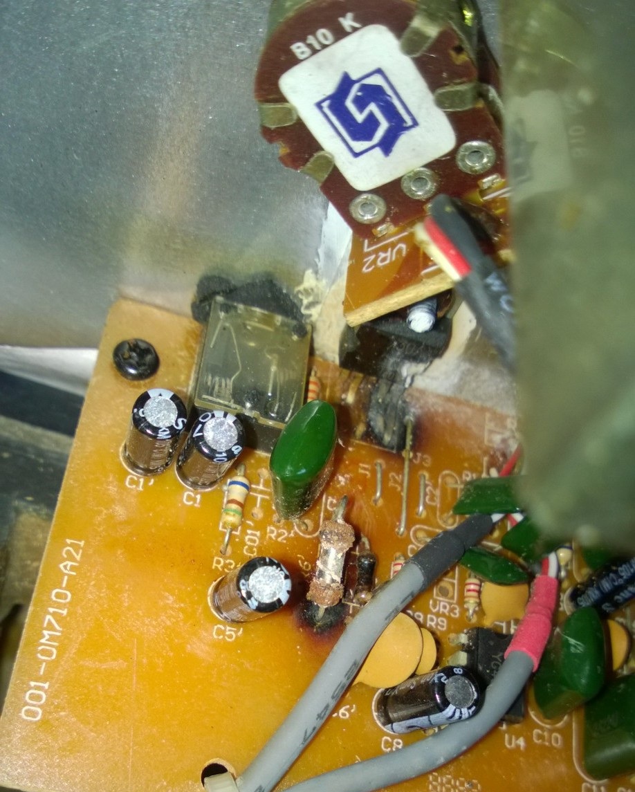

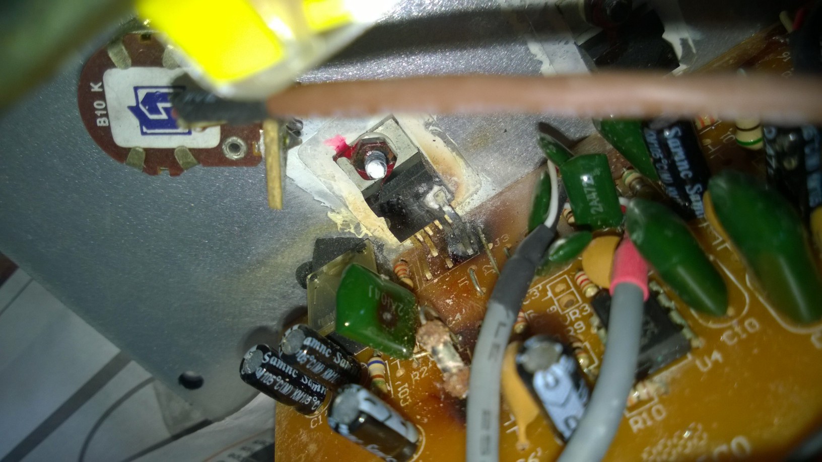

Friend had left the system in his apartment when he had resigned from work so we picked it up. He had no clue about its working condition so when we powered it up, we figured out that there is no output from one of the satellites. Upon opening the subwoofer that houses the motherboard, one of the audio ICs was found to be blown up along with a couple of resistors (I shall open up the sub and post the images/details later). I can however, confirm that there is sound output from the other satellite speaker. The blue-backlit Artis logo on the sub is also damaged. The entire unit is slightly heavy so bear that in mind when paying for the shipping charges.
  1. 1 power-amp (TD2030A), 1 polyester capacitor (2A104J), 1 resistor (2.2 ohms, 0.25 W) and 1 resistor (1 ohm, 0.5 W) have been toast. The values of the toast resistors were deduced based on the symmetry of the other resistors around the vicinity of the other 2 power-amps. Please refer the attached snaps for the details. These components can be sourced locally from your neighborhood electronics components shop and can be soldered by yourself or any shop that does these kind of repairs. Will cost you a couple of hundred Rs. more for the repairs. I could have done it myself if I had the time but unfortunately I don’t.
