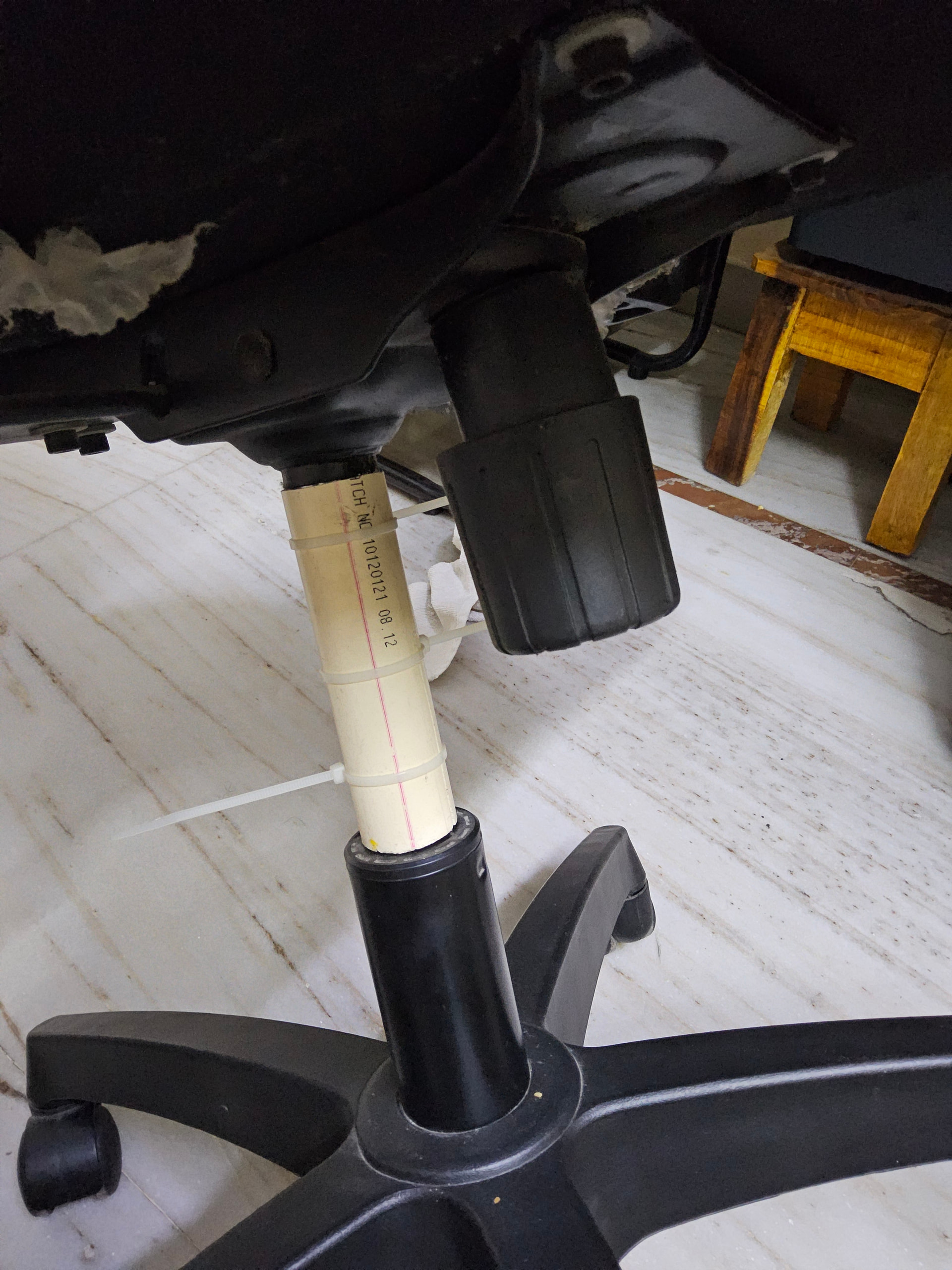

I have been using this for 3 of my office chairs for past 1.5 years. it has been going good till now.
Took a piece of PVC plumbing pipe lying around, measured the right length, sawed it length-wise and applies some cable ties.
I’m amazed and horrified at the same time…. you sir are a legend xD
