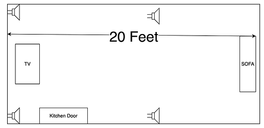

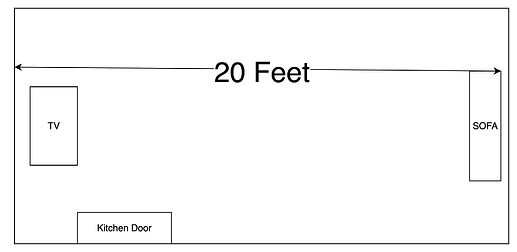

My living room is rectangular in shape (it is actually combined living room + kitchen with wall torn down, years back), the length is about 20 feet. below is a drawing I did in draw.io.
Now you can see that the kitchen door (jodi flat so we removed one kitchen to make hall bigger, this kitchen door leads to the kitchen) is near the TV. For someone sitting on TV, normal volume of TV is low so I would increase volume to hear what’s going on. Problem with this approach is that the volume is too loud for someone in kitchen (they shout on me to reduce volume).
I want to make sure that the person sitting on sofa can hear everything clearly and at the same time, people in Kitchen or other rooms are not inconvenienced.

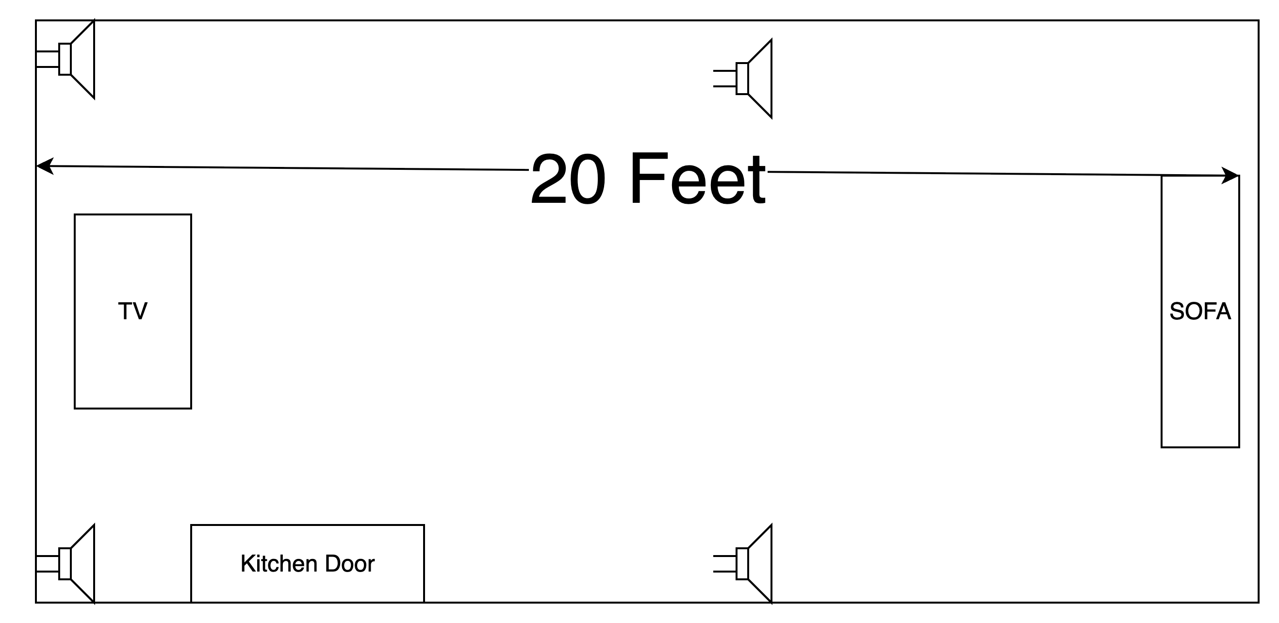

I feel the fix here is to get possibly soundbar + satellite speakers or only satellite speakers. Here is a simple setup I am trying with 4 satellite speakers installed on wall at top near ceiling.
The left side 2 are just above TV in respective corners. The middle 2 are on the beam which (sort of) divides the room.
Please suggest what approach I should take and also suggest what should I buy, see if you can give me specific brand and model (amazon etc link would be great).
Any other suggestion that you can give or have alternate solution, that too is fine.

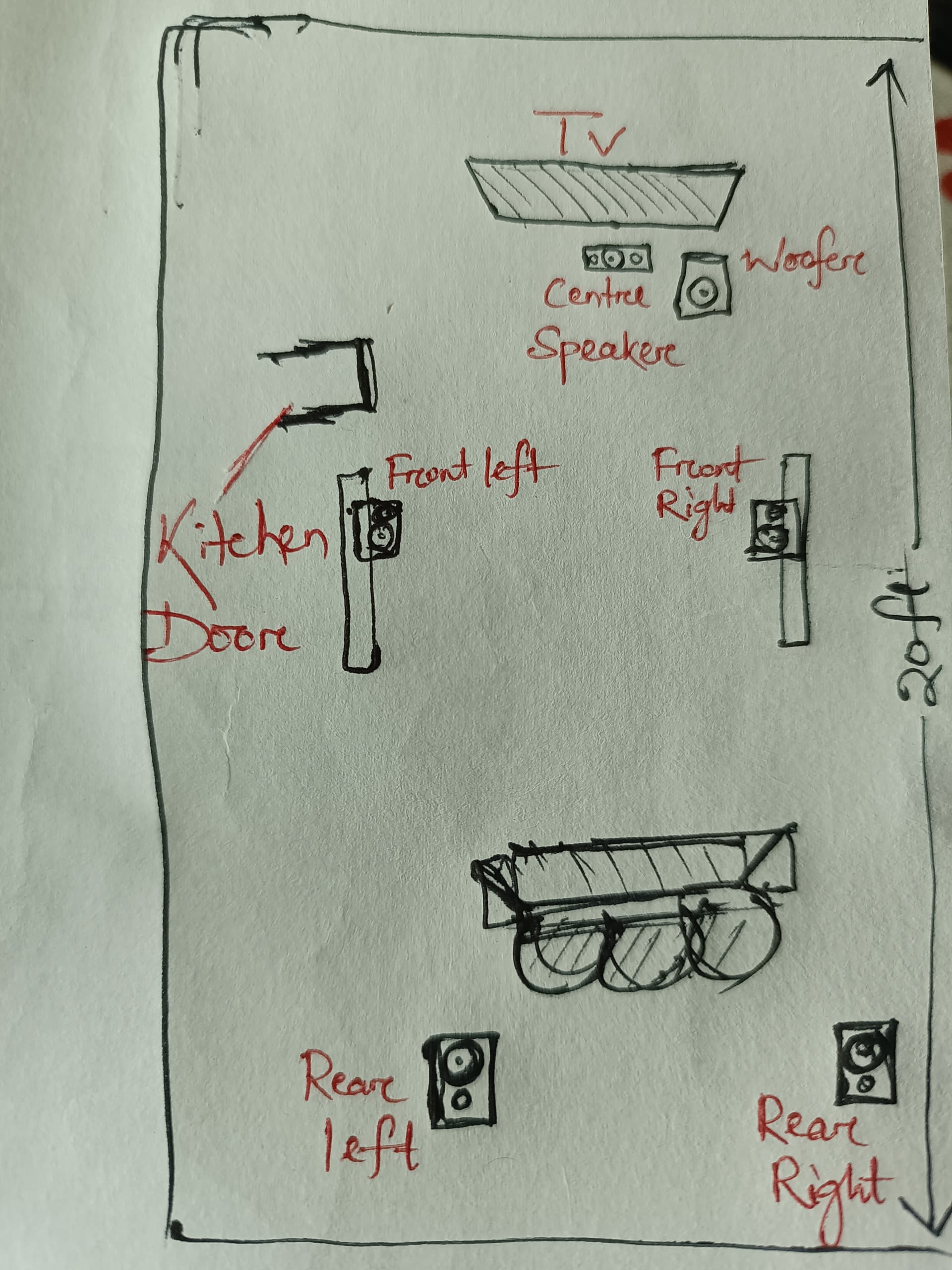

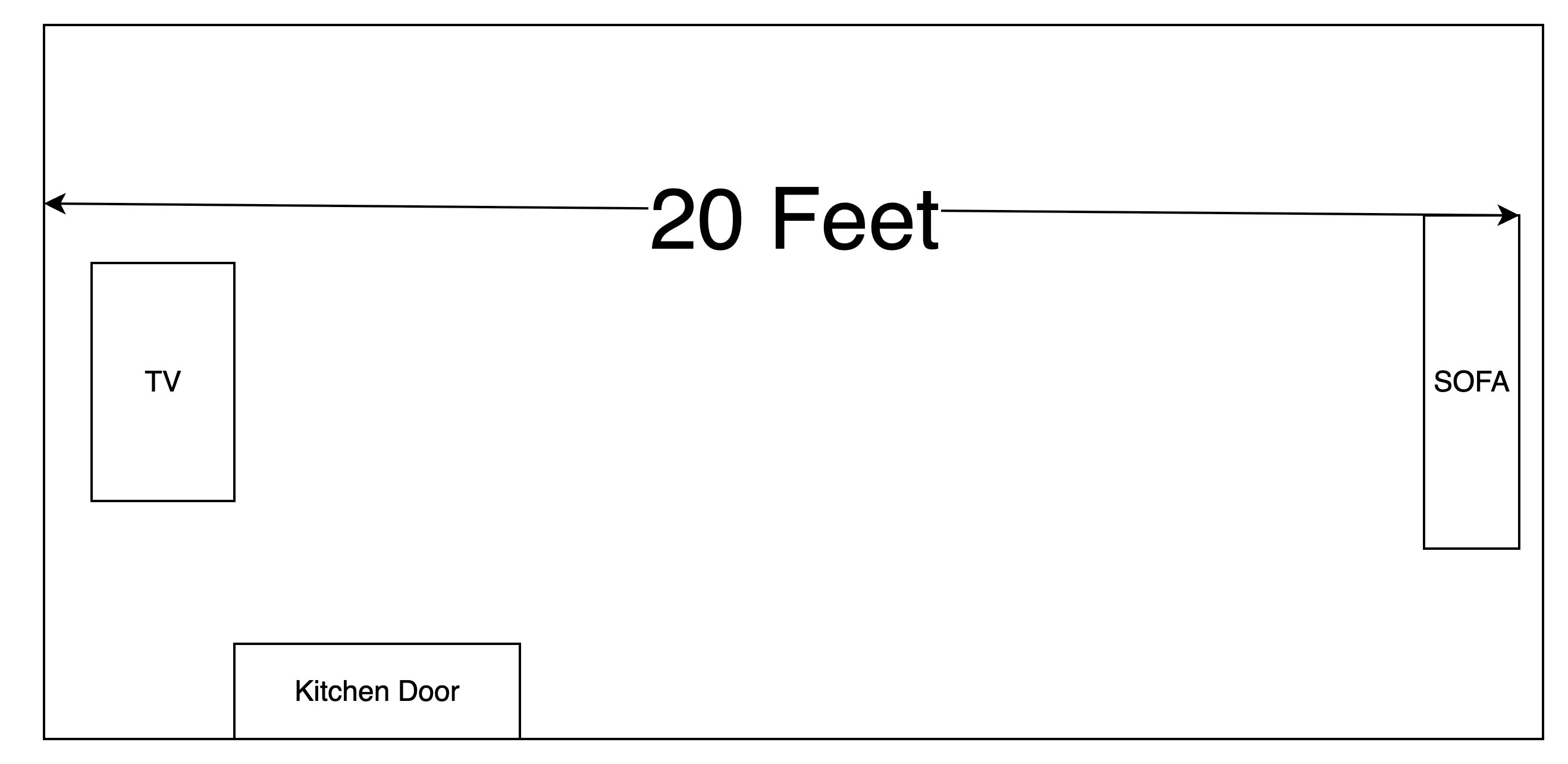

I have a good suggestion for you. Purchase 5.1 wireless sound system or wired if you dont have any issues with wiring. You may put the woofer and the centre speaker under the tv. 2 front speakers in each side of the partition beam and the remaining two rear speakers on each side of the back of your sofa so that you can hear the voice properly. Speakers have setup to turn of rear speakers and only centre and the front speakers will work when you are watching news etc. and all speakers when you want to watch movies etc. As i placed the front speakers near the partition beam which is closure to you, you ll hear the sound properly without disturbing others. Drawing attached.(sorry for bad art :slight_smile: )

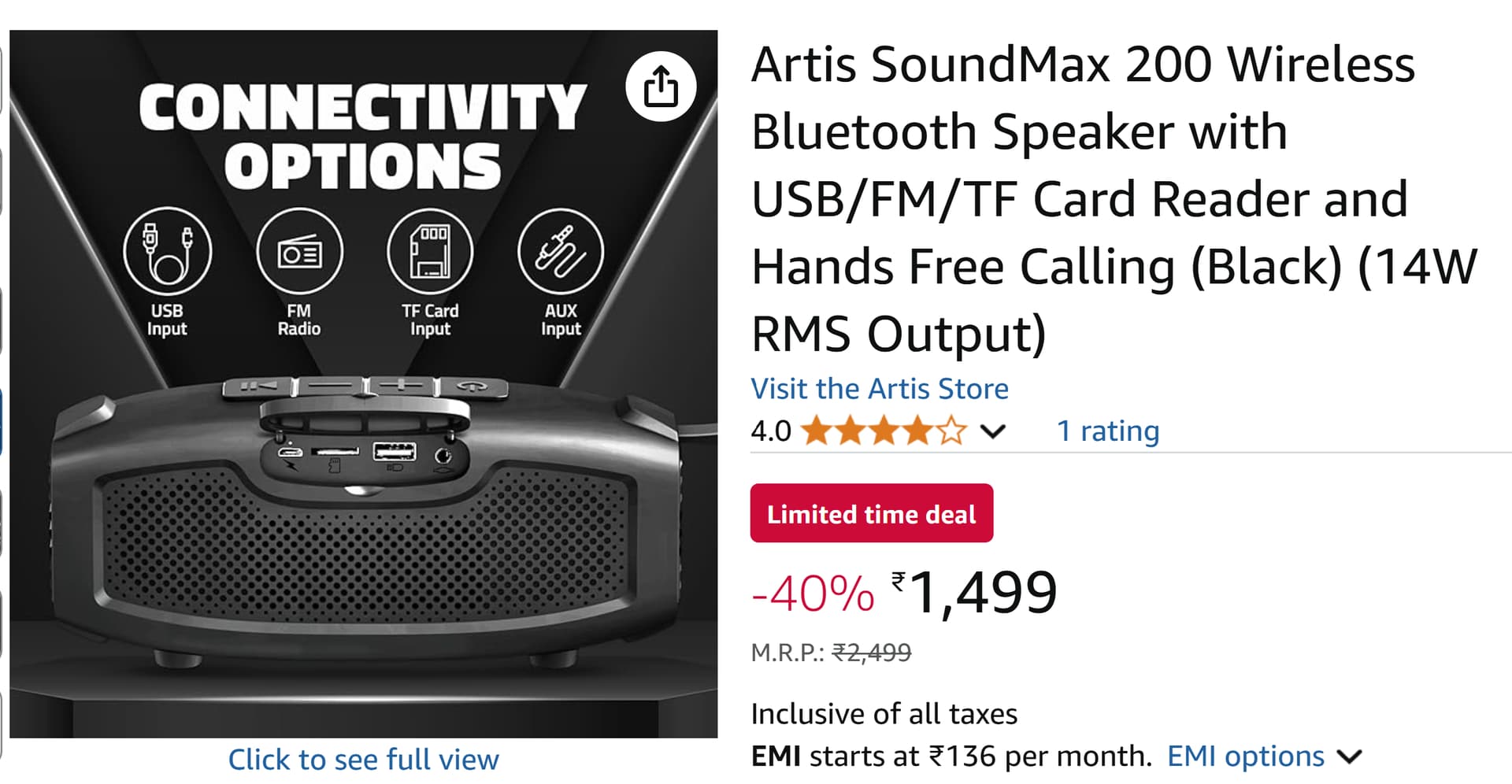

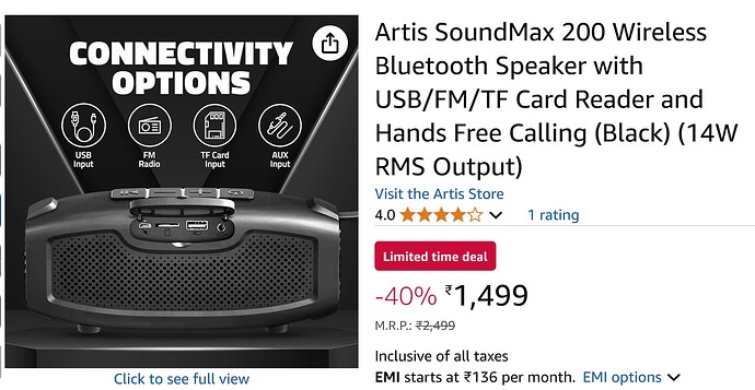

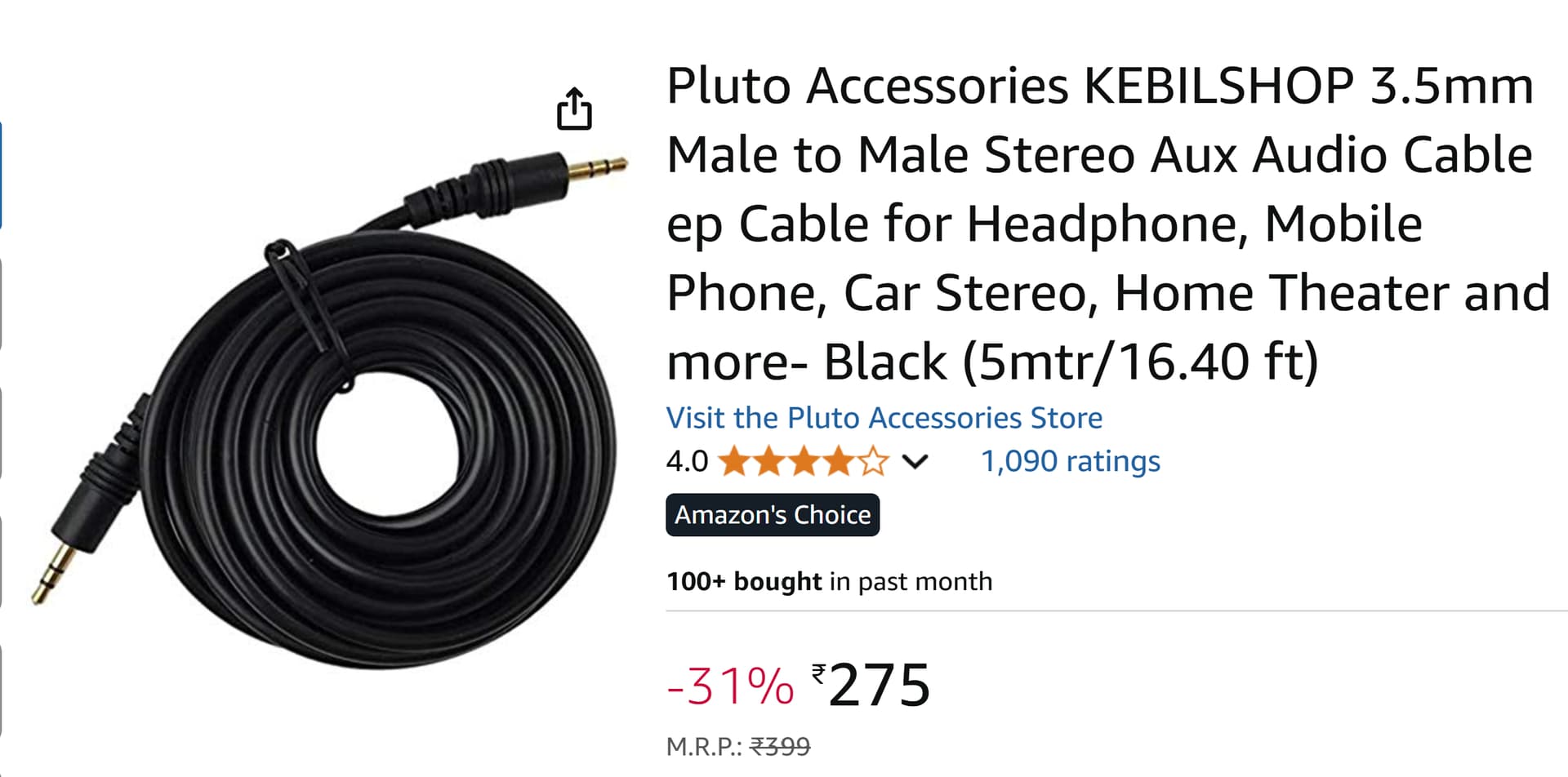

If you want a cheap solution you can buy this Artis SoundMax 200. Connect TV Audio Out to Aux input of this Speaker using long cable, (just have to put up with the hassle of unplugging the cable when not required, some TV’s automatically switch to Aux when they detect a cable plugged in (you can test this by plugging in just the cable without the speaker).
Cost you less than 2000 rs. Added benefit you can also use speaker via Bluetooth using your Phone.
You can check this and some other videos on the channel.
