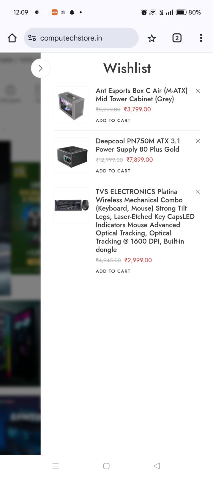

But the next set of parts I want to buy are below. Are they any good? I mean I want to go to Ant eSports Box C Air but Lian Li A3 is costly @₹7k almost but Ant eSports is ₹3.8k Which one is good to go? I only use Air cooler so no need for any AIO support needed either.
Then about PSU is this one good or should I go with any other? Please suggest. Thanks.I I

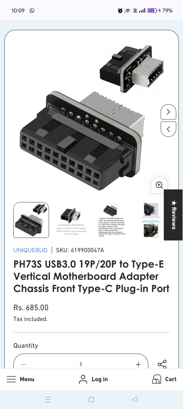

I intend to use the above converter to connect to the front USB port connector on the motherboard as the mobo I bought now does not have a USB Type C on its mobo but want to use USB 3.0 port of the motherboard since this mobo comes with 2x USB3.0 ports on the mobo.
Is the website trustable? It’s in Mumbai I think. Can I order from it?

Don’t know in case (pun?) of cabinets, I personally use ant esports mesh mid tower myself but SFF cabinets are different thing. I’d say check an unboxing/review for yours on youtube if there is any. Most important thing would be clearance which you probably must have checked already.
It’s rated tier B on PSU tier list ([check it for yourself](’
https://docs.google.com/spreadsheets/d/1akCHL7Vhzk_EhrpIGkz8zTEvYfLDcaSpZRB6Xt6JWkc/edit?gid=1973454078#gid=1973454078https://docs.google.com/spreadsheets/d/1akCHL7Vhzk_EhrpIGkz8zTEvYfLDcaSpZRB6Xt6JWkc/edit?gid=1973454078#gid=1973454078
), scroll right and read notes as well) which is alright. Same as MSI MAG A850GL and Thermaltake Toughpower GF A3 Gold 850W.

What about Logitech Pebble 2 Combo? This combo has many multimedia shortcut keys and TVS does not have. I just need it for gaming and browsing. Does this combo work good in gaming? Will there be any lag or anything?
Looking at the keyboard’s Rting’s review its rated badly for gaming and that’s expected because it’s a chiclet keyboard, the worst type to game on in my opinion.
[Here](’

As for the mouse I don’t even have to check its specs to know it’s bad for gaming. No mouse in a keyboard+mouse combo has ever been good for gaming, let alone a wireless one.
For general use like media they are both good (wireless + price + lightweight + reliable product).
Just get deathadder essential + keyboard of your liking and if you don’t like them in the end sell them back here. People dig buying affordable stuff from reputable brands.
