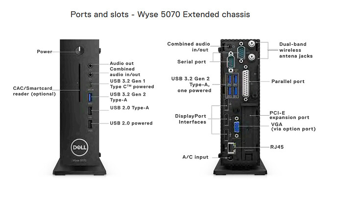

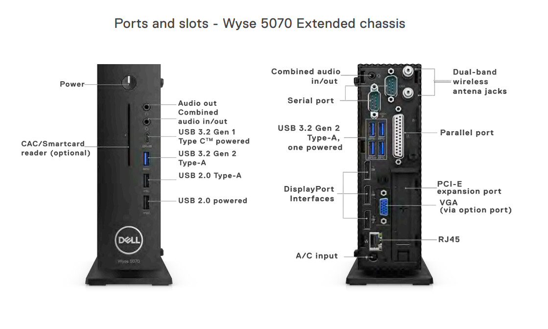

Recently i came accross dell wyse 5070, which is a proper x86 pc with proper bios. So it maybe more straightforward and install openwrt without doing any modifications to the image.. it comes at 6-7k refurbished with 1 year warranty from few sites.. maybe I will go for it instead? It comes with 8gb ram and 128gb m.2 ssd, supposedly have 4-5 watts idle and 10 watts peak..

This is a much better option because of PCIe expansion slot which can be used for proper NIC. The integrated NIC is also seems to be supported by FreeBSD as well. Best of all, it does away with janky USB NIC. PCIe expansion means even a multi-port NIC can be used. Spec says it has inbuilt emmc but I am not sure this can be used to install OS.

Dell wyse 5070 on other hand, have 1 unused slot where i can put a m.2 to 2.5g ethernet in the m.2 wifi slot, i guess its e.key.. there’s a yt video on it, the adaptor is available to buy in india for 2-3k rs. I dont need more than 1gbps port for now. My hdd cant max out the data transfer speed of gigabit lan, and i have no intention to upgrade to 2.5gbps or 10gbps lan for the foreseeable future.
