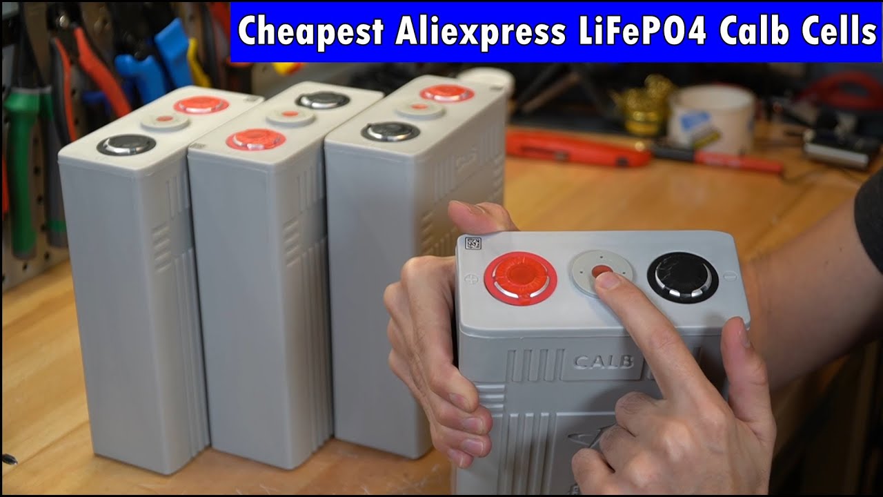

Has anyone got LifePo4 cells recently? How does 4 3v CALB 100AH cells for 21k sound? Good deal?
4 pieces of 3v batteries right, if its new and including gst, then I guess its okay. About 6k more then some unknown brands of same capacity.
If you mean 4.3v batteries then that is not a lifepo4 its a lipo. Not recommend for energy storage.
No Its 3.2 or something. These are CALB batteries. On talking directly he quoted 20k.
A fully built battery with BMS, 100 amp charge discharge, and Ability to be attached with other batteries to make 48v battery costs 26.5k. Made with CALB Lifepo4 cells. Said its rated for 6000 cycles.
He says 2,000 - 5,000 cycles
That video is from 2019
CALB - China Aviation LIthium battery
So is that the 20k price for one single 3.2v cell .
But make sure its new. Since many of these cells are pulled out from a larger battery pack and resold.(like from a ev or from a hospital battery pack which have a predetermined period of mandatory battery replacement irrespective of the life.)
Calb also has different chemistry with different cycle life. So ask him for picture of the battery and then look.up the corresponding data sheet.
No its a set of 4 totaling to 12V 100ah.
Yes its new as per him.
Is there any particular sticker with these details?
I would ask for pictures first. Since even in alibaba and alixpress, calb batteries are more expensive then the price quoted by that dealer.
I think its not a calb make but a calb style battery from some other make.
Also if its really a calb ask for pictures and then check whether the sticker present in them is yellow(chinese market only) or white(international version) or red(rejects/return).
