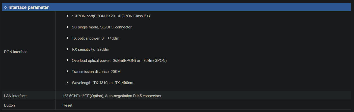

So for any folks using this or planning to set this up keep a watch over Rx snstivity of - 27dBm
as its finicky in working near this range when compared to G3-V2.

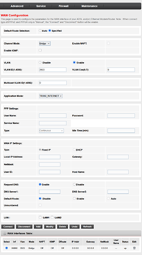

As per @Dushie and another user , i found Port Binding option in WAN > other option
So on latest Brazil firmware which is exact same as latest Indian frmware

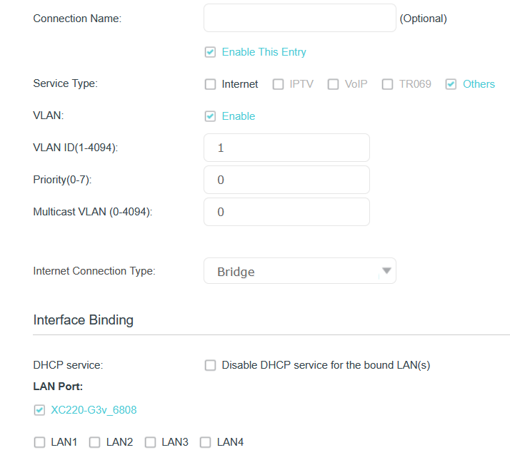

@kuduku is th mac cloning feature working on VSOL ? Were u able to get the setup working with VSOL and ubiquity?
I am confused. You are claiming to do this on Ubiquiti but giving here screenshots from TP-Link UI. What is it actually?

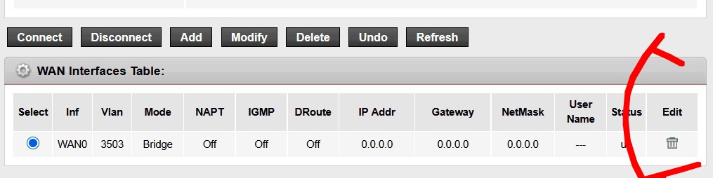

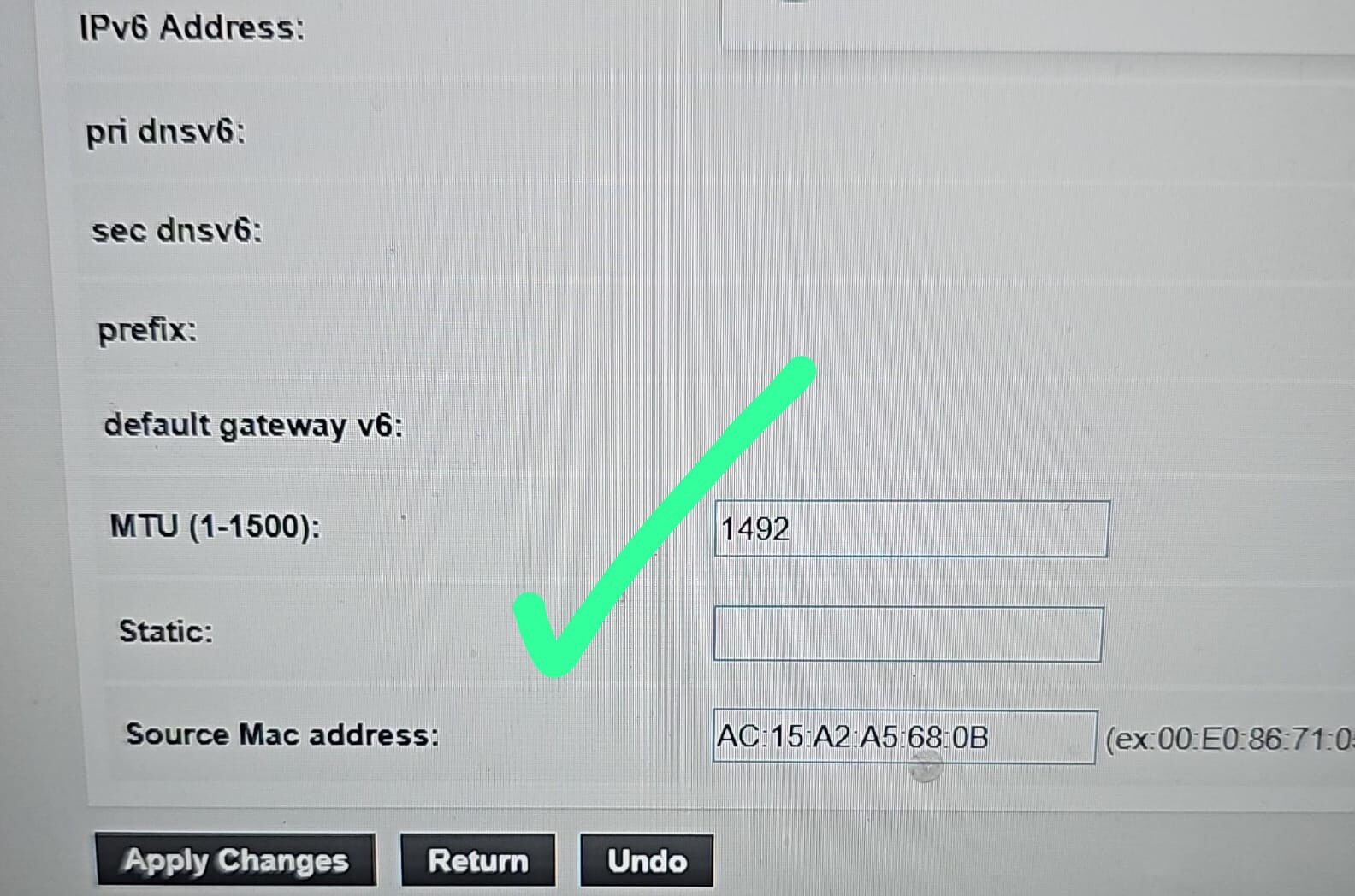

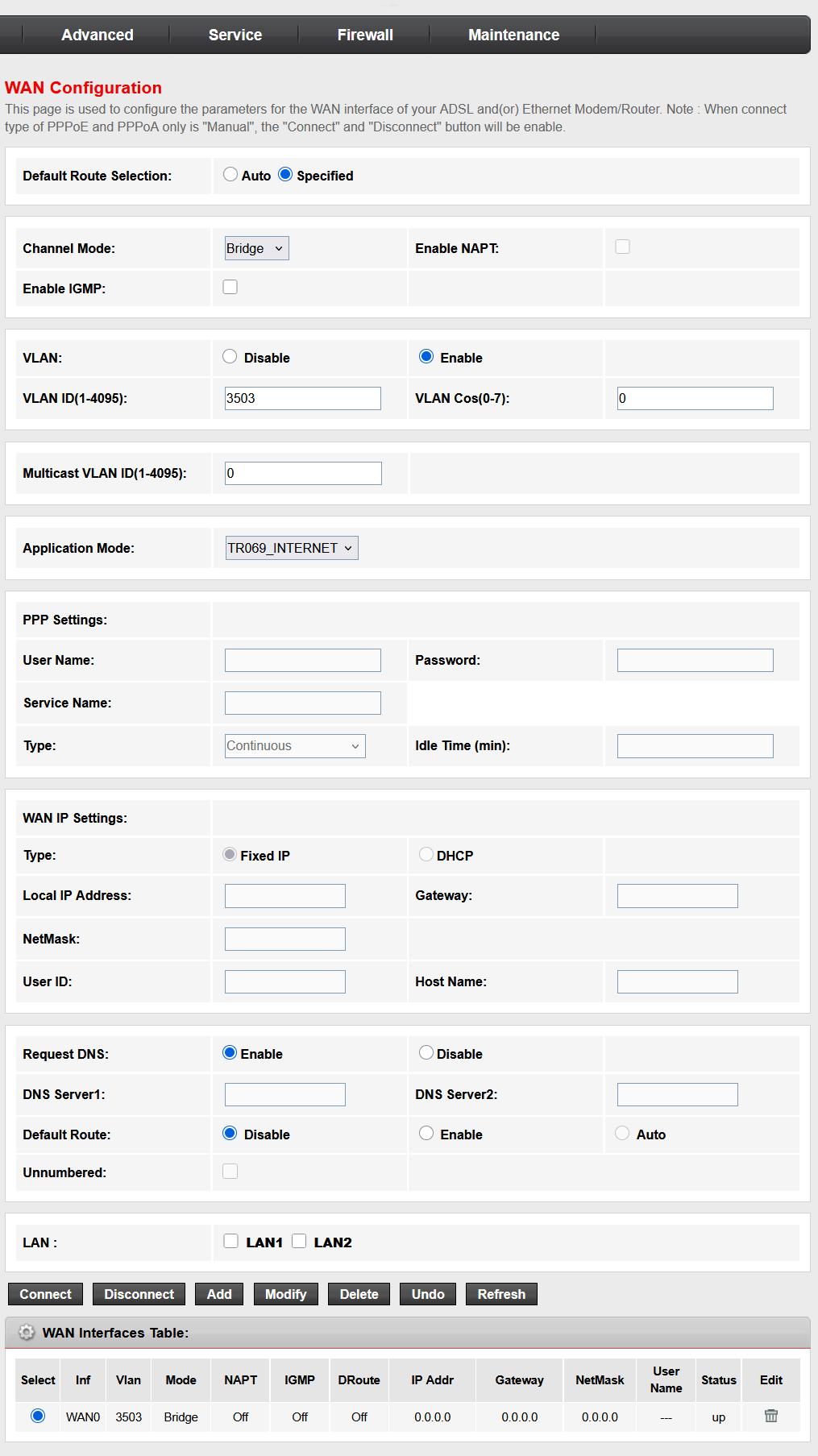

But VSOL GUI has it
MAC clone feature , Its not working that’s all
Just click edit button of your bridge WAN , shows MAC Clone & Static IP settings
I think MAC clone is only shown if VSOL is in EPON mode.
Yes I am on EPON
But click edit on bottom right of your screenshot
Come on man. Are you trolling ?
My bad, EPON has an edit button here , will send pics
