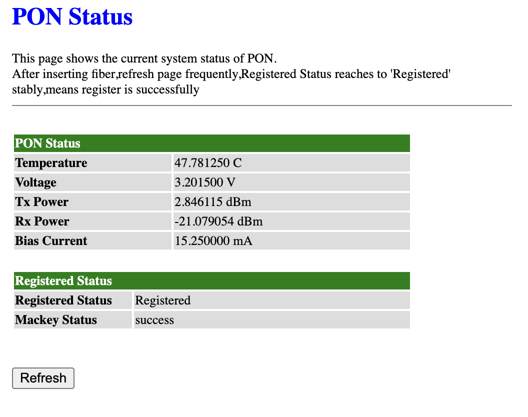

I think I will explain more about what I have tried
LOID & Password - empty
PLOAM Format - ASCII
PLOAM Password - 1234567890 (default and it was the same in the BSNL ONT’s config file
GPON SN: GPONXXXXXX copied from the BSNL ONT’s Status Page
Vendor ID: GPON
Software Version 1&2: 3.1.02-230227 (copied from BSNL ONT)
OMCC Version 0x80 (default)
Product Class: UW-301VPW
HW Version: v5.0 (copied from BSNL ONT)
OUI: first six chracter of MAC
Device Serial Number: UWXXXXXXXX Copied from Sticker on ONT
MAC: Copied from Device Sticker
MACKEY: Generated from the link in this thread
The WAN Mac I am using in the OpnSense PPPoE interface

@haideralipunjabi Just so that I understand the current state, is the SFP ONT showing O5 GPON state? And when you say its not working, are you referring to the PPPoE connection not being established?
It’s in EPON mode and not GPON. I confirmed in the Uniway router - it was also working as an EPON.
The PON status does show as registered.
Also, like pauljacob suggested, I tried tagging it in my router (opnsense) and it isn’t working either.
