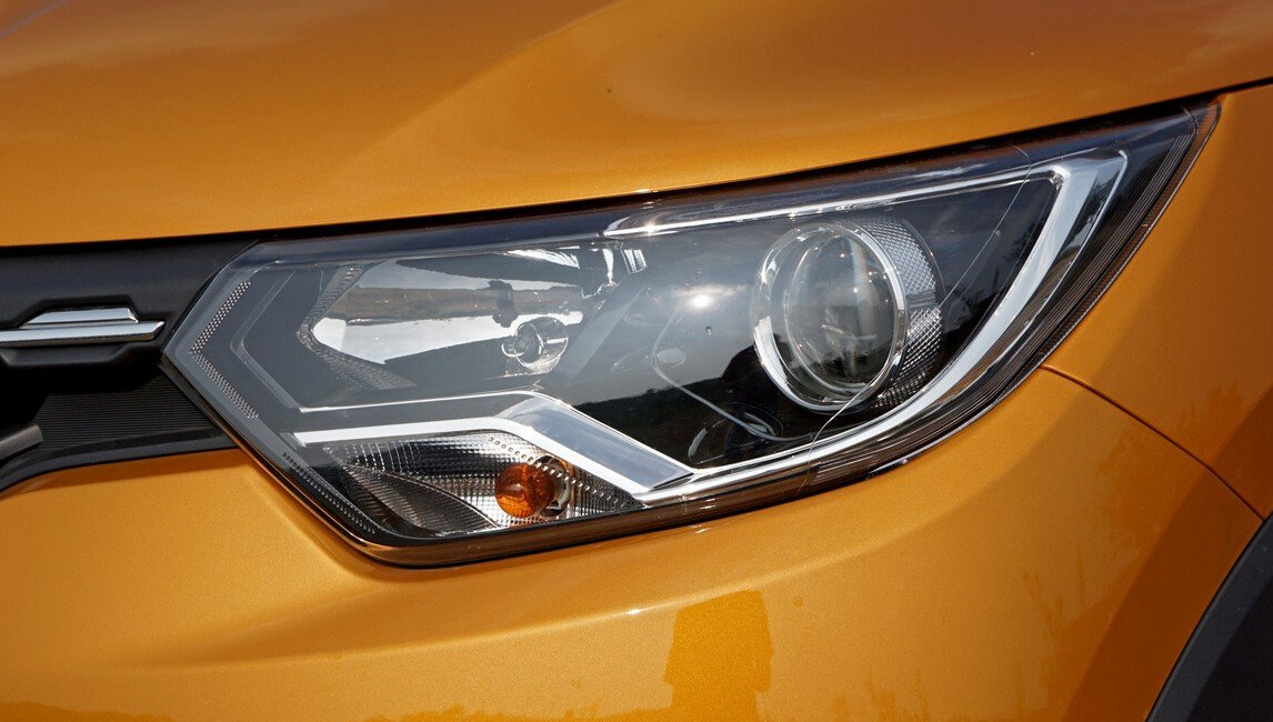

Need to Upgrade Car Headlights, looking for suggestions
Hey guys, My triber has really poor headlights both LB and HB but HB is still ok for the occasional night driving, for everyday driving LB on this car is a very bad.
I decided on going with LED for the longer life and the simple plug and play installation.
After researching a lot many shops in my area dont sell brands like Osram, Philips, Bosch ones and almost every shop has some kind of unique brand which they claim are the best in the market. They also state that its a pain in the a-- to claim warranty with brands like
Osram, Philips, Bosch, is that true.
I need suggestions for H7 type LED lights that are 50 watts and also please suggest websites that are reliable and brands that are the best.
And lastly I am confused about the color temperature, I personally hate the pure white look of the lights these days.

Which year model? Are the default headlight halogen? Do you know their wattage?

Mine is a 2022 model with 55 watt halogens
The default ones are rated 55 watt so are you saying I could go for the same wattage in led or even lower like 25 watts

The low beam is a projector setup right? So LED bulbs should work well in them without much light scattering.

Under your dashboard, you have the headlight leveler knob, adjust it to the maximum so the throw goes in the up direction.
In earlier models of triber this is a common problem.
After doing that, there is a screw adjustment on each headlight under the bonnet, which allows further height adjustment.
The best way to adjust it is at night, parking up against the wall, so can adjust and match the throw of each headlamp.
Check youtube there are many videos.
Mostly likely your issue will be fixed. If not and you want to buy original good quality stuff from OSRAM, Philips, Bosch.
Boodmo can be a option. H7 type is your low beam and H1 is your high beam, both are 55W.
Choose from here
Yeah I tried the headlight adjustment but the light output is the problem. There isn’t enough throw.
