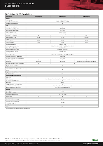

Is PC Kumar a reliable website? I’ve narrowed down this online UPS for a corsair HX1500i based system. Don’t care much about the battery capacity as I have a 3kVA inverter as supplement (but > 30ms switching time).
Datasheet :

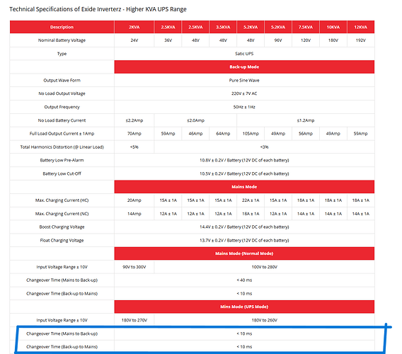

Replace the inverter? I know high-output Luminous ones have high switchover time but Exide ones have 10ms (a friend bought a 2300-2500VA or so inverter for PC + home appliances).

About 1600W at the plug. I just need something that can handle the load till the inverter kicks in. No more than 50ms in worst case scenarios. Which is why I’m not too bothered about the battery capacity, as long as it can sustain peak discharge current. Currently the system just restarts during power cuts.
I’ve tried, but they don’t mention switching time on data sheets. It’s a huge gamble as you can’t return those after purchase.

Actually they do and its indeed <10 ms in ups mode.
Thanks for digging through the sheets. The switchover time in backup mode is still 40ms.
The issue with keeping it in UPS mode is it’ll constantly switch to battery mode even if there is electricity, thanks to the fluctuating voltage in my area. This just drains battery unnecessarily and may result in no backup when a real outage occurs. Which is also another reason I’d want to keep the backup and UPS separate.
