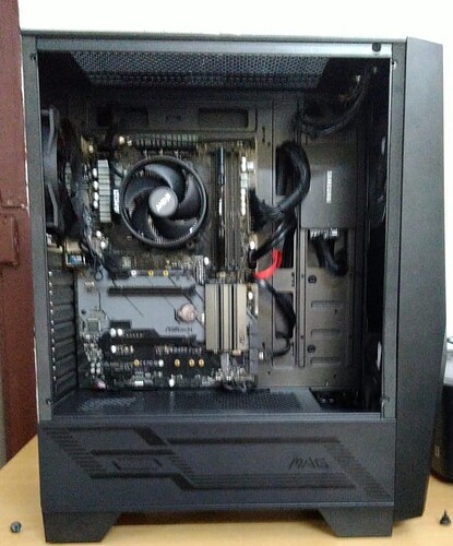

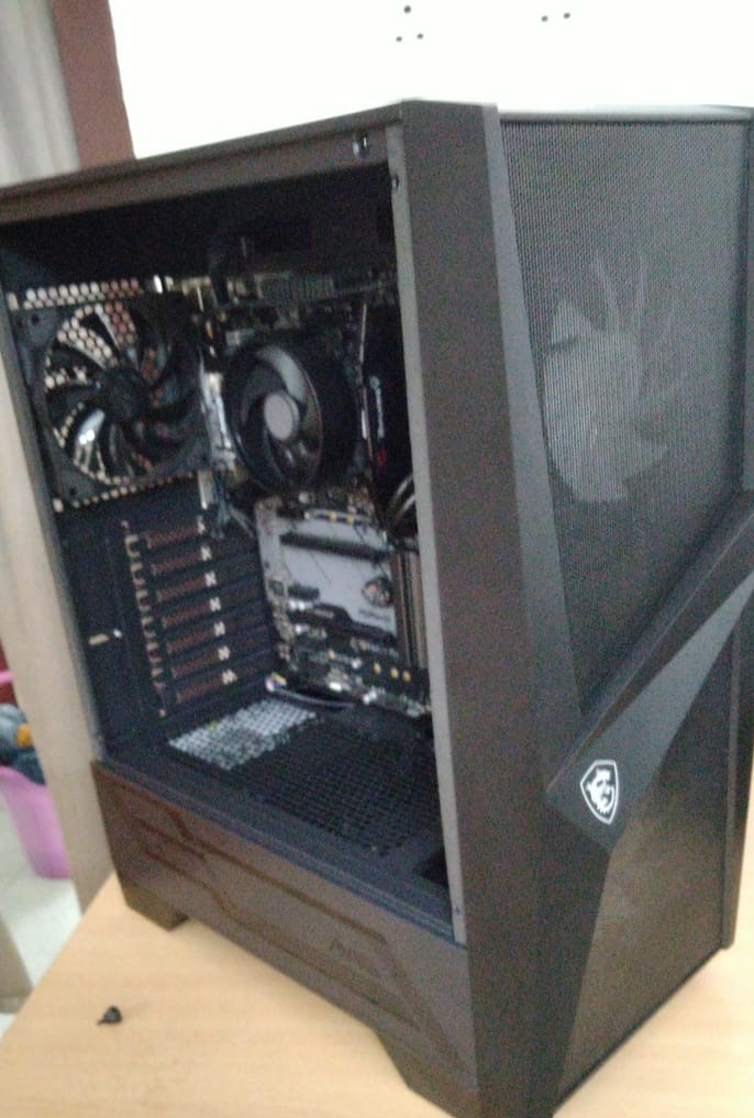

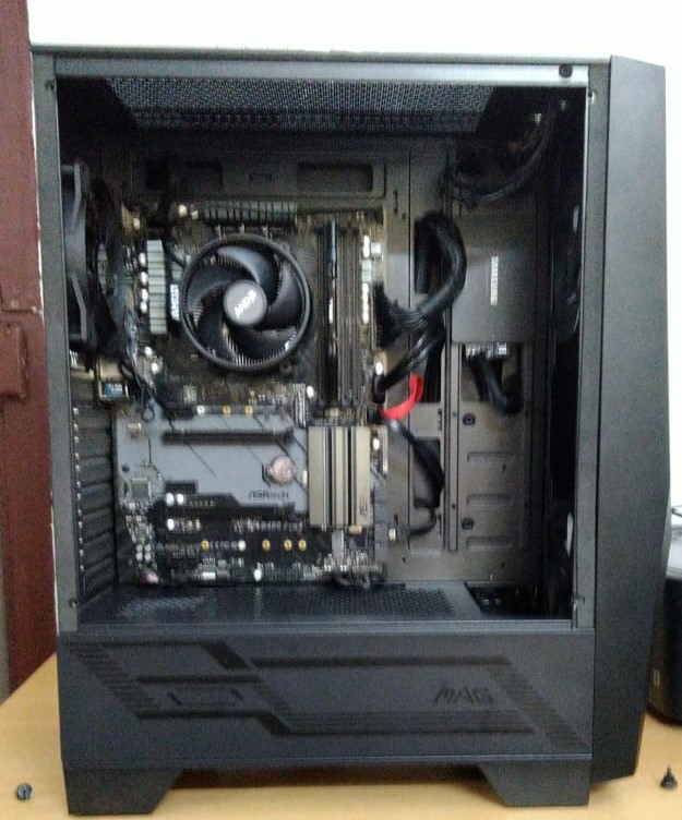

Guys All the components arrived yesterday. Assembled and installed windows and basic drivers today. The only niggle was that the CX550 came with square pin cable and I tried it using an adapter. The system didn’t switch on. Although it made me worried for a moment, once I switched to one I had everything works fine. The system feels snappy compared to my sandybridge based dell laptop.
