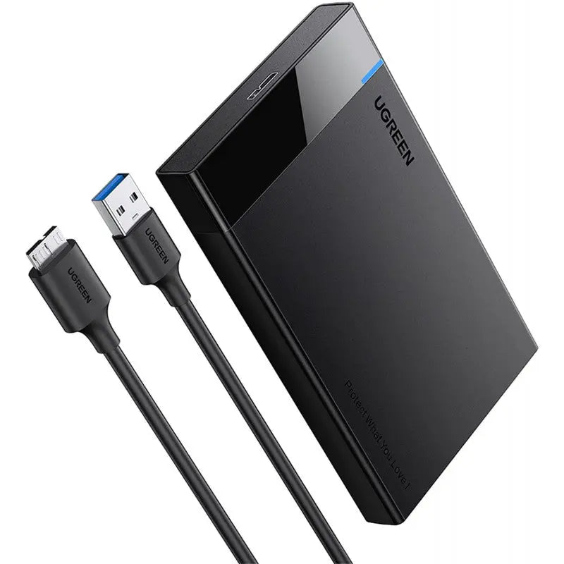

It’s better than ugreen?
Ugreen is better & also minimum double price of pibox
Ugreen uses the updated Jmicron (China) controller JMS578 (much better than older JM chipsets) still I won’t say it’s better than Realtek (taiwan). But Ugreen has better build and shell and that’s where your money goes.
In terms of tech no it’s not better but Ugreen justifies it’s price in the build quality department.

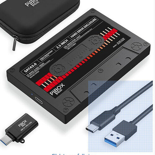

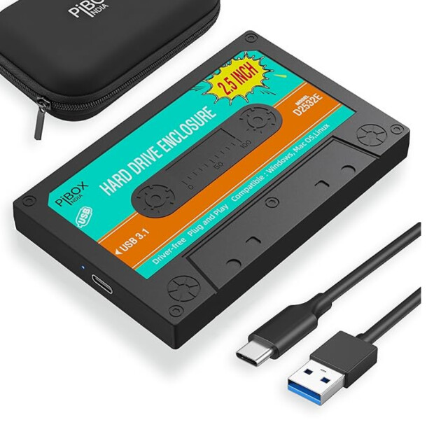

However, for the price of 1 Ugreen you can get 2-3 Pibox so up to you. Also Pibox has launched some good loking retro sata enclosure (same chipset just different shell), it looks like an old cassette just ordered two of them, sold out on amazon (was 400 on black friday) but still available on pibox website.
