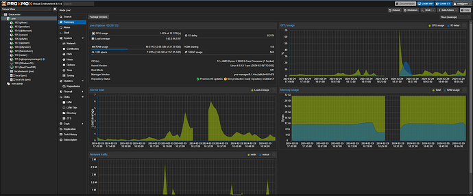

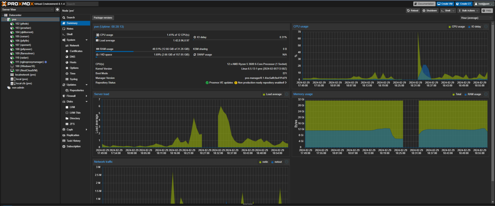

Mostly finished setting up my first homelab server as a linux noob. An old 256 gb ssd I had lying around is used for proxmox/LXCs/VMs. So far it seems more than enough. I use NFS on the proxmox host to share a 1tb hdd, which will work as a temporary media storage until I upgrade it. I tried to set up OMV but this was way easier. Since my ISP has a CG-NAT, I’m using nginx on an oracle cloud instance (free) to forward ports. Nextcloud won’t work without it. Then I have mullvad set up on the openwrt LXC to route all my torrent traffic through it. Not sure what else I want to do with it.
