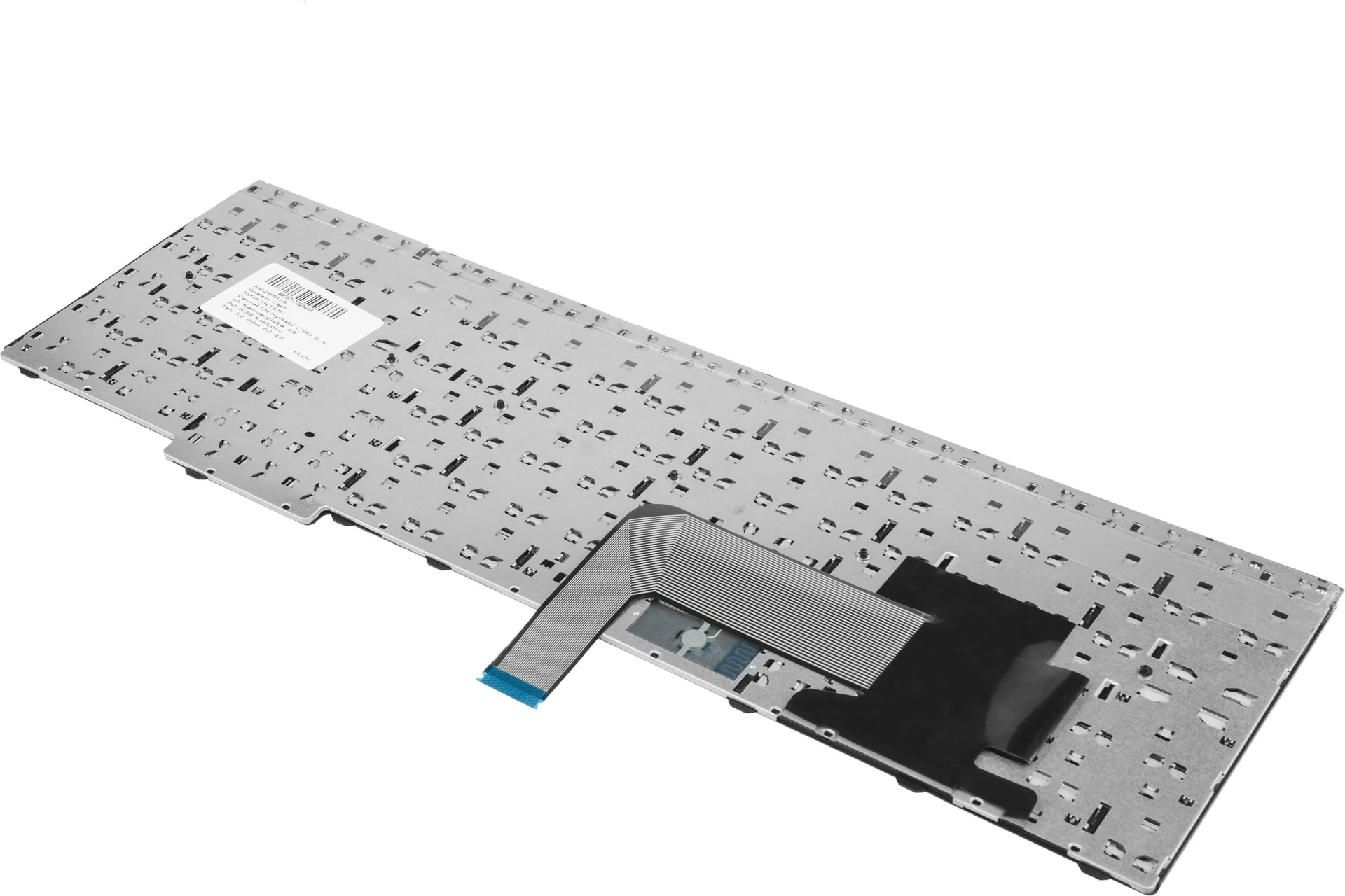

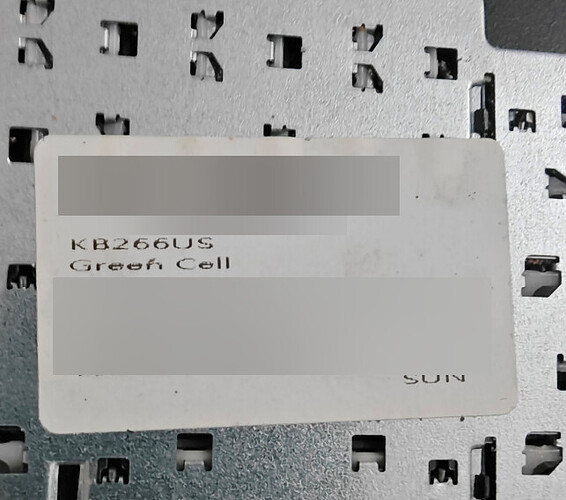

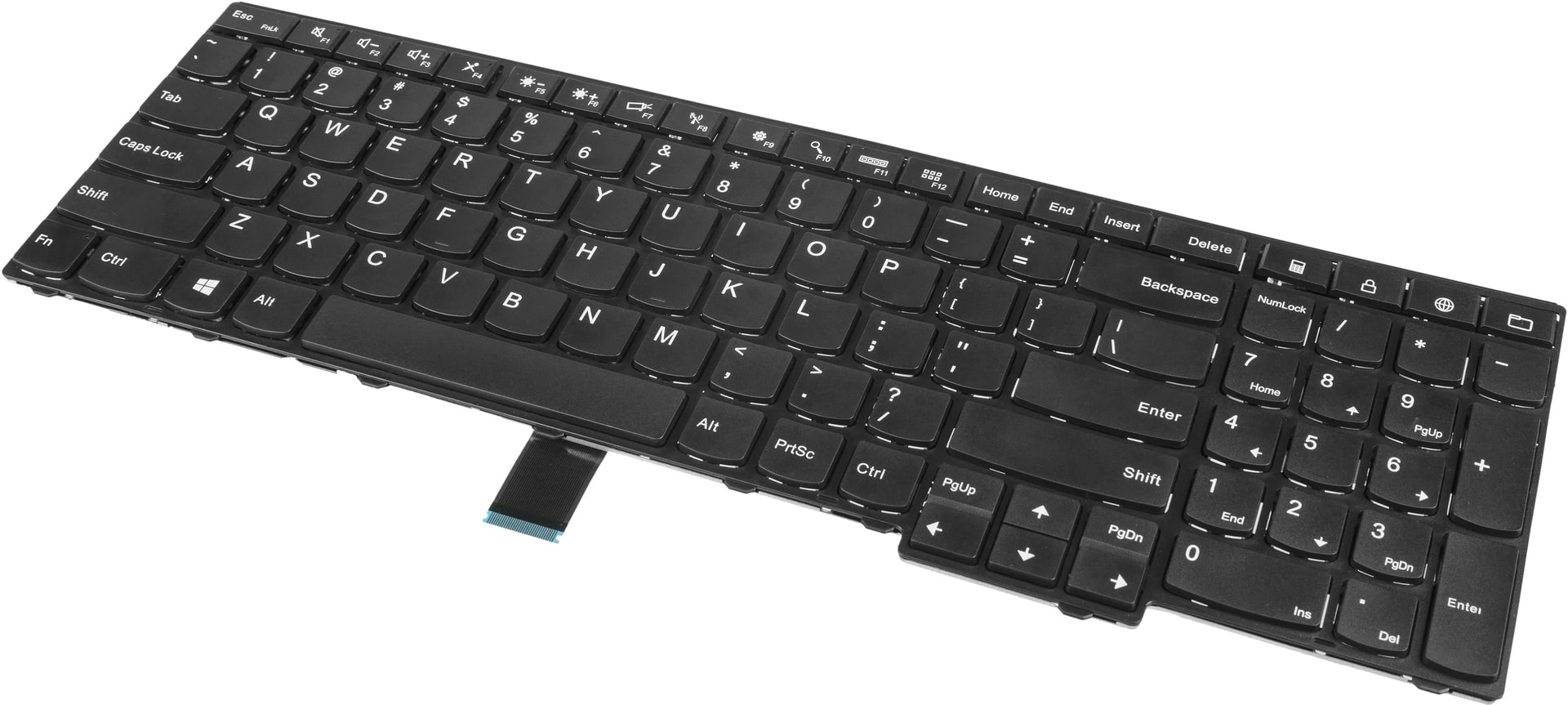

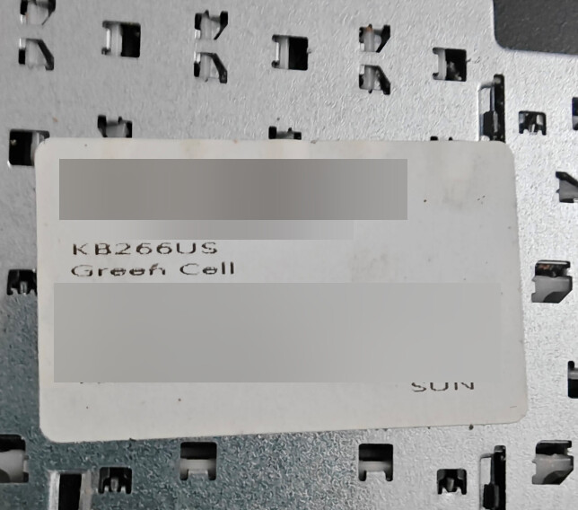

I checked online for the model but its on some polish site but out of stock everywhere
image from reference website
If you guys know a good way to repair this, let me know, I dont think the ribbon cable is damaged as nothing physical happened to it. I checked the cable and its fine.
Is there some place in India where I can find this?
