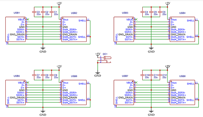

?? As per my understanding, USB3 and above require 9 pins, including the vbus. With 4 pins you can only do up to usb2, 480 megabits/sec
OP has Pi 3b+, which doesn’t have USB3 ports.
That said, if anyone was building a custom board like this, it would be nice to have some future proofing since USB3 is anyway backwards compatible.
Ah, in that case this board won’t cause any further bottleneck. But, to reiterate, what @@Heisen has developed is a USB2 power injector, and won’t do anything over USB2.

Yes, you are correct that USB3 has 9 pins, I had a brain fart there. My apologies.
Yet, time make it usb3.
As I read the USB3, USB3.1 and USB3.2 use the same 9 pin connection, so if usb3 connector is used, it will be forward compatible as well.

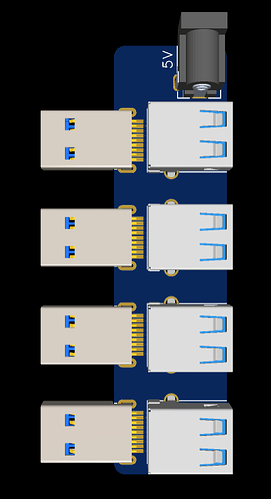

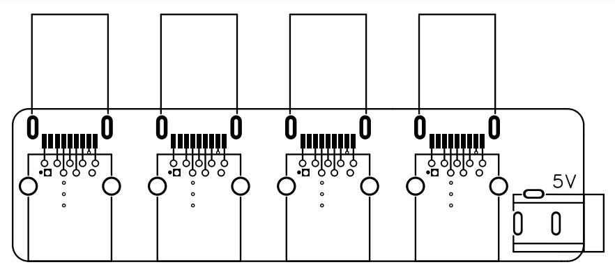

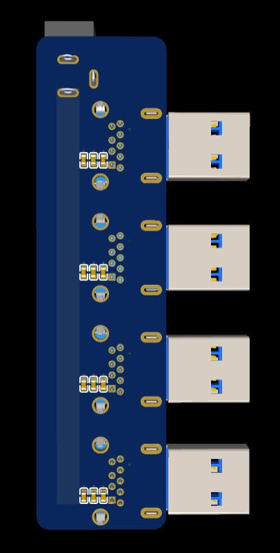

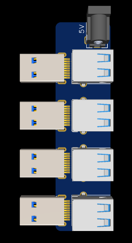

USB3
Awesome. Thank you. Any chance of a usb female connector for power delivery?
Micro USB or Mini USB-b
Usb C?
Placing the connector is easy, but getting 4 amps from it will not be easy, it requires many more active components. With just the type C connector only 3Amps can be sourced.
I think that will be fine.
Okay will do, it will be able to provide 15watt of power, spread across 4 USB ports.
We are half way there in developing this niche product, now it has got my full interest, I will order the PCBs and slap on those components, when I get free time. I might be able to send you one in the future, but don’t quote me on that. :wink:
