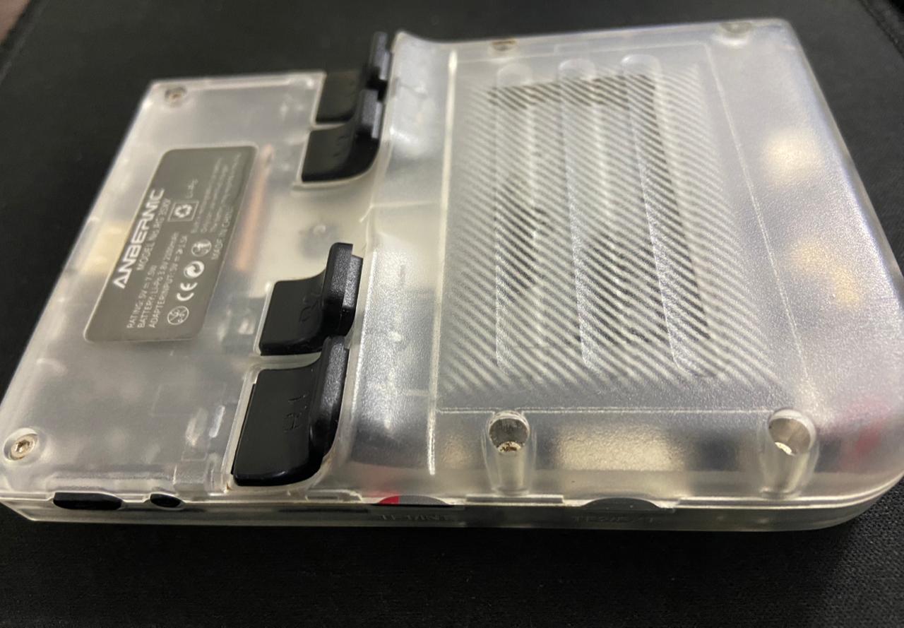

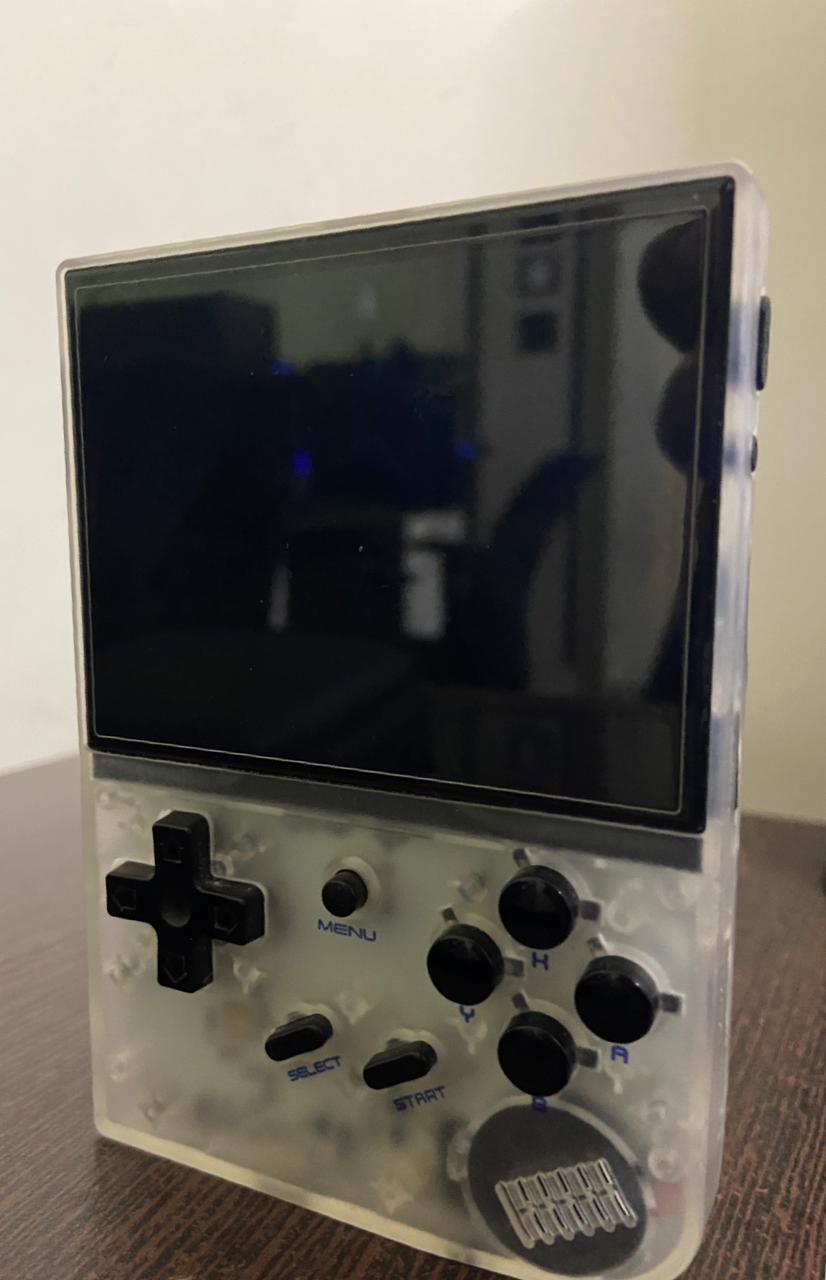

Its a First batch RG35XX back from Nov 2022.
Works Fine, and I’ve used it sparingly so battery life isn’t really a concern. But i’ve come to know that the later versions have a bigger battery like 2800 mAh that’s better than the 2100 mAh cell inside this. (Trivia - currently using MinUI, but have a spare GarlicOS Sd card)
I’d appreciate if someone more experienced can tell me how and where can i purchase a cell that works for this unit preferably a 2800 mAh unit ? (also is 3500 mAh is a possibility ? - https://www.reddit.com/r/RG35XX/comments/10ehy6y/battery_upgrade_for_rg35xx/)

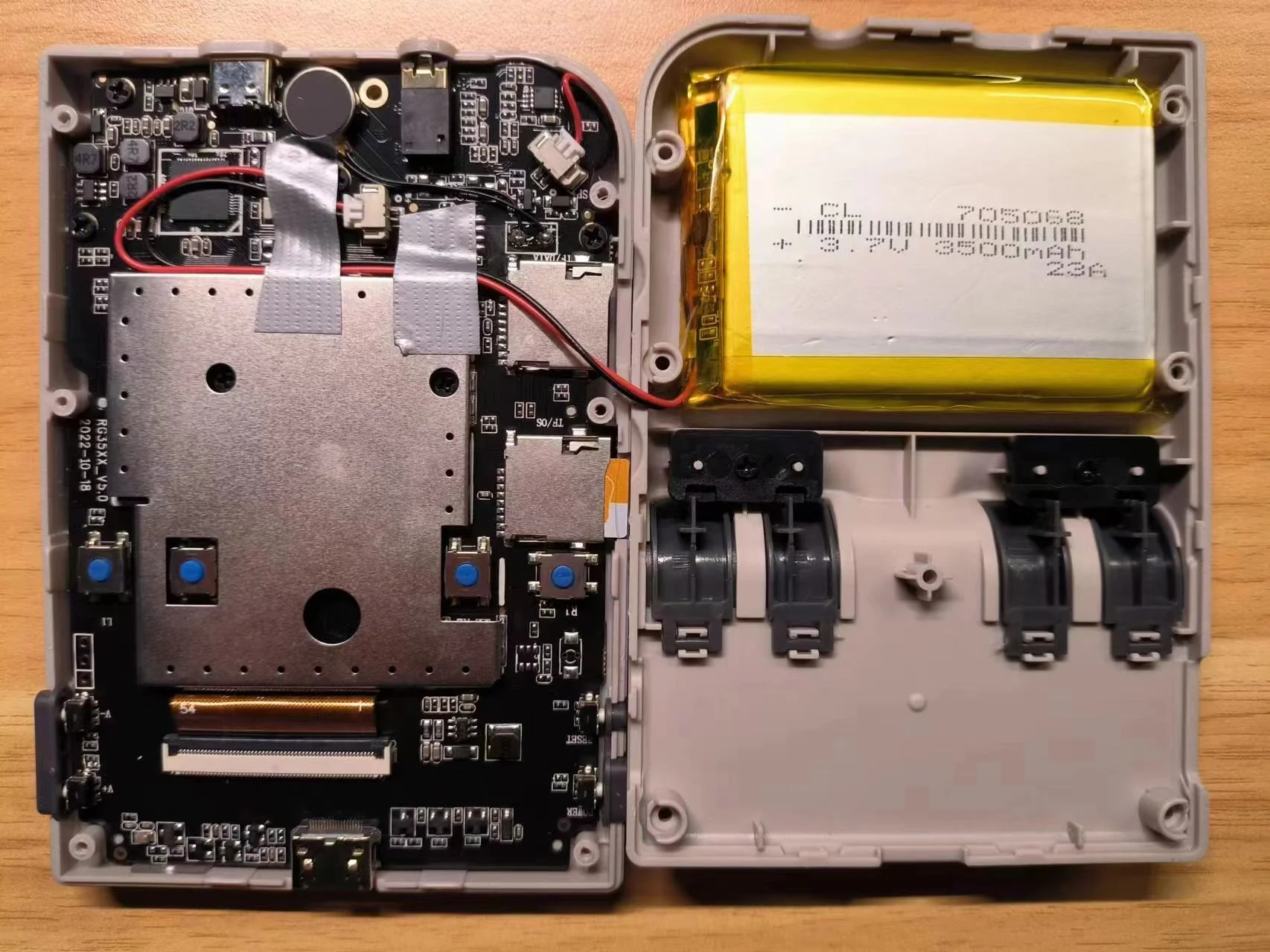

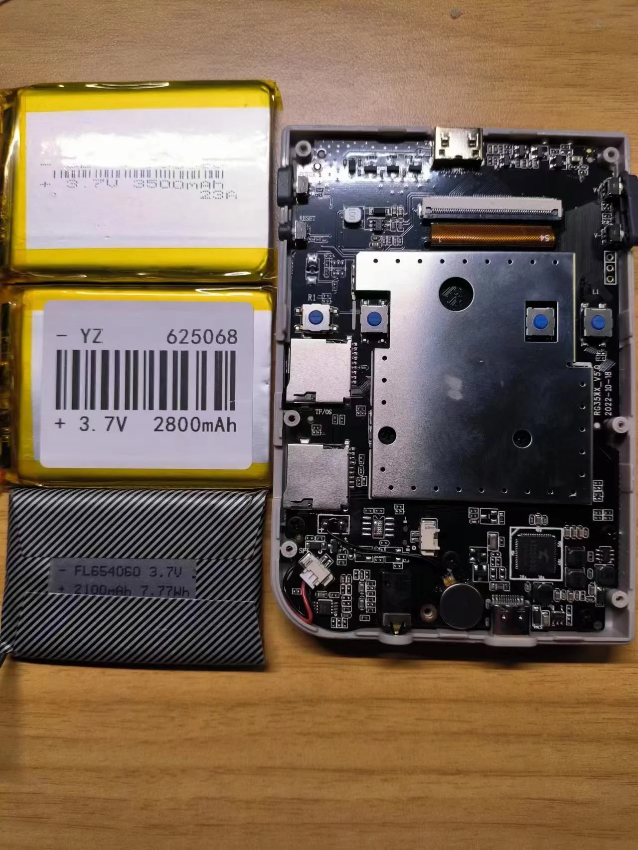

A bit unsure to open it just yet, but these should be compatible battery packs, taken from the reddit thread mentioned in the post

Physical Size, conenctor, voltage must match. Capacity can be a bit more or less. If you go offline it’s much easier to check in person once you get dimensions of og battery.
