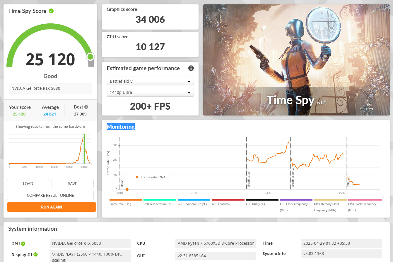

Upgrade to 5700x3d + RTX 5080 done. 2x framerate in Star Wars Outlaws . 3x with 2x Frame Gen.

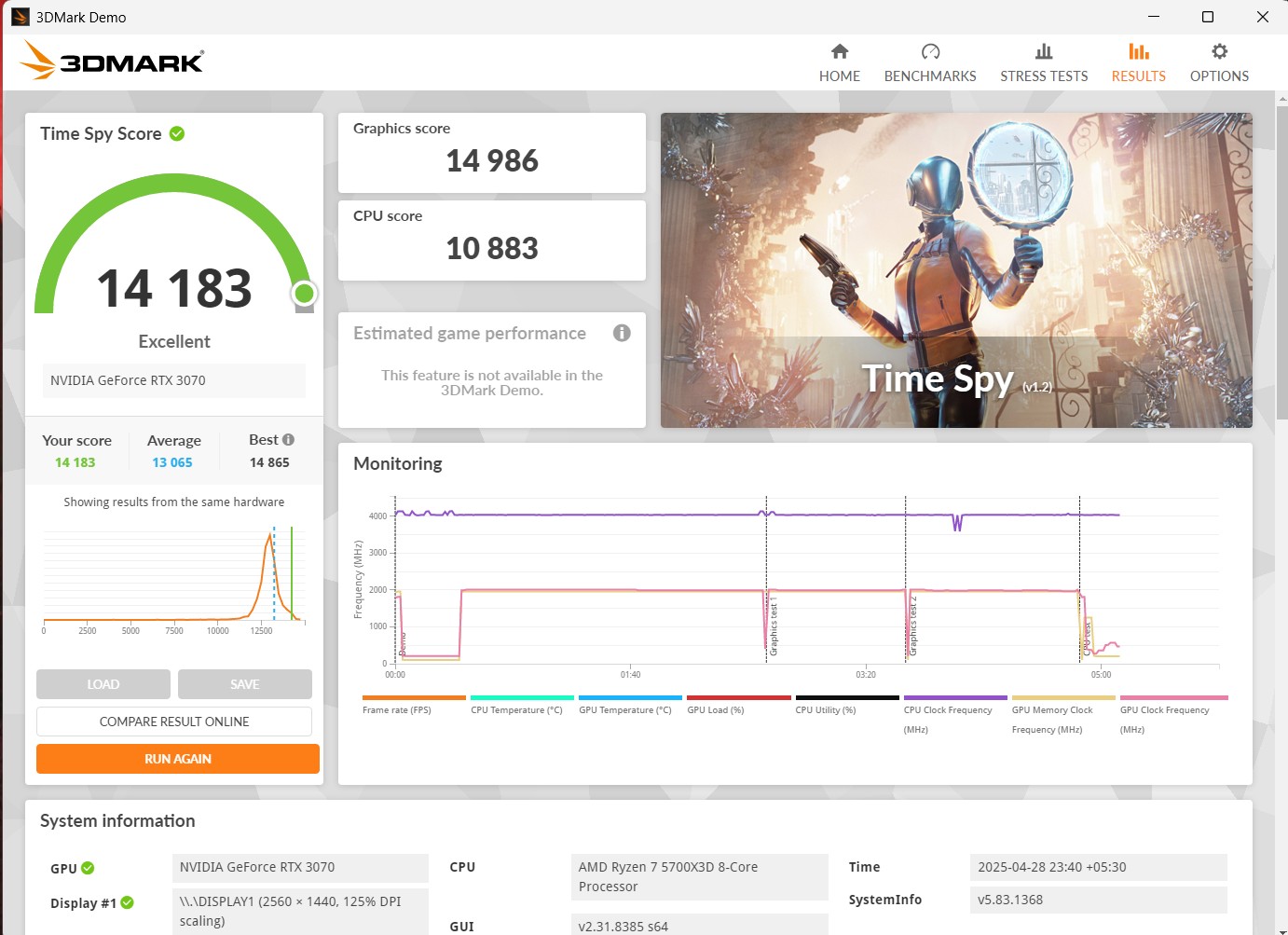

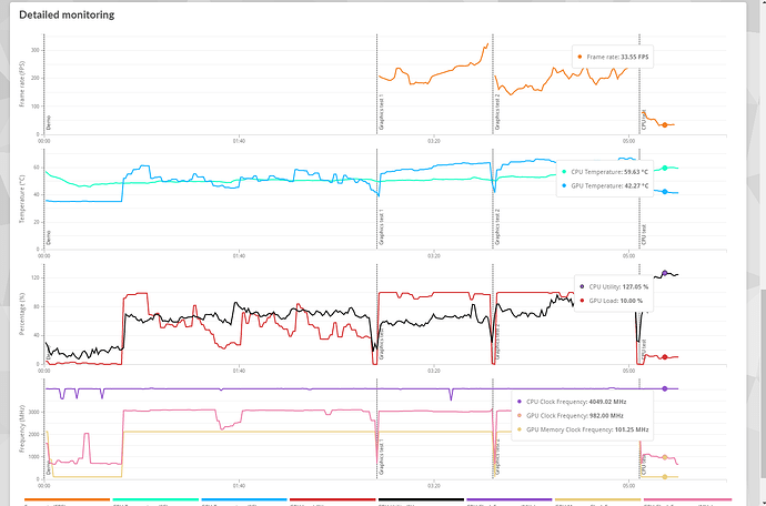

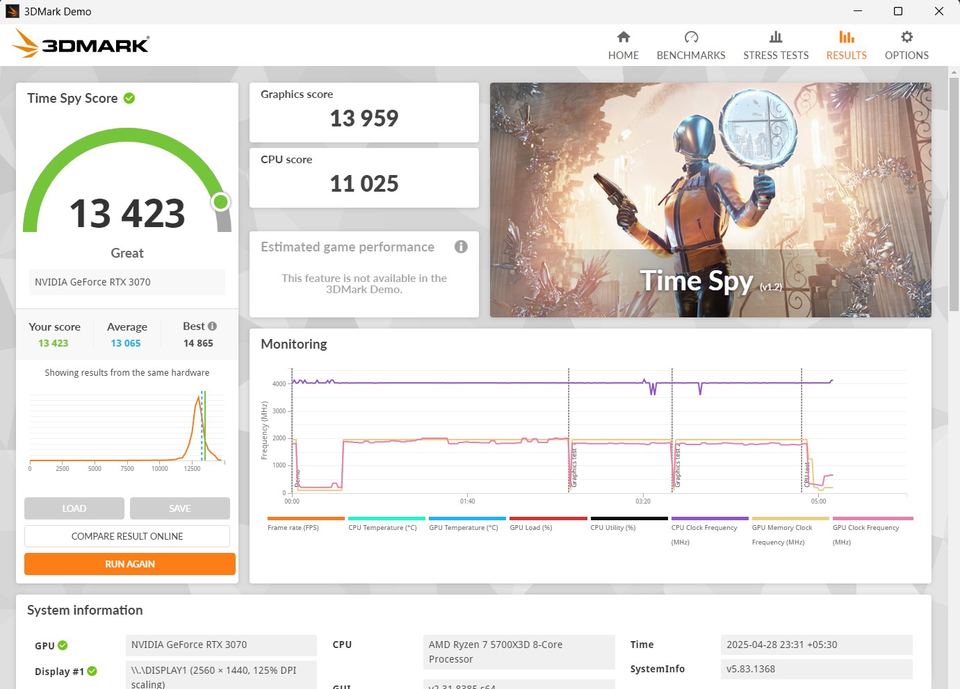

My CPU timespy score is 10173 which is lower than what I saw online. If anyone that has this can confirm their score?
Also undervolted 5700x3d -30 all cores.
RTX 5080 undervolted and overclocked to 3000 Mhz at 20 watts below stock power draw.

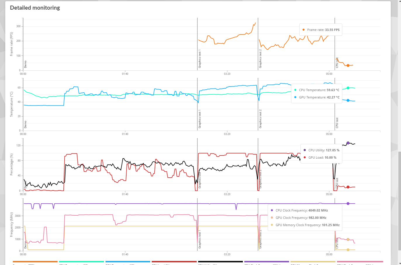

I got 11205 CPU score on first run where GPU was limited to 70% power and 10883 on second run where GPU was at 100% power. Not sure why lower score on second run because average clock frequency stayed the same for both runs (4,039 MHz) although temp was a few degree higher on second run. -30 all core UV.
Your CPU seems to be slightly under performing indeed. Can you check and tell me what was the average clock frequency and temp?
Screenshots attached.
Frequency seems to be locked at 4049 Mhz and the temps were mid 50s with the end spike to around 59C

Why not? Why use “hydra” when you got native undervolt support in bios. Also 5700X3D is very easily able to do -30 all core UV without stretching and/or crashing. AMD really crippled the Ryzen 5000 X3D chips with locking their max frequency. The amount of headroom and OC potential they have is insane. Using per core undervolt to achieve best single/multi core performance would have been understood if the chip had capability to push further than the locked 4.1ghz. If it’s able to achieve the same frequency (max) on -30 all core without stretching (and/or crashing) then it shouldn’t affect it’s single/multi core performance. From the looks of it his processor’s -30 is working fine if we look at the average clock frequency at 4049mhz (4.1ghz). In fact the single core boost is working fine as well by looking at the bump in the graph which is/should be at 4150mhz.
Of course OP can try hydra or just set undervolt to -20 and see if this improves the benchmark performance since there is a big difference right now.
