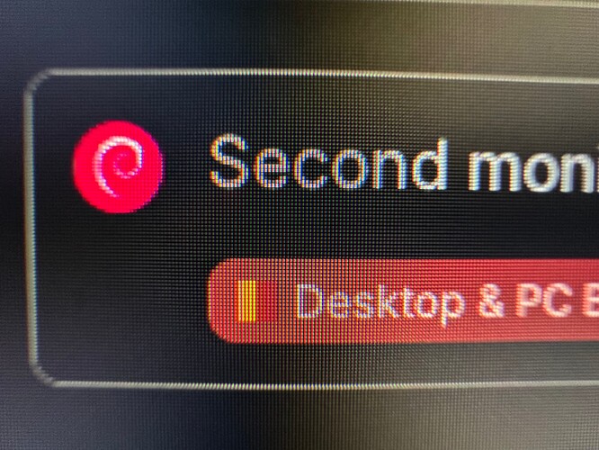

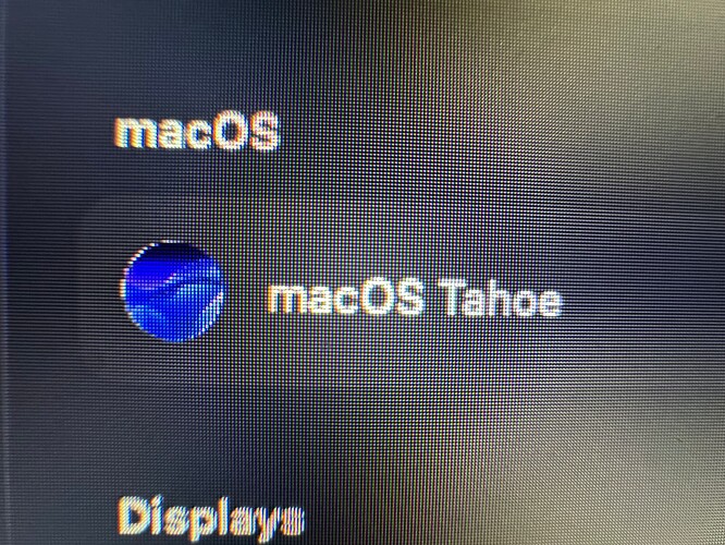

27 inch QHD is actually fine on MacOS Tahoe for me, I work with text all day and it’s perfectly fine for me.
Now while the monitor is 1440P, it can actually accept a 4K signal through HDMI (a feature for PS5 users) too, albeit the refresh rate gets lowered to 60 instead of 144 due limited bandwidth of HDMI 2.0 (which will be the case for most 1440p monitors). To do this you need to choose the “1920x1080 HiDPI”. Basically sends a 4K signal to the monitor and scales everything up 4x. This works better because 1080p is exactly 1/4th of 4K. So it can properly utilize the extra pixels to make up a larger pixel, and any and all blur is mostly eliminated. I’m attaching some samples here.
Native 1440p:
4K signal (1080p HiDPI, the monitor downscales the 4k signal to 1440p to fit on the screen. MacOS thinks of it as 4K and uses it as 1080p, meaning it uses 4 pixels to make up one pixel while rendering the UI):
Keep in mind the scaling makes it so everything is larger in the 4K mode, which gives everything more pixels to work with, since everything is slightly larger, which also adds to the clarity.
The monitor I have is Gigabyte G27Q. Many 1440p gaming monitors will support this 4K thing but it’s not always explicitly mentioned. You can look if rtings has a review for the monitor, they mention the PS5 supported resolutions on there.
