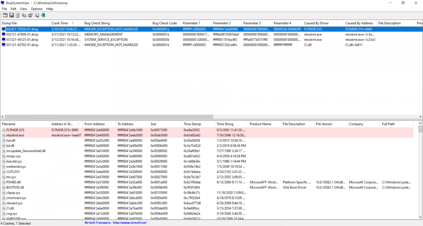

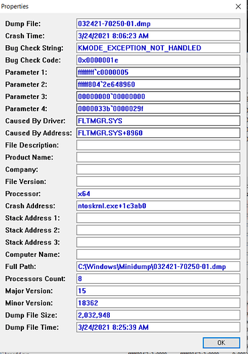

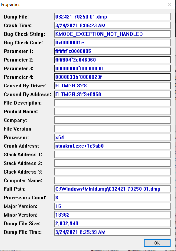

I am getting following BSOD anyone help.
How to get these details from minidump files?

from options/select save the report as text

thanks got it.

If everything fails try doing a repair of the OS or a clean install on the system. Before doing that please go through the articles listed below and see if it solves your issue. These are related to your BSOD causing fltmgr.sys
https://www.thewindowsclub.com/fltmgr-sys-blue-screen-windows
