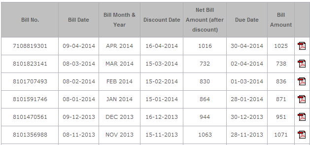

I too had bought a Sharp XP13 LV 1.1T AC on the 22nd of February 2014. I used it for the whole of March 2014 @ 8 hours per day at a setting of 24 degrees. I got my electricity bill today and the increase in the bill is only Rs.175 ( from average of Rs. 850 during December, Jan and Feb to Rs.1025. I was also sceptic on savings on power but was pleasantly surprised when I got the bill. I earlier had a DAikin 3 star AC which conked off last November. With the Daikin AC my bills used to be around Rs. 1750 to RS. 2000 during summer months for the same usage pattern. So this one is a savings from my point of view. Do Inverters really save energy ? I do not know technically but I did experience a drop in the bills from my earlier AC bill usage. In any case, in my opinion the question to be asked is whether Inverters are at least as good as 5 star rated AC’s. If they are, then I am justified in taking an Inverter AC at the same price or slightly lower than a 5 star rated AC ( I paid Rs. 32,000 for this model and all other Inverter AC from reputed brands are at more or less this price or more) .

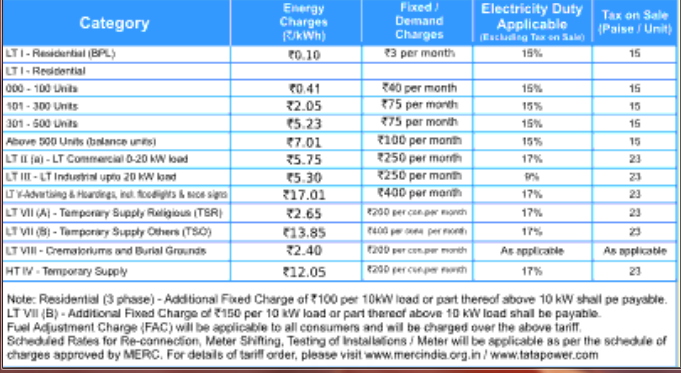

could someone really substantiate these claims with real solid proofs like
  • location/region of usage
  • hours of usage per day
  • electricity slabs/ meter charge per unit
  • other appliance used
  • final bill pic atleast on the months of usage; (atleast 3 consecutives)
most people just quote such outrageous things even never heard of, with any proper evidence, but claims too big a things, just looks like more or less a SHARP bunch of advertisers! I guess its high time to close the thread too!

If you could mention more details like the Daikin 3 star model you are referring to, what your room size is, what temps you set it at vs ambient temps, etc., it would shed more light on why there is such a huge gap.
How interesting that our new member with just one post also had a daikin 3 star.
Why are you comparing a 3 star with your inverter to begin with ? Now if you had a five star daikin or hitachi would there have been such a difference
