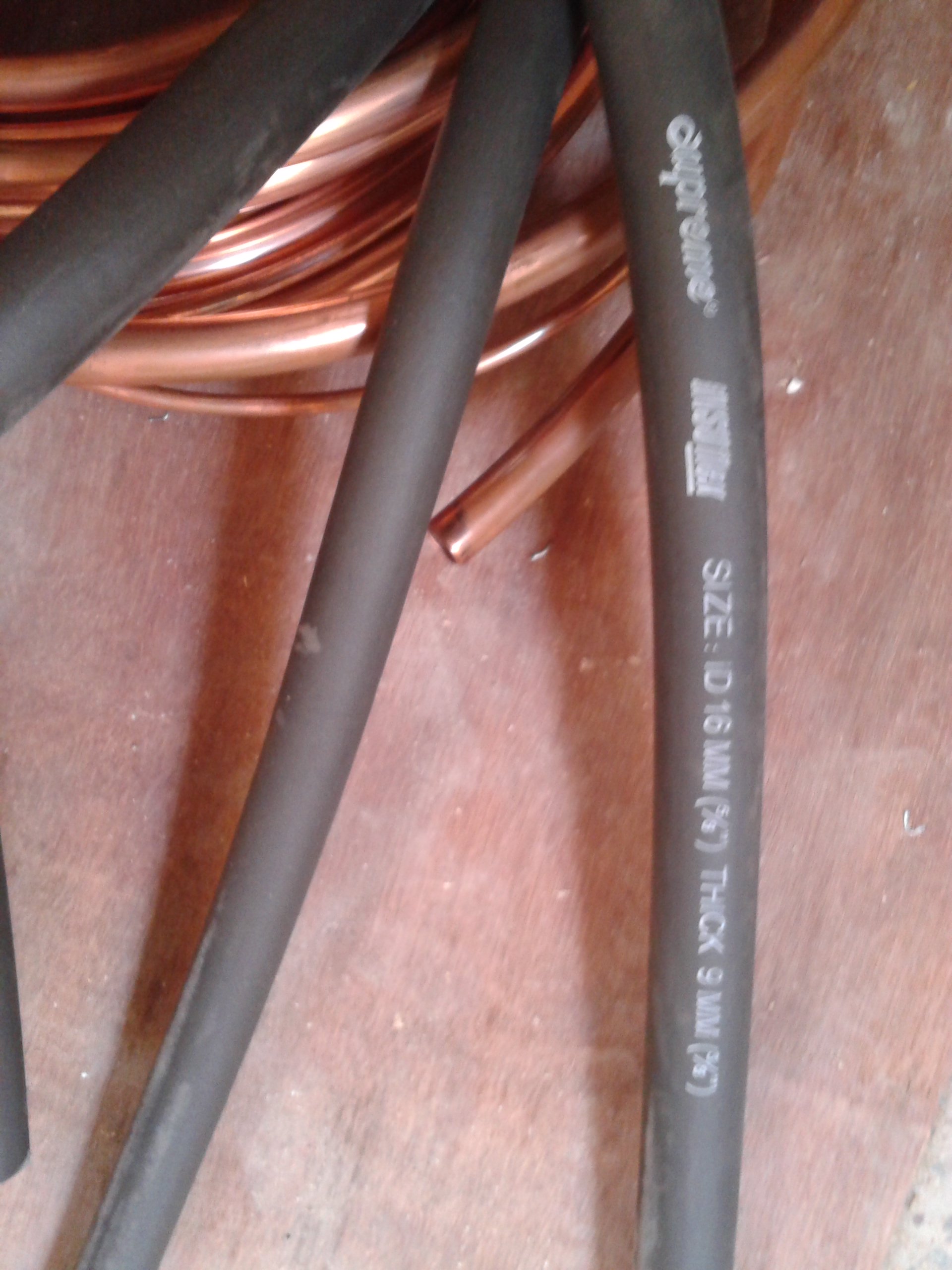

Though the dealer offered free delivery on next day I choose to pick it up from godown to save a day’s time. (Bad decision on my part as the units are quite big and they were stuffed in the car with considerable difficulty and I had to carry them from the car) Daikin’s installer called me the next day and installed it in less 2 hours. (1 guys came, a main guy and a helper). I had called my regular installer earlier and asked him for what to check. He asked me to ensure that the copper tubes were either of Nippon/Totalline/Company’s own make and Flarenet should be from GE. Daikin installer said the copper tubes were made by Daikin but there was no marking as such in the tube. Flarenet was provided by Daikin.

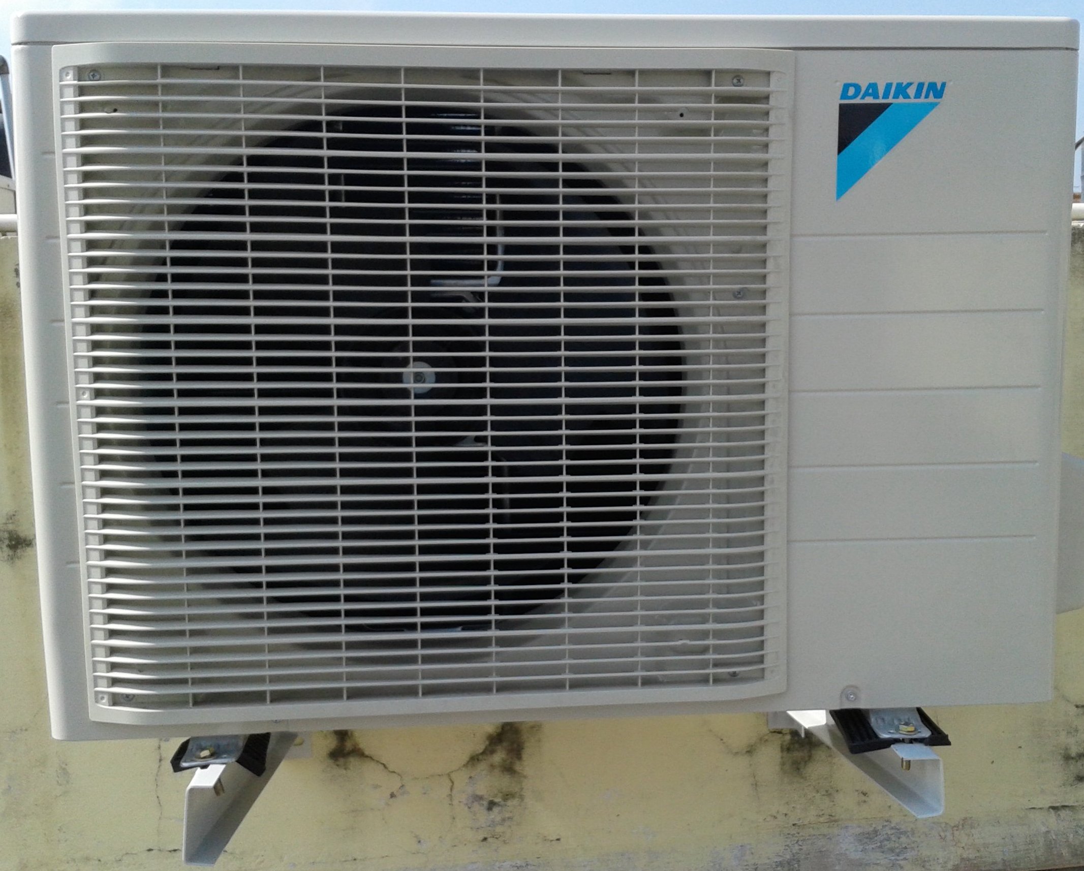

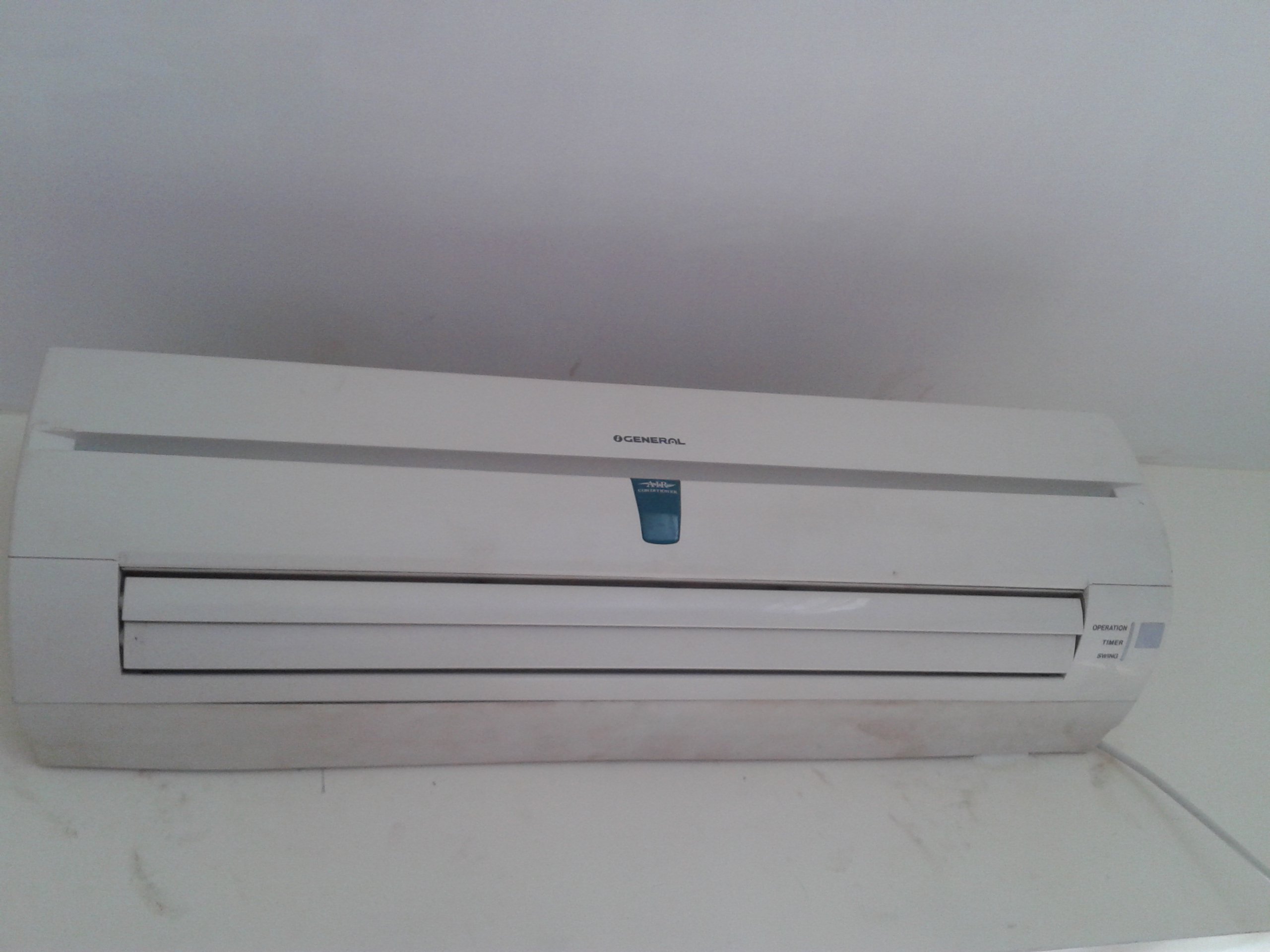

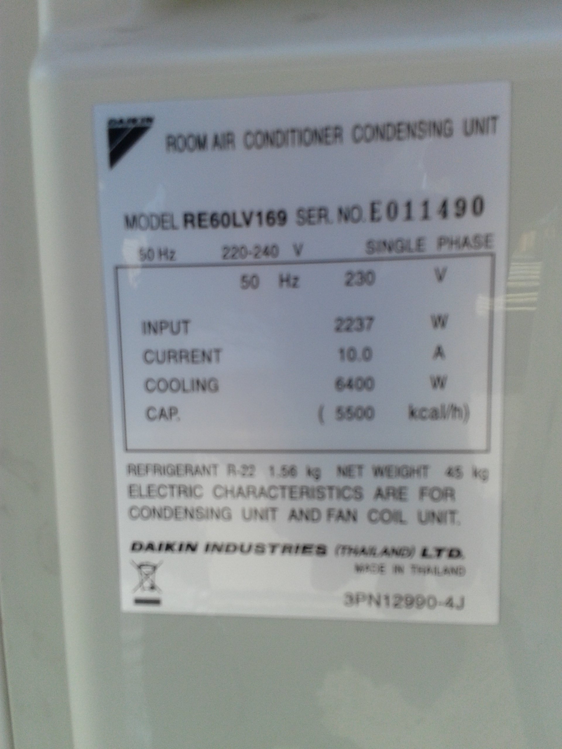

  1. First one is the copper pipe and drain pipes bought by the Daikin installer. My regular installer told me that good quality/full roll will be wrapped in a sheet and not exposed like this. I am not sure of what he meant exactly.

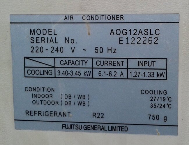

  2. Second is the picture of the specs in Daikin 1.9 outdoor unit.

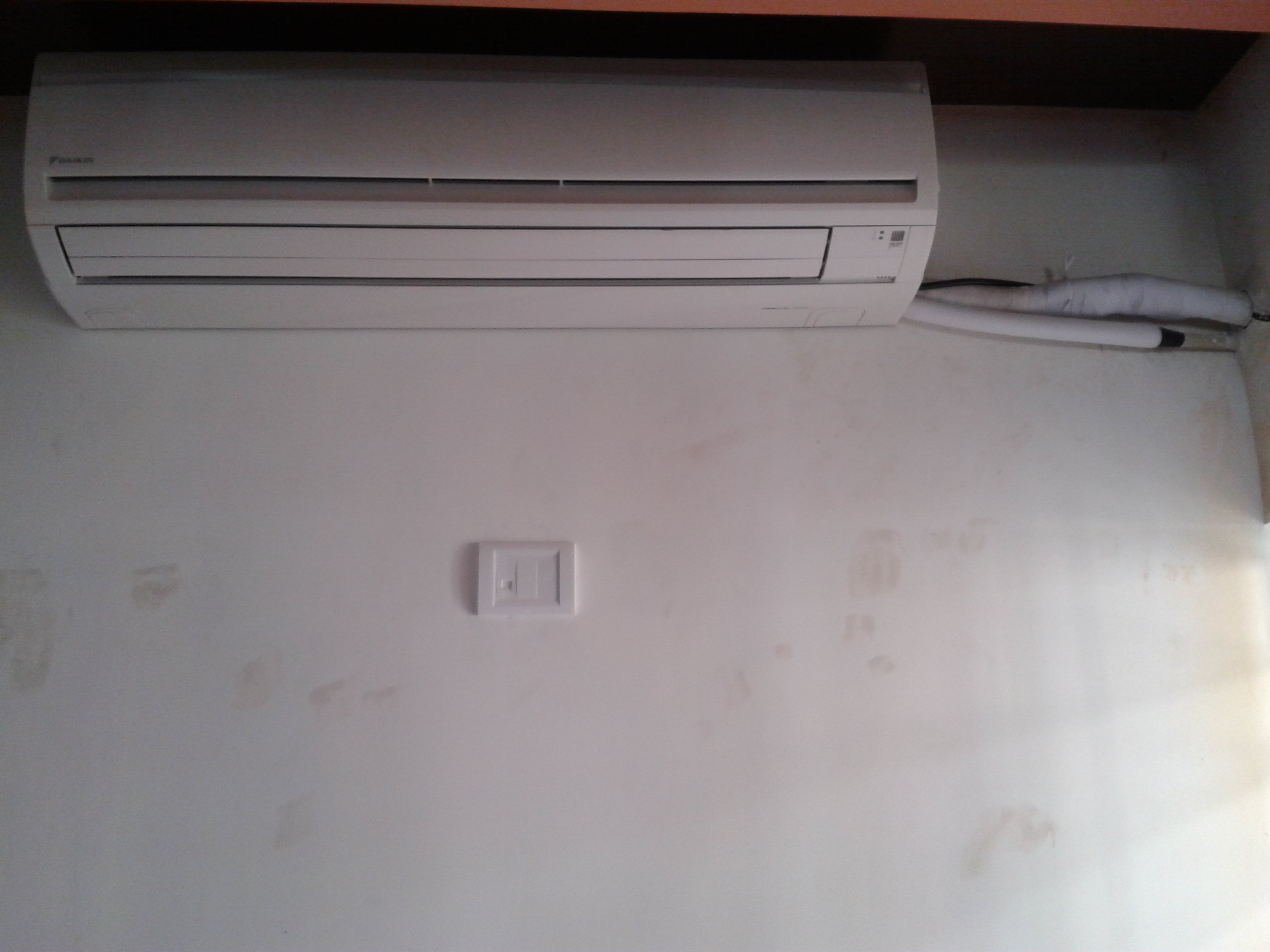

  3. Daikin indoor unit.
  4. Daikin 1.9 Indoor unit.

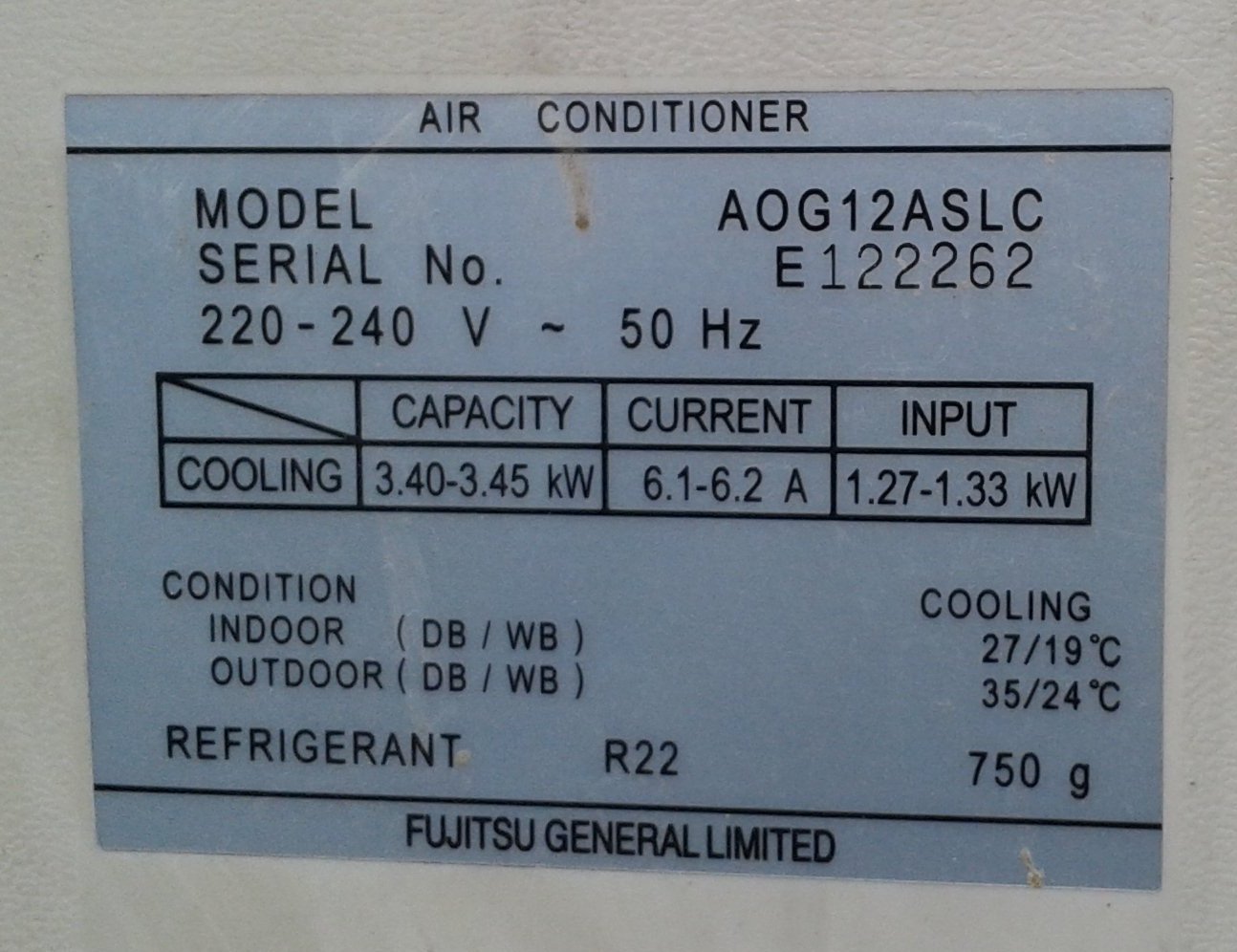

  5. picture of the specs in Ogeneral 1.0 ton outdoor unit.
  6. Ogeneral indoor unit. The unit is smaller than what you see in the picture but looks solid.

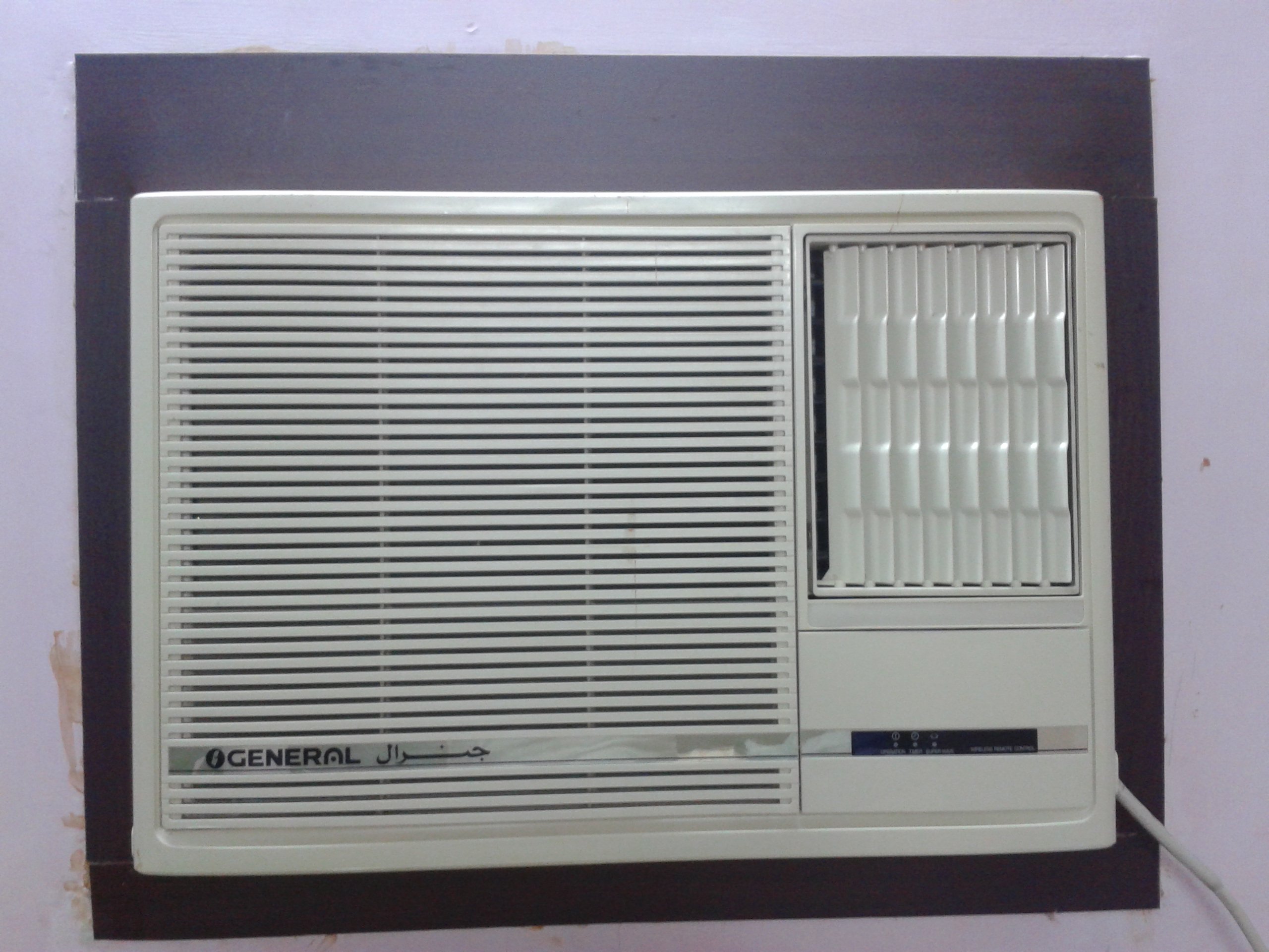

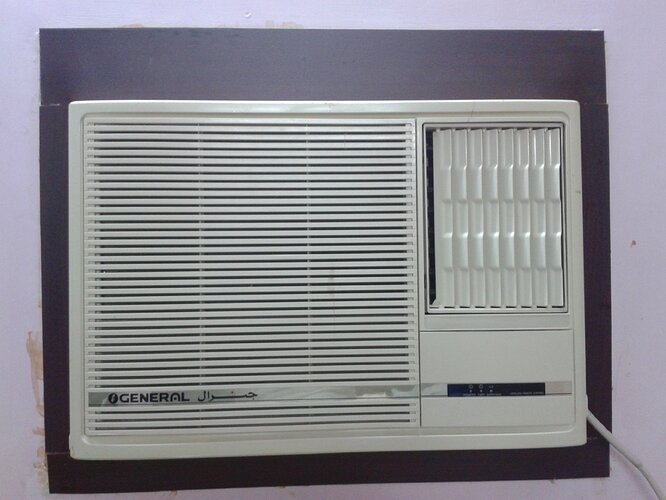

  7. That the 1.5 ton Ogeneral window unit.
Must do some carpentry for the exposed pipes of Daikin and Casing for all cables.
