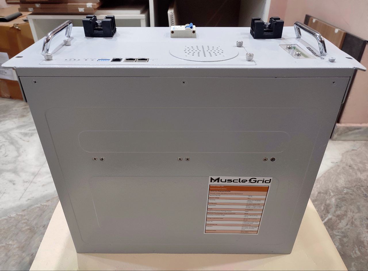

So obviously it had to arrive damaged, dented:
But first, the specifications:
In case it’s not clear, this is supposed to be a 16S unit (but it’s not, its 15S as photos will later show).

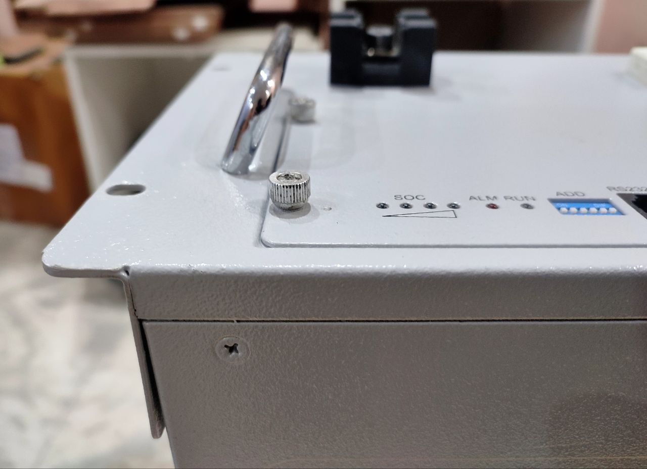

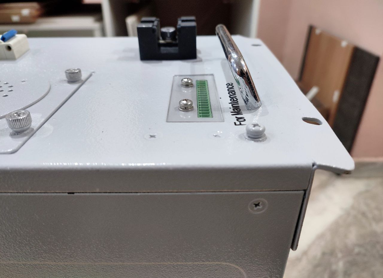

One bent hand grip. Nothing a hammer can’t fix.
Two bent hand grips. I wasn’t planning on keeping this enclosure anyway, I just want the cells.

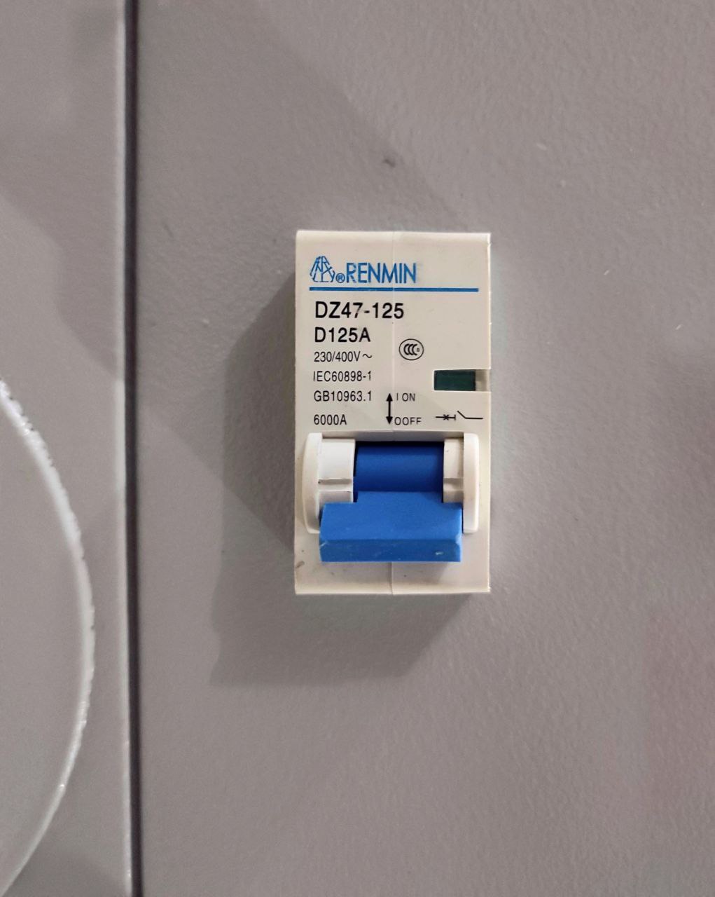

125A DC circuit breaker, that’s good to see and reuse in my own pack.

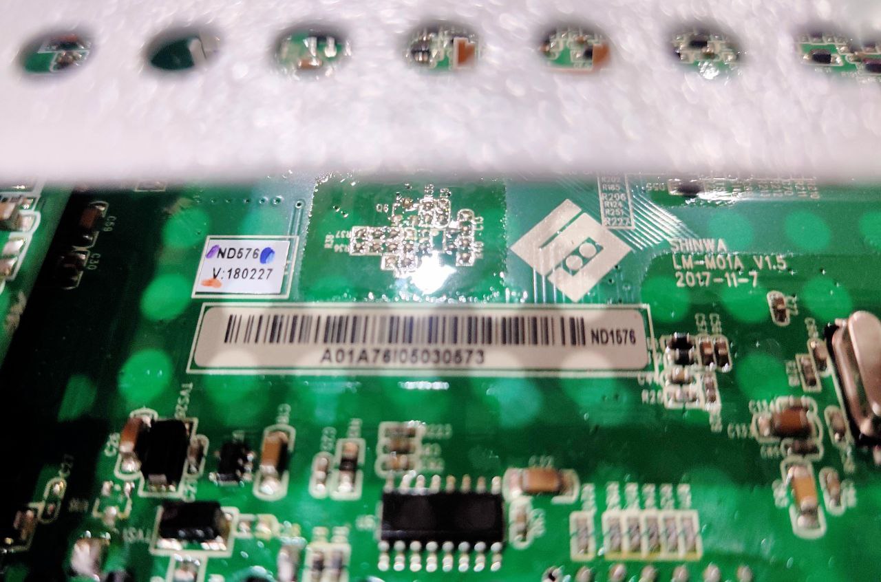

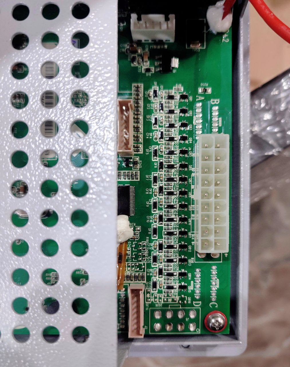

BMS is an older unit from Shinwa:
https://www.shinwa-net.com/products-bms/
Unfortunately while it may support a 16S configuration, it was built for a 15S one:
The connector doesn’t include the B16 pins. Maybe it could be replaced or rewired or reprogrammed for a 16S configuration, I’ll find that out later when I reuse this for a powerwall project.

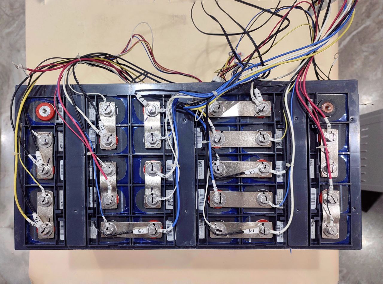

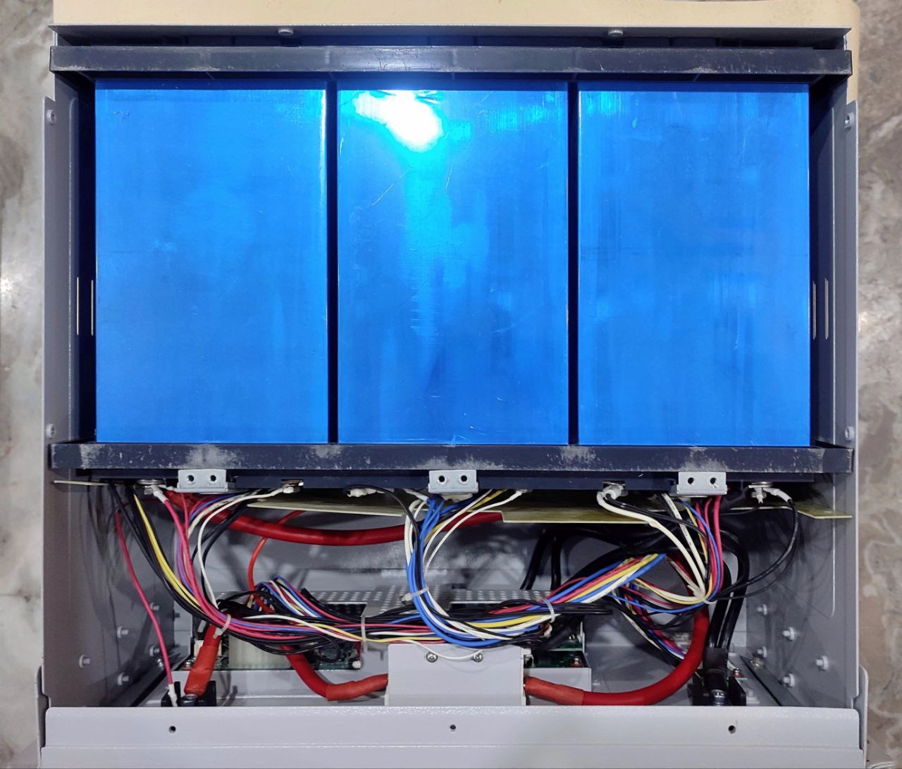

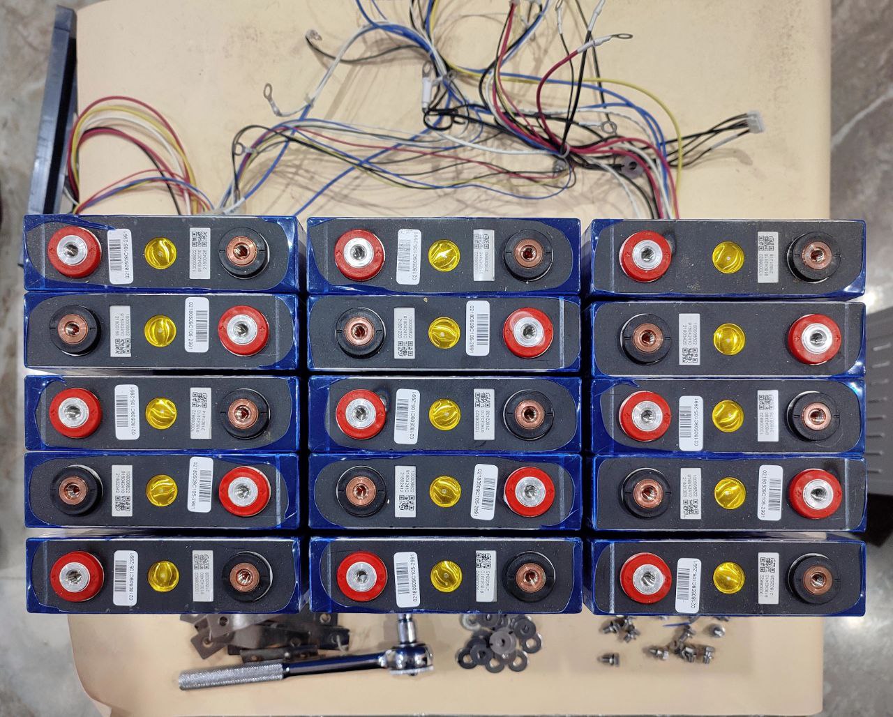

The battery pack itself:
That’s a lot of wires! There’s EIGHT thermal sensors in there, probably to make sure nothing overheats — either because this 15S configuration was meant for Li-Ion chemistry originally, or they expect 48V inverters to overcharge this 15S pack, at 14.4V that’s a per cell voltage of 3.85V which is well out of spec for LiFePO4.
Yeah, that’s a 15S pack.

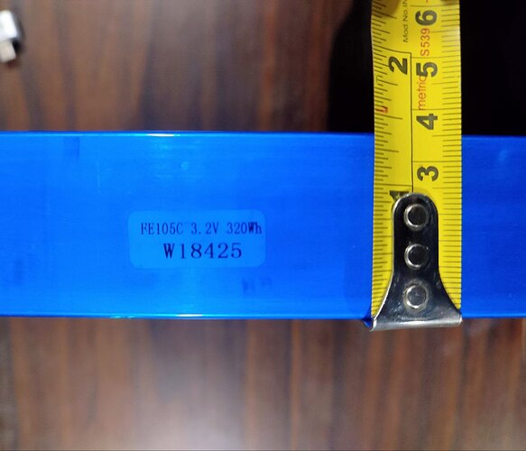

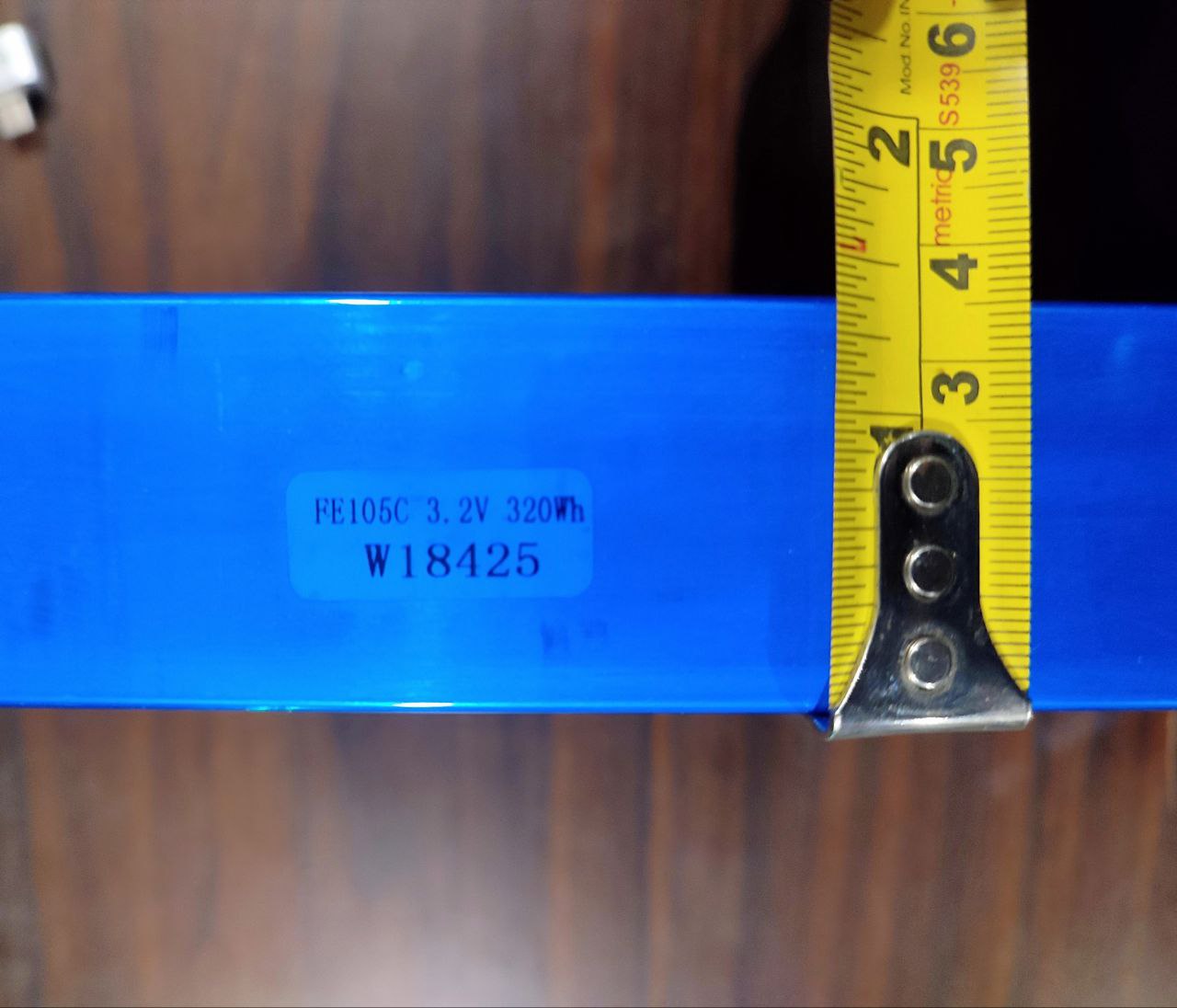

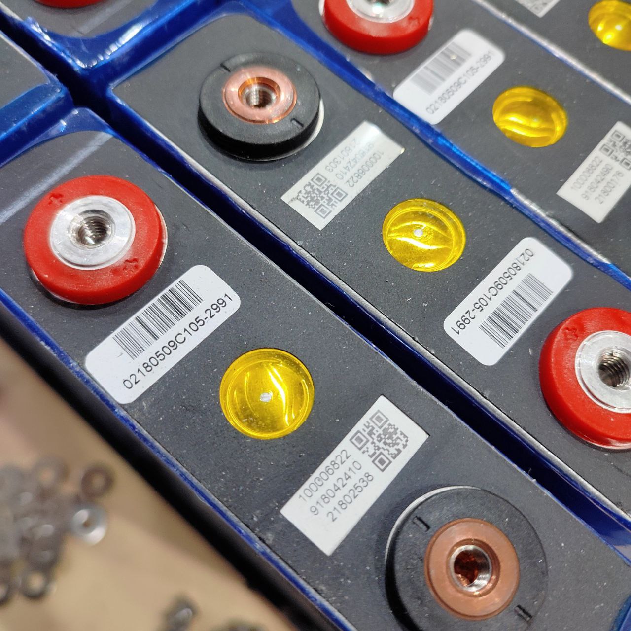

This information is mostly useless, nothing comes up in battery databases or web searches.
But this sticker reveals it’s a Narada Power FE105C cell. The C indicates it’s a lower-grade cell, more about that here:
And it also indicates it’s a 105Ah battery, not 120Ah as claimed by MuscleGrid.

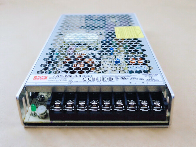

Currently waiting on Sharvi Electronics to ship out the 3.3V 40A power supply I purchased, it’s adjustable so I’ll be using this to charge up each cell to 3.65V before I start the capacity tests.

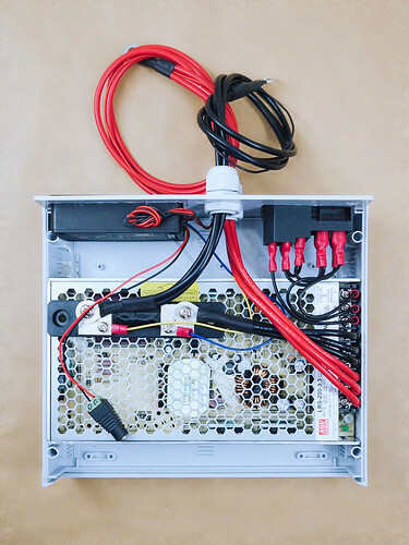

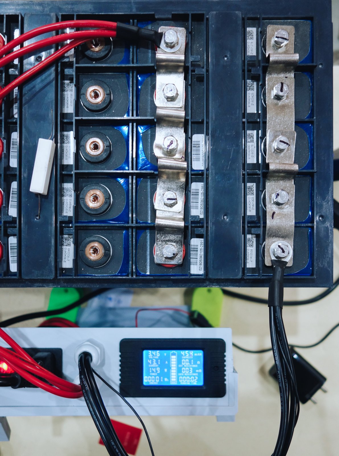

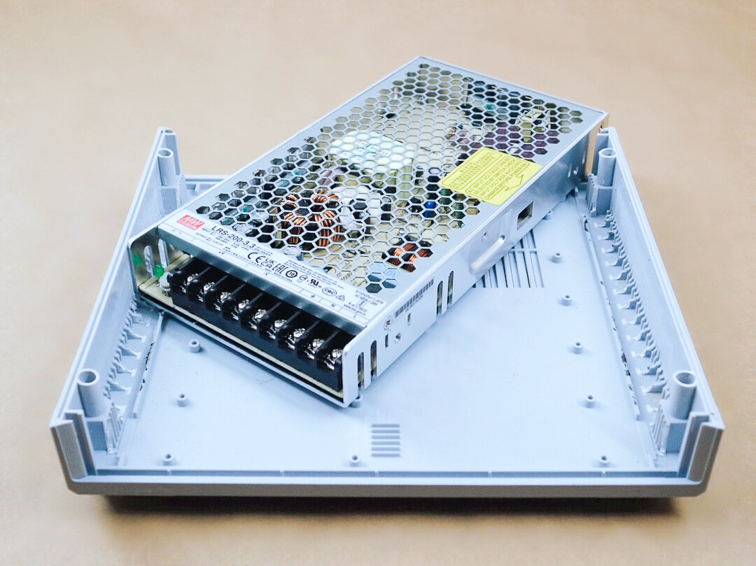

Update time! I put together a rudimentary high-amp charger to top off these cells to 3.65V:

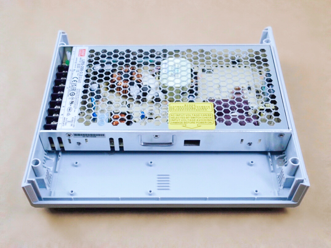

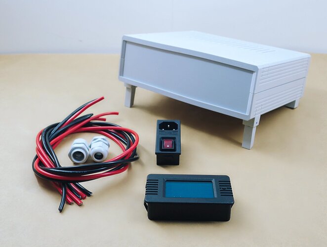

I’ve always wanted to use these instrument cases for something and now I finally get a chance! They’re from:

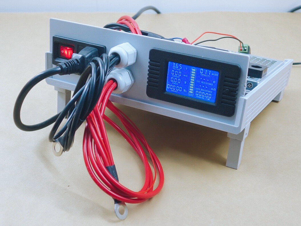

Also here is a PZEM-015 DC Battery Capacity tester, a panel mount IEC socket+fuse+switch from Sharvi Electronics, 2 meters of 12AWG silicone wire from Quartz Components cut into thirds, and PG11 cable glands from Sunrom Electronics.

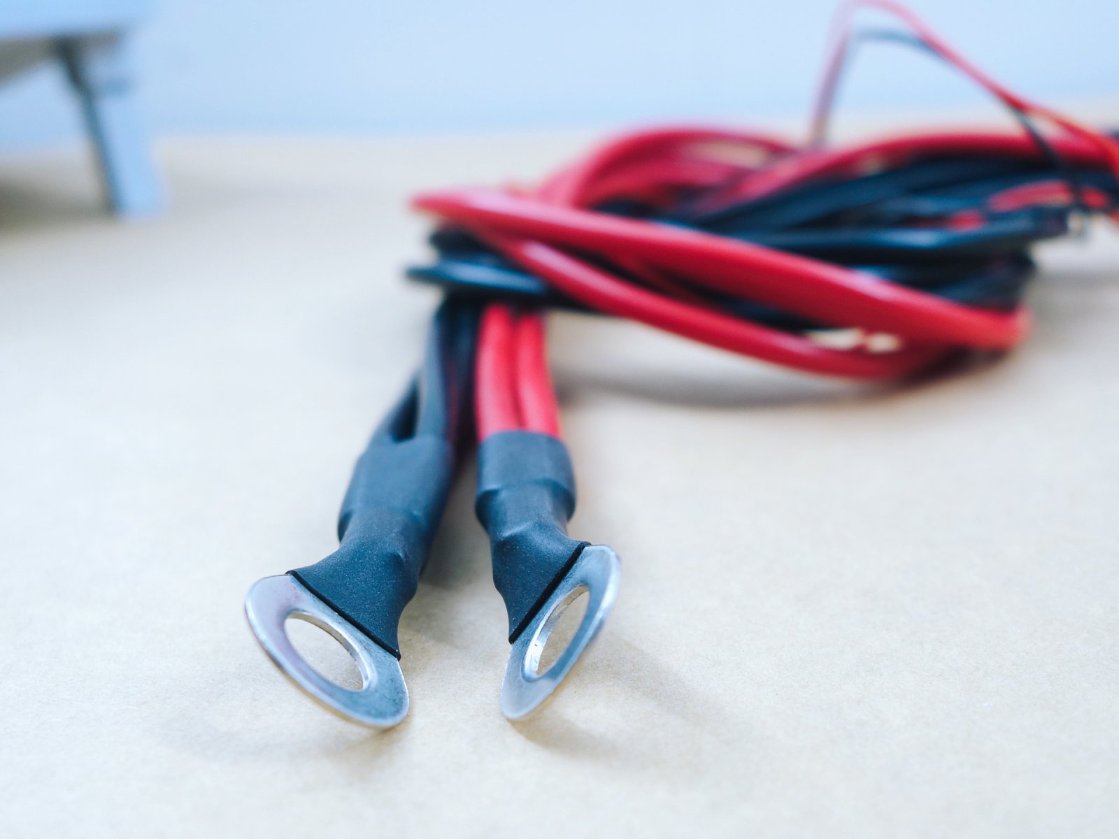

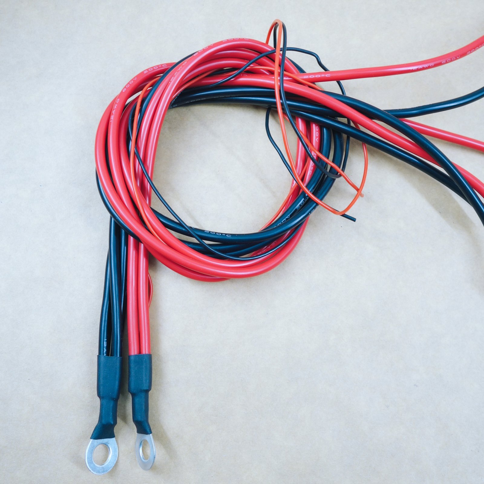

First was to crimp the wires into a 10mm sq uninsulated terminal lug, these were only available in 8mm hole sizes at Quartz Components:
I’m using 24AWG silicone wire for voltage sense of the PZEM module.
Gratuitous bokeh:

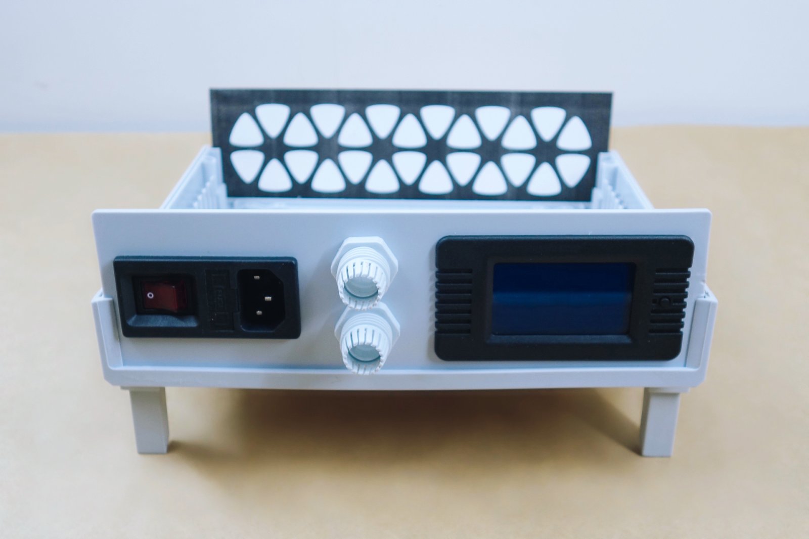

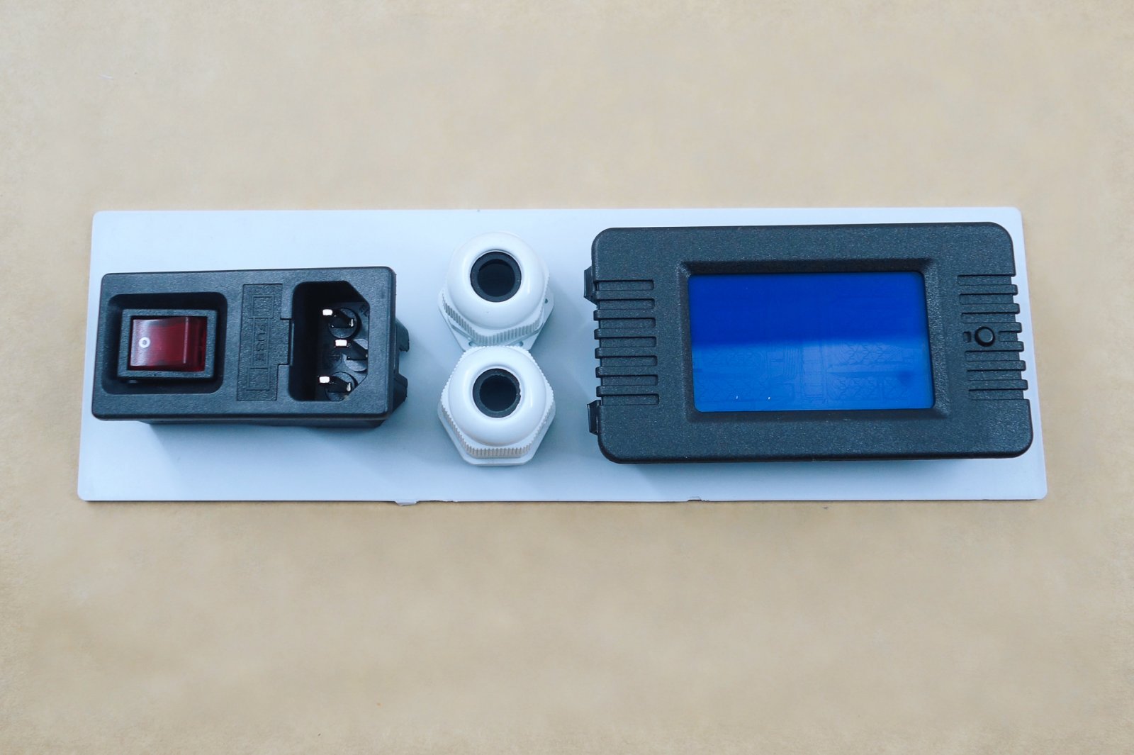

Front panel layout:
I wanted everything to be accessible in the front, including the power socket and switch. It’s not conventional but way more usable, in my opinion. Switches are outward facing for the same reason: usability.
After some quality time with a rotary tool, I got the first revision of the panel ready (already found ways to improve it — but that’ll be in another update):
That’s a mockup of the exhaust/venting in the background. Funny, I wanted something angular and futuristic and ended up with something organic instead. The design evolved to rounded edges with no sharp corners so as to facilitate easy dust cleaning.
Then a week a later this showed up — 40A at 3.3V! It’s adjustable so I’ll have it set at 3.65V:
oops:
Some hours of sanding later, it’s a snug fit.

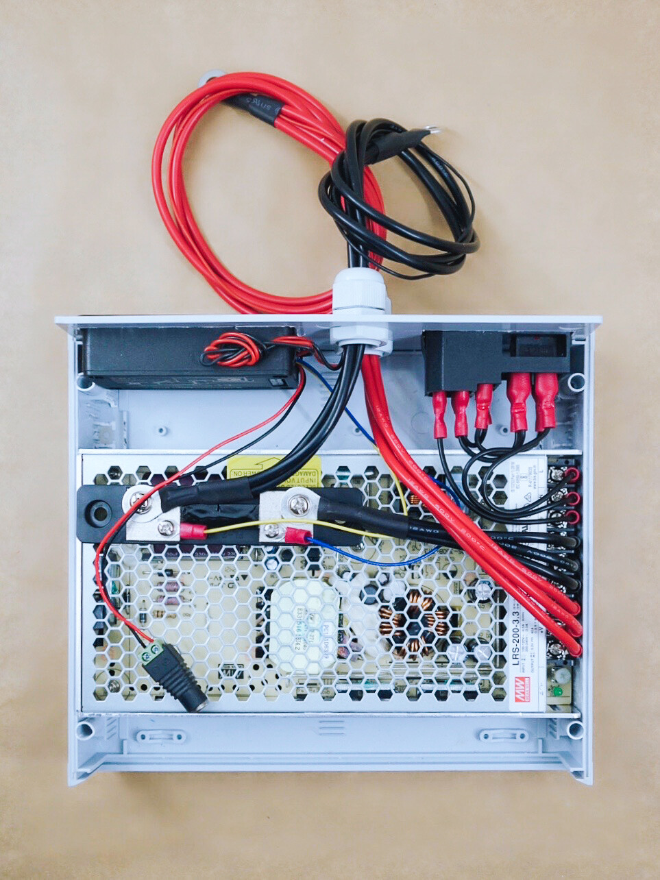

A couple of evenings of were spent wiring everything up:
Eventually the PZEM module will be powered from the same power socket to make this all self contained.
I’m also considering adding a ESP8266+INA219+Relay to cut off power automatically at 3.66V volts.

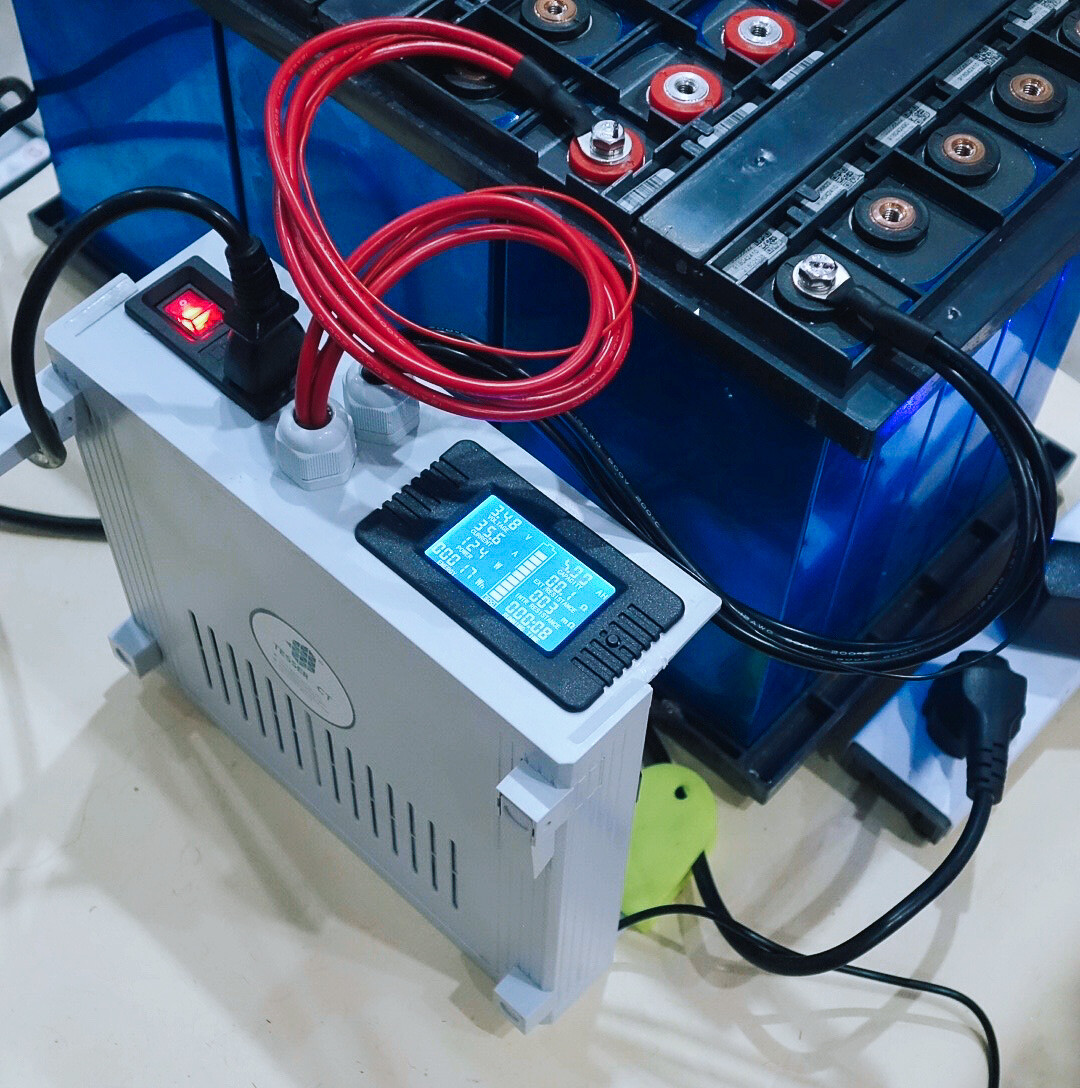

With the power supply adjusted and powered on, everything looks good:
And here it is in use, charging up these cells, one by one:
It’s taking about 45mins to add about 11.8Ah per cell to bring it up to 3.65V, that would mean these cells were shipped at 89% State of Charge, if they really are 105Ah.
Next up is to charge up all the other cells and do a capacity test of each cell down to 2.5V.

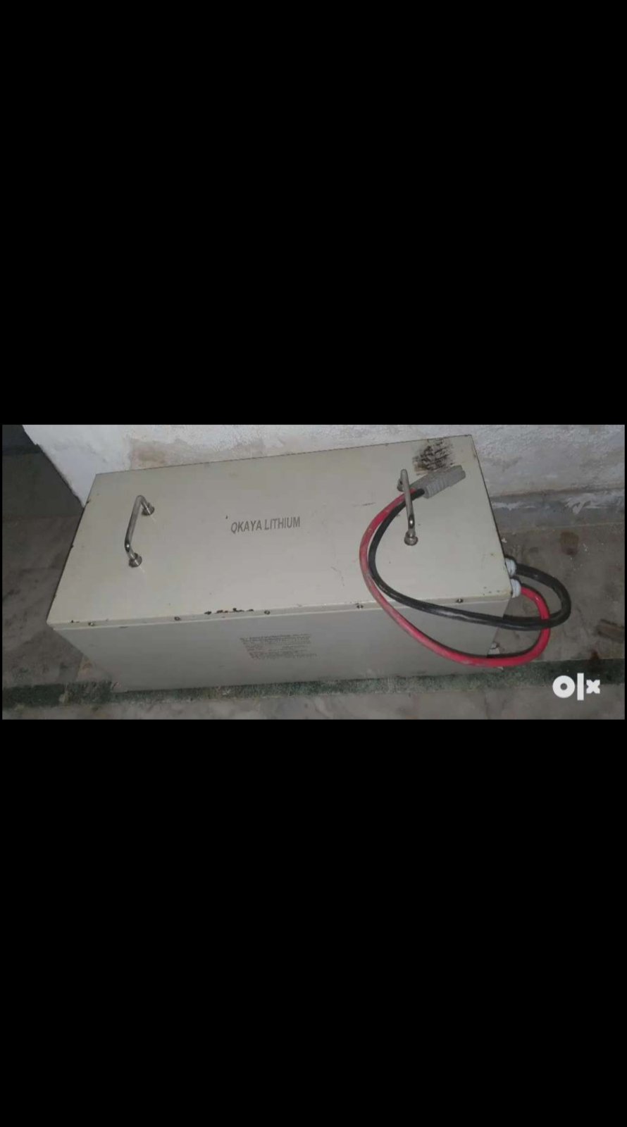

Have asked a few on olx, for lifepo4 battery one of the guy selling an okaya lifepo4 battery used in ev for 25k 48v30ah, another one selling kinetic lithium battery of 60v28ah asking 15k it maybe Liion or other, don’t know.
As i don’t know how old are these what should be the used price.
Another one is 48v160ah okaya lifepo4 one with asking of 48k.
Another is some greenbolt 12v 50ah lifepo4 with asking of 8k for new. Seems a local assembler
The 48V 160Ah battery at 48k is a very good price, the 30Ah is priced almost the same as new. The brand doesn’t matter since they’re probably all Aliexpress/Alibaba cells/packs that have been repackaged/rebranded. You will need a 48V inverter for them though.
I didn’t realize these would be available second hand. Can you ask that seller to share photos of the 160Ah battery?
this is how it looks. Mostly these are ev batteries
That’s definitely a very good price for a prismatic pack. I wouldn’t want to travel to Delhi for it though.
The capacity testing is complete! Here are the results:
Cell Vpc as received +Ah for 3.650Vpc SoC as received -Ah to 2.5Vpc **SoH **
1 3.328 26.8 74.5% 104.689 99.7%
2 3.331 13.9 86.8% 104.821 99.8%
3 3.328 17.7 83.1% 103.741 98.8%
4 3.330 11.8 88.8% 100.382 95.6%
5 3.331 11.8 88.8% 102.466 97.6%
6 3.330 13.5 87.1% 100.143 95.4%
7 3.328 29.3 72.1% 104.442 99.5%
8 3.331 13.0 87.6% 102.481 97.6%
9 3.331 11.5 89% 104.049 99.1%
10 3.331 12.7 87.9% 102.305 97.4%
11 3.330 14.4 86.3% 100.902 96.1%
12 3.331 14.2 86.5% 105.249 100.2%
13 3.331 13.6 87% 98.522 93.8%
14 3.331 13.4 87.2% 101.093 96.3%
15 3.331 13.6 87% 103.237 98.3%
Most consider a capacity over 90% as being pretty decent for a used LIFePO4 pack — so it’s nice to see that the lowest capacity of any cell in this pack was 93.8%.
The highest capacity of any cell was 100.2%, this places that cell as one of the highest grade ones, likely a new cell. I’ll need to take apart the pack to see if it’s labelled differently.
This pack should have an actual capacity of 15 cells x 3.2 volts x 98.522 amp hours = 4729Wh. This brings the cost per kWh to Rs 14,424 or about $173. Not too bad!
