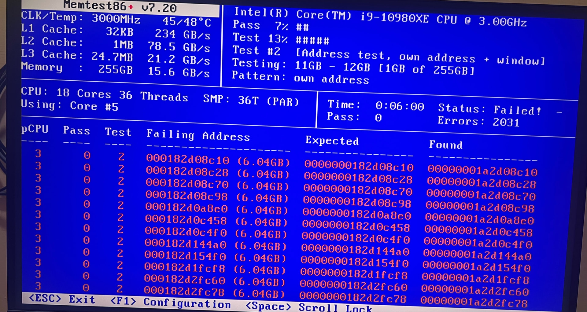

Last night while removing a usb drive, I accidentally pressed clear CMOS while the system was ON. The system rebooted and I got “init ramdisk : Alloc magic is broken at 0x4e9d4470” warning in proxmox.
Upon troubleshooting I’ve realised that A1 and A2 memory channels are not working the way they should. The system does recognise RAM in all channels but memtest gives the following error:

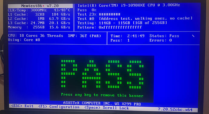

I’m fairly confident it happened yesterday because I run memory test periodically and it passed on Dec 25th 2025.
Next, removing the memory modules from channel A1 and A2, while keeping other 6 channels populated also passes the mem test
So my question is:
  1. Is it possible to repair the A1 and A2 channels of motherboard?
  2. I’ve ruled out the faulty RAM because same module works in different channel. But is this a sufficient condition to arrive at this conclusion?
  3. Lastly, I can still live with 192GB RAM if two channels are corrupted, but would anyone know if it’d still run in quad channel mode with 6 channels populated? Need as much memory bandwidth as possible.
Attaching the mobo data sheet. Any help would be much appreciated, TIA!!
You should try re flashing your BIOS , seems like you corrupted it somehow.
I’ll try and update here. But do you know if clearing CMOS can cause electrical failures as well? Something that can’t be solved by BIOS reset?
Man that totally did it. I was overthinking so much. Unfortunately the corrupt BIOS also took about 2 weeks of work with it, but that’s certainly better than replacing a PC in this timeline. Thank you so much again!
