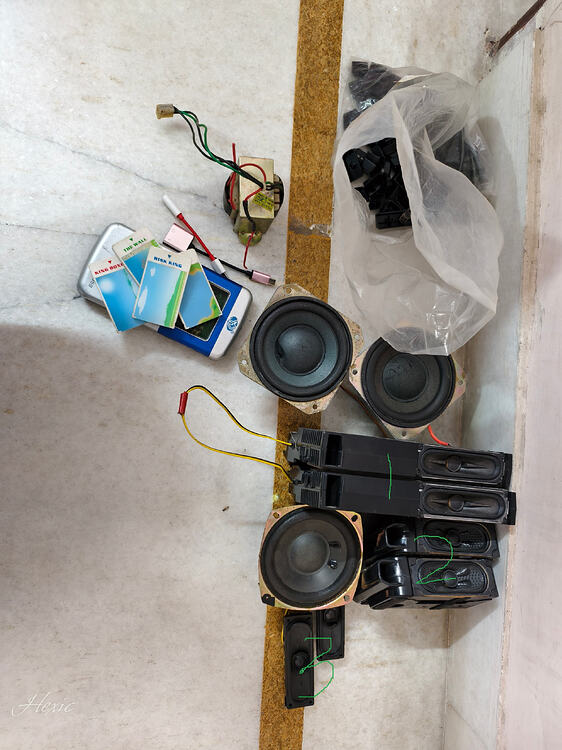

I just got 2 pairs of tv speakers from a member giveaway. Both pairs are different and 10w 6 ohm each speaker. Also have 2 12v 4a adaptors with odd barrel size.
I have taken the pic from the listing. Number 1 and 2. They come with their own enclosure.
Was thinking in making them into active speakers using some board. Don’t know how to solder but this will be a good way to learn some basic skills.

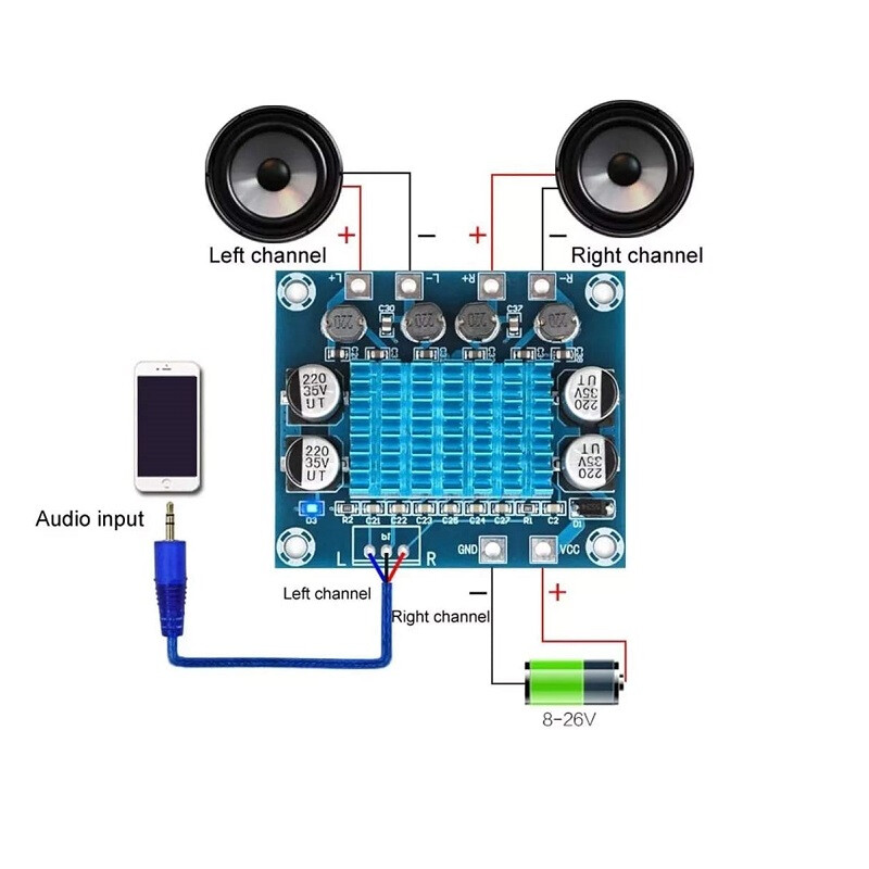

Make them into 2 individual sets using the TPA3110 board.
Electronic Spices TPA3110 15W + 15W Dual Channel Stereo Digital Audio Amplifier Board : Amazon.in: Electronics

That is probably the right way to go.

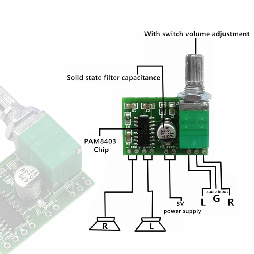

But a better board maybe this one.
But if you just want to start out you could also use this one. Not powerful, but It includes the volume knob.
But this needs only 5V power, NOT 12V.
Great choices. The blue board was my first pick. Reviews are bad with a lot of low quality fakes in the market. With the other board I can atleast see the chip, will add a heatsink if needed. Don’t want to be disappointed, thrown off because of a faulty/fake chip. This whole thing will get nipped in the bud. Most boards are 12v to 24v and will work best with 24v. Don’t have any equipment and honestly the knowledge.
The other board you mentioned would be my beginner choice for 5v. Already have 12v adaptor and want to make use of it. 12v 2.5a should suffice for the 12v boards.

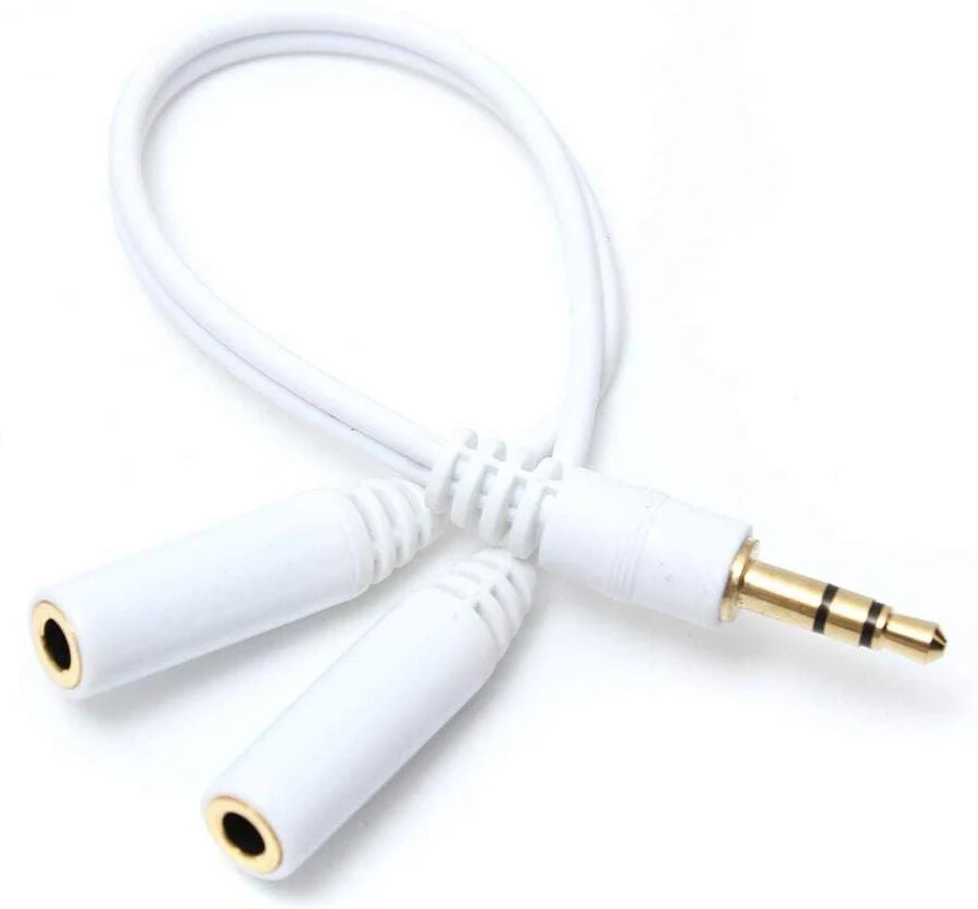

If you use this splitter.
Then you will end up with two pairs of Left Right Ground wires for each board.

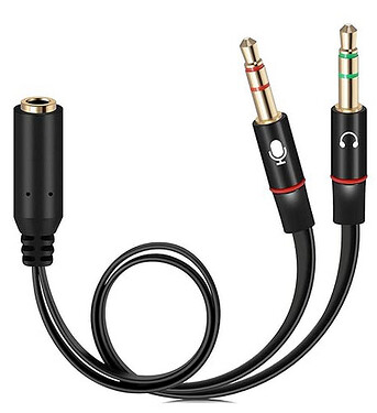

There are two kinds of splitter available in the market, one which splits the male 3.5mm into 2 female 3.5mm jacks, the above.
The other one is where it just splits the mic from the 3.5mm. Like this one.
Don’t buy this one by mistake.

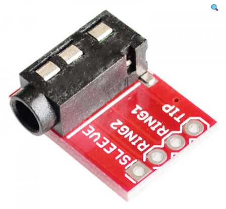

To avoid cutting the wire, you can buy modules like these. These allow you to tap in easily.
Sleeve - is Ground wire.
Ring1 and Ring2 will be left and right.
