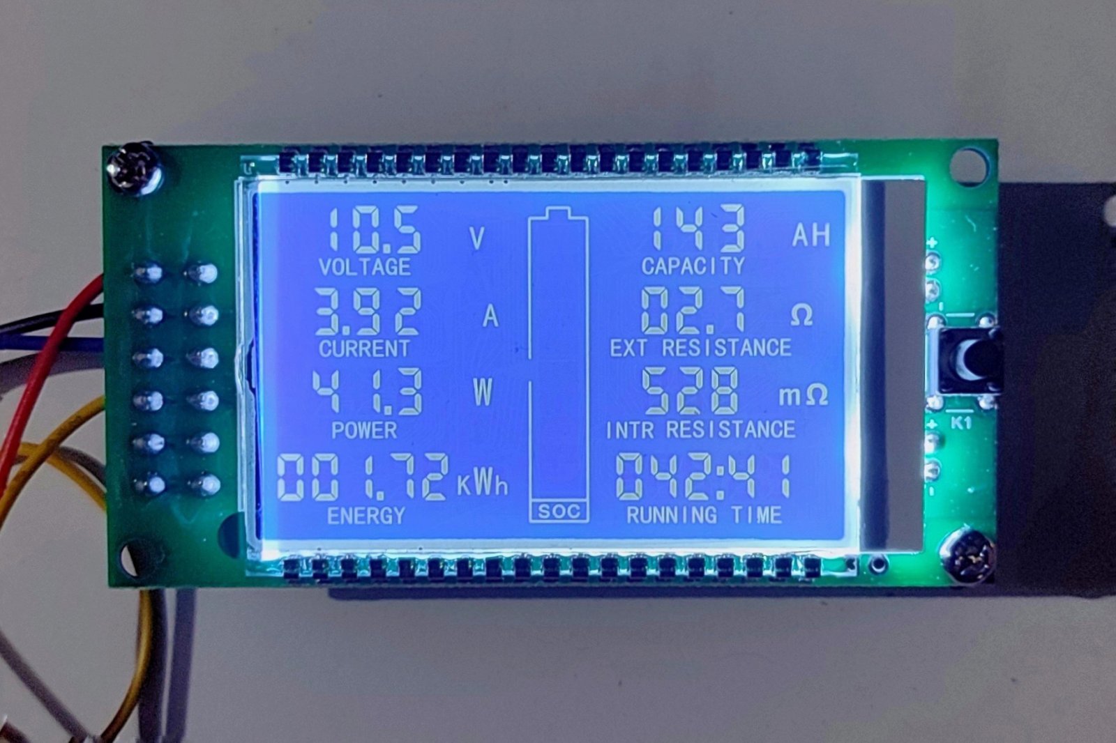

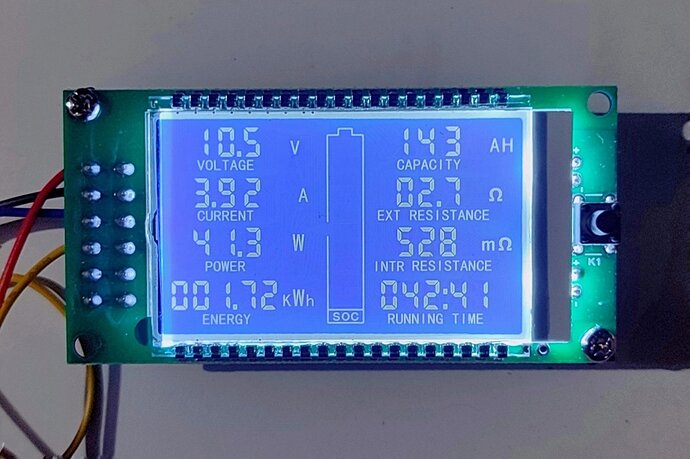

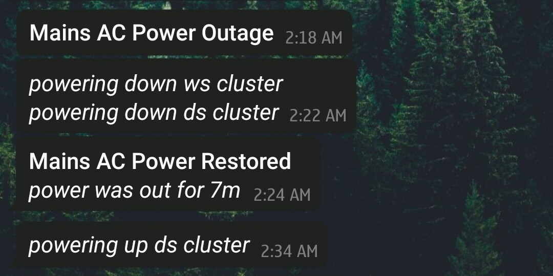

This is what I did with my IoT battery monitors, when voltage crossed a threshold, the script initiated shutdown. I use mqtt to communicate between the various systems, nodered for logic and telegram for notifications.
Making the battery monitors: DIY Wi-Fi Battery Monitor for Inverters/UPS (IoT Lead Acid Battery?)

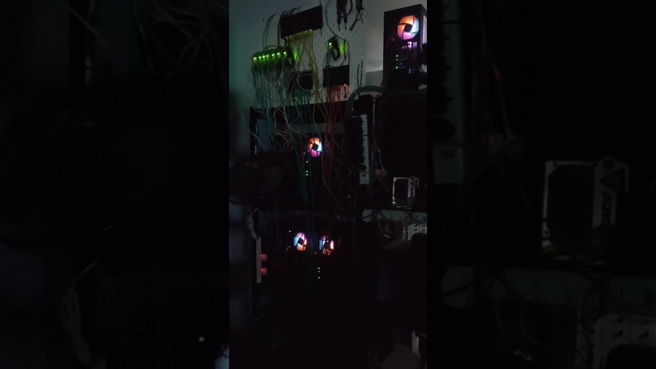

The system in action:
Some explanation:
A older clip of the automated staggered start-up sequence:

Yes the UPS always stays on, I initiate a shutdown of all loads connected to the UPS when there’s 10% left, so the UPS (inverter in my case) can stay on with almost no load (just the smart plugs) for a few more hours until power returns.
This has limits, for my setup it worked for power outages upto 7 hours:
