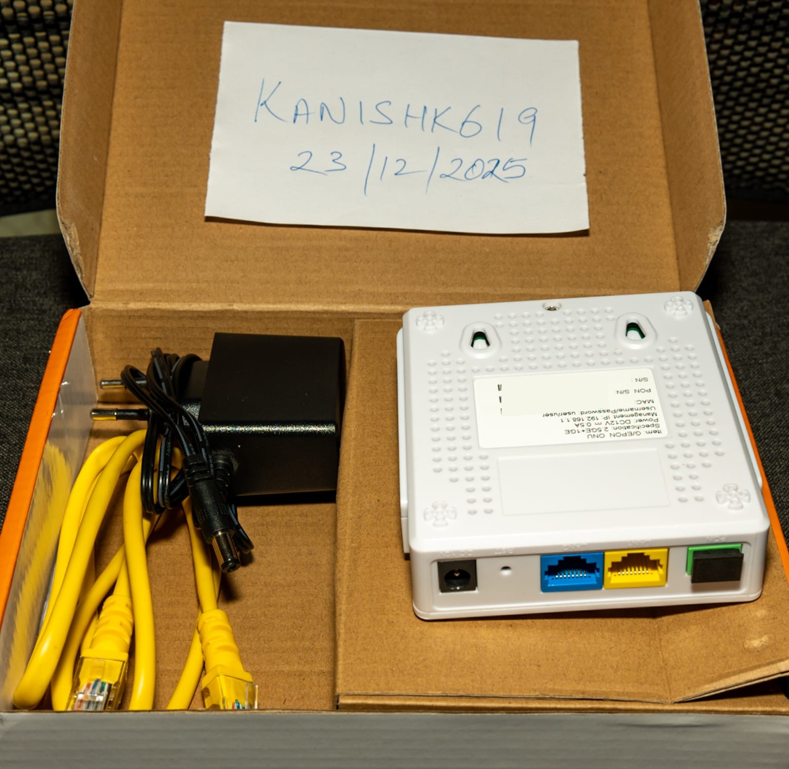

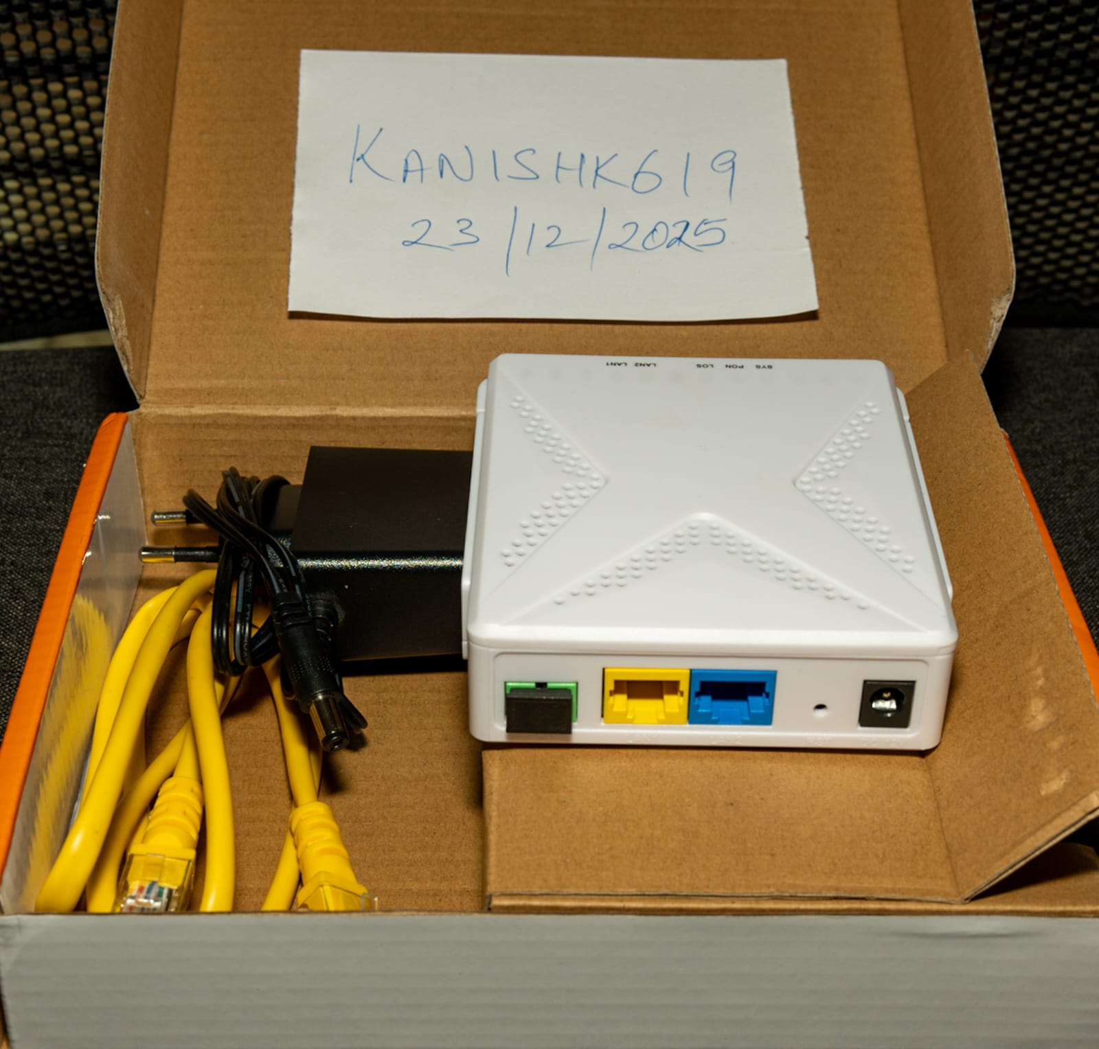

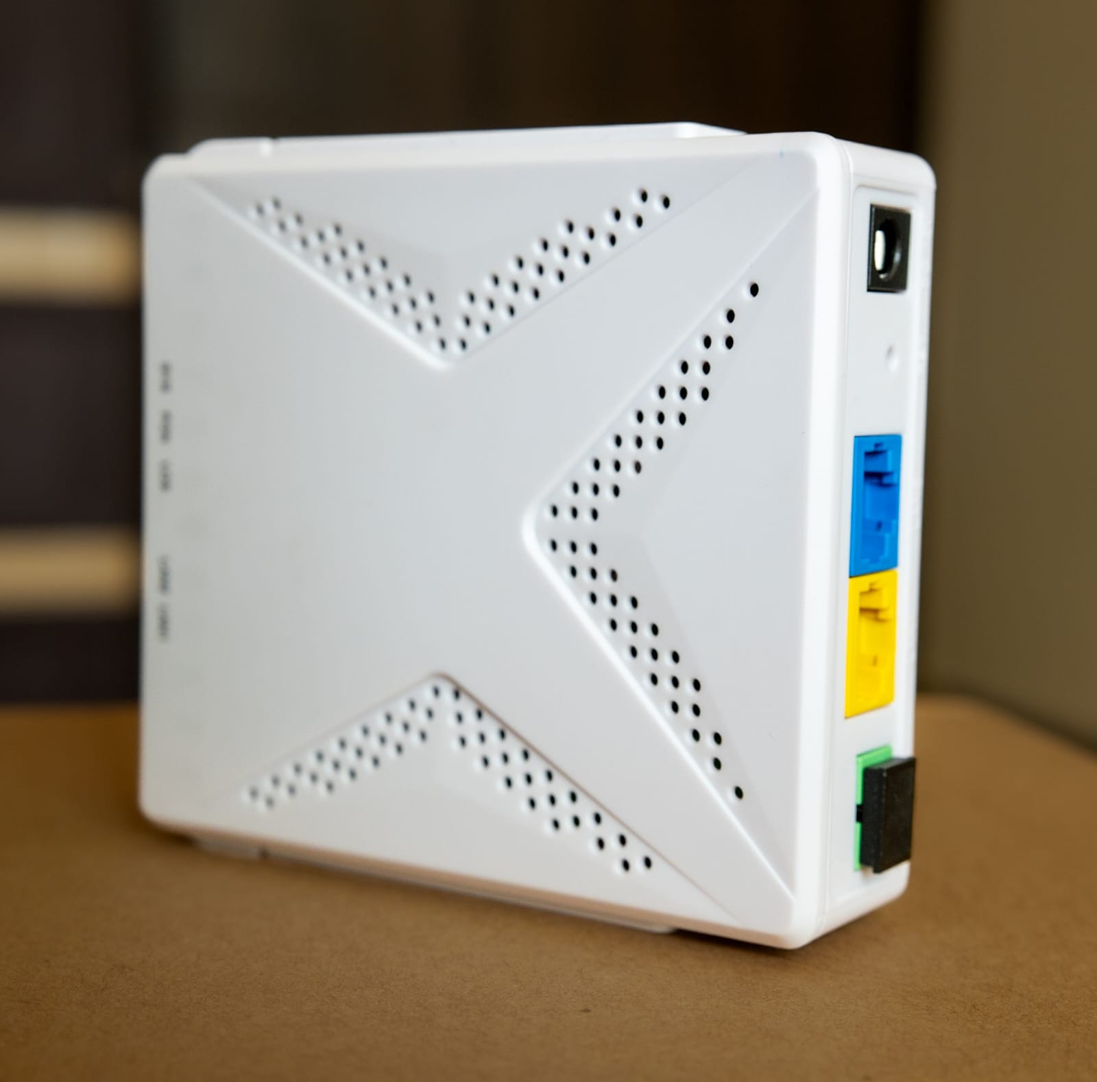

Vsol xpon ont (v2802rh)
Purchased couple of months to use with Jio fiber. Switched to SFP stick and don’t need it anymore.
Doesn’t work with new Airtel Fiber connections as far I know, please do your research on this.
