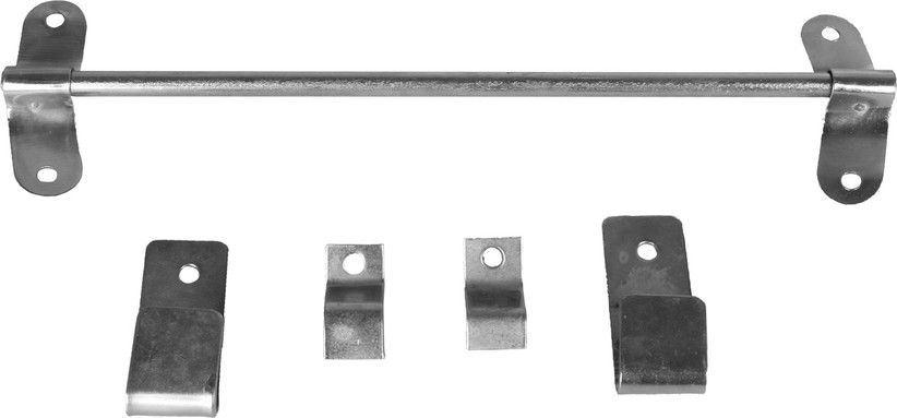

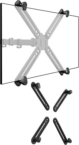

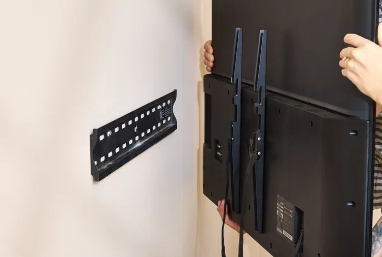

The Two Screw setup would obviously work for the Stationary Wall Mount that is like “hanging” the TV. Something like this:
However, I would prefer to install a Wall Mount with Swivel and Tilt. Something like this:
Single Arm:
Dual Arms:
If anyone has any experience with mounting a TV with just two screws, please advise.
Alternatively, can anyone confirm if Wall Mounts can be secured to the TV with just Two Screws.

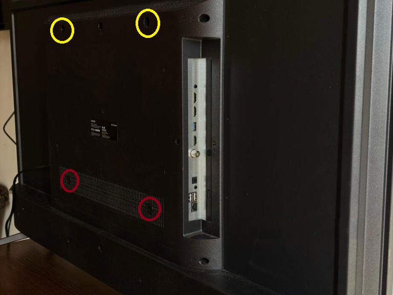

Can you share a picture of the back of the TV?

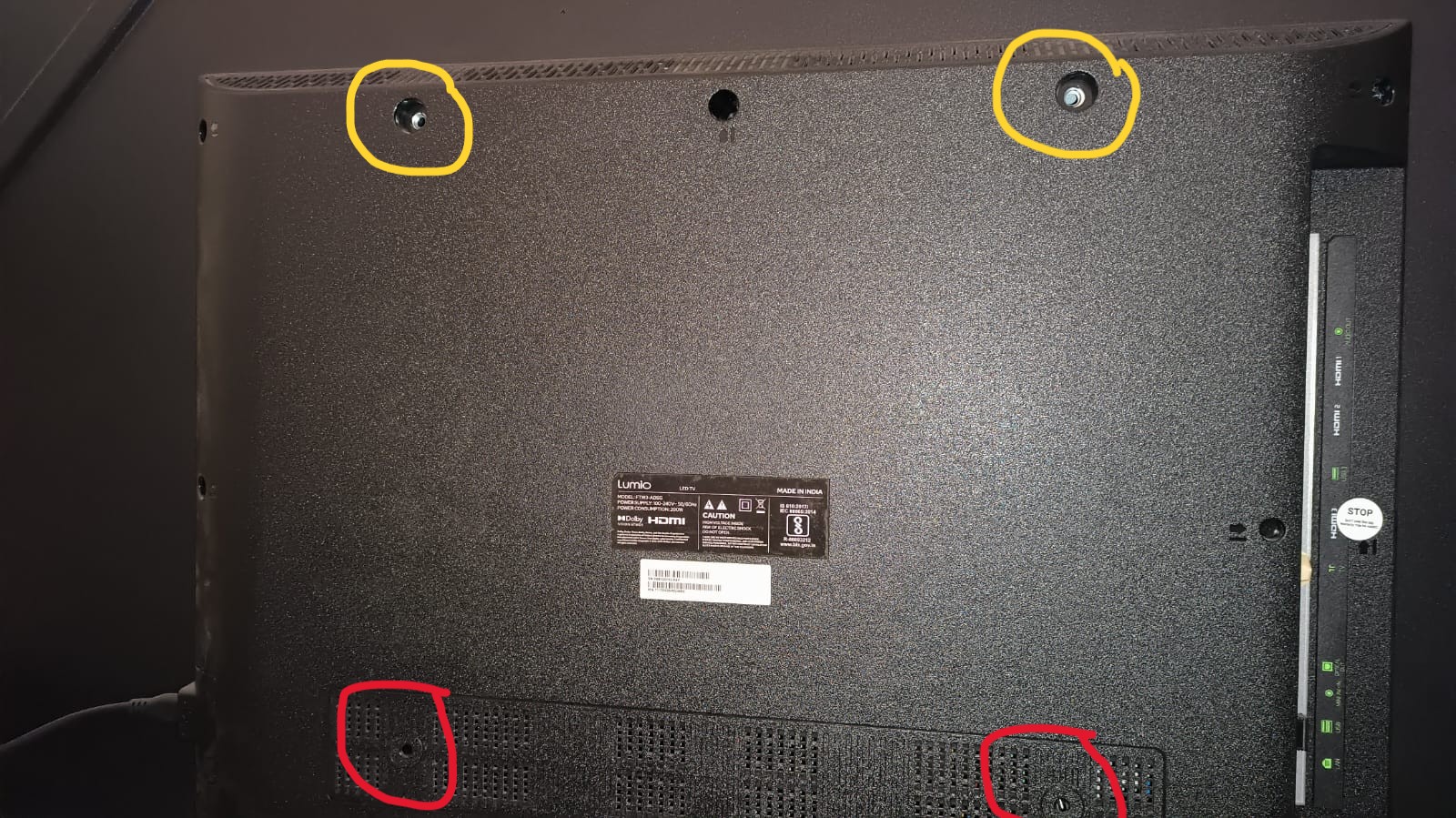

The holes marked in Yellow have proper threads for screws.
The holes marked in Red do not seem to have threads for screws, and these holes are quite small compared to the top holes. These holes might be barely enough for ensuring the mounting brackets do not rotate.

Shoukd have 5-6
Just rechecked. There are no 5-6 Screw mounting holes. The bulged bottom side has speakers inside.
Only the top two holes have metal inserts with provision for mounting screws.
Yes, it seems very weird that there are only two “Proper” Mounting points. Perhaps the manufacturer offered a way to merely “hang” the TV on the cheapest wall mount, which consists of a simple mounting rod fixed to wall, and the TV hung on it with two hangers, one each on the mounting holes.
I have seen such a setup in several offices and homes, but most have been 32-inch TVs, usually for CCTV monitoring.

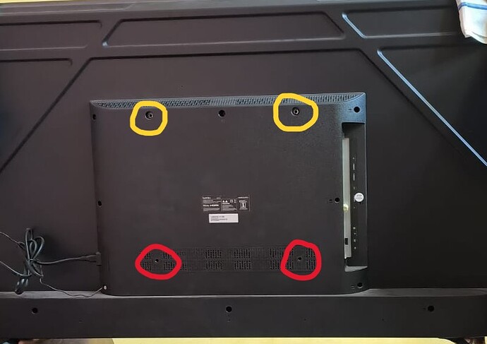

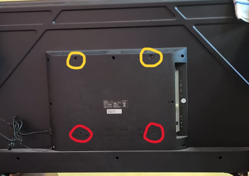

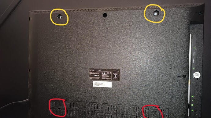

Here are two images of the TV’s backside.
As evident from the images, Secure VESA Mounting holes are marked in Yellow.
The holes marked in Red do not have any threaded inserts.
I think there are screw threads on the bottom as well. I can see some metal shining in the photos. It would make no sense for the manufacturer to make holes without threads. Did you try screwing in correct sized screws? Just use your hands to screw them in without the mount.

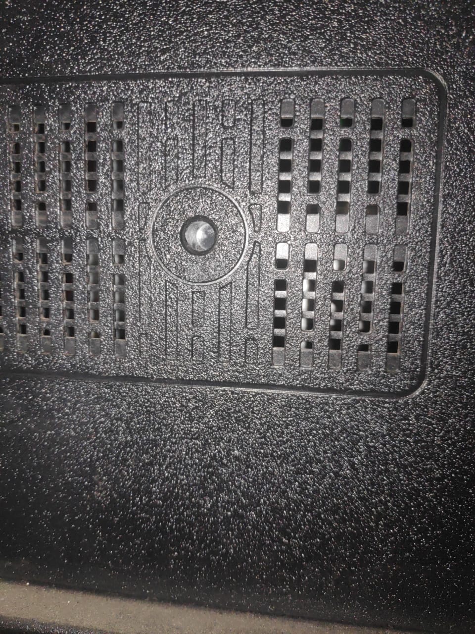

There is no metal. And there are no screw threads on the bottom.

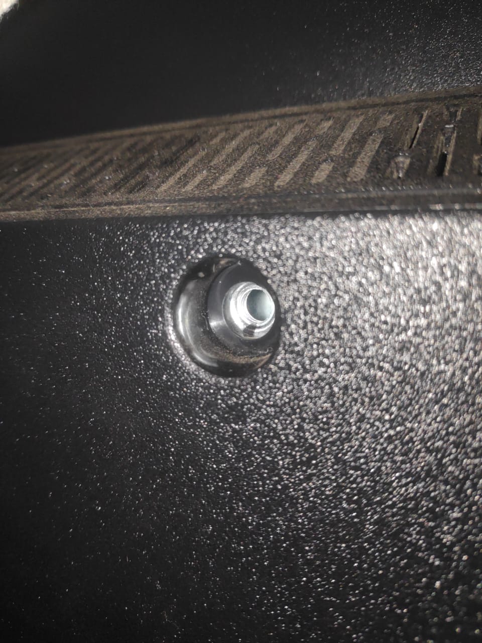

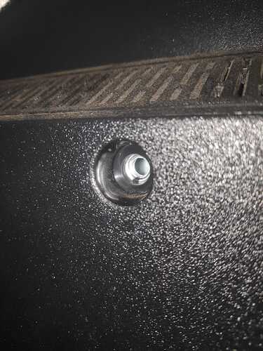

Top Mounting Screw Hole:
Bottom Hole:
It appears there are just two secure mounting holes and that too only on the top side.
If there are genuinely no screw holes on the lower side then your only option is to use the TV stand provided & place it on a table or cabinet

The simple wall “hanging” mount offers no freedom of rotating, tilting, or swaying the TV. It is, however, the easiest and quickest to setup and hang the TV.

Bro there are 4 screw holes
Remove the bottom plastic thingy to expose them
I tried to remove the bottom plastic thingy. But it is part of the entire body. Cannot remove it.
It just looks like a reverse/inwards cap.
