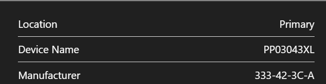

The reported capacity matches the battery spec but I’m highly suspicious that it’s at zero wear after 170 cycles. Faulty BMS chip on the battery maybe?
Battery serial number is also not listed here. If it’s the original battery that came installed in the laptop, nothing to worry. Else I would be suspicious that it’s a third party battery and is reporting inaccurate/hardcoded capacity info.

Use this application.
See how much capacity it says and try unplugging it and see how long it lasts.
And also see the devices discharge rate.
