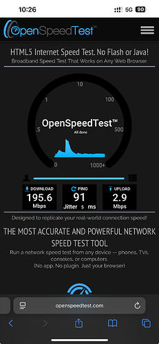

Why my Jio 5G speed is so low?
Hello all
Better to complain to Jio

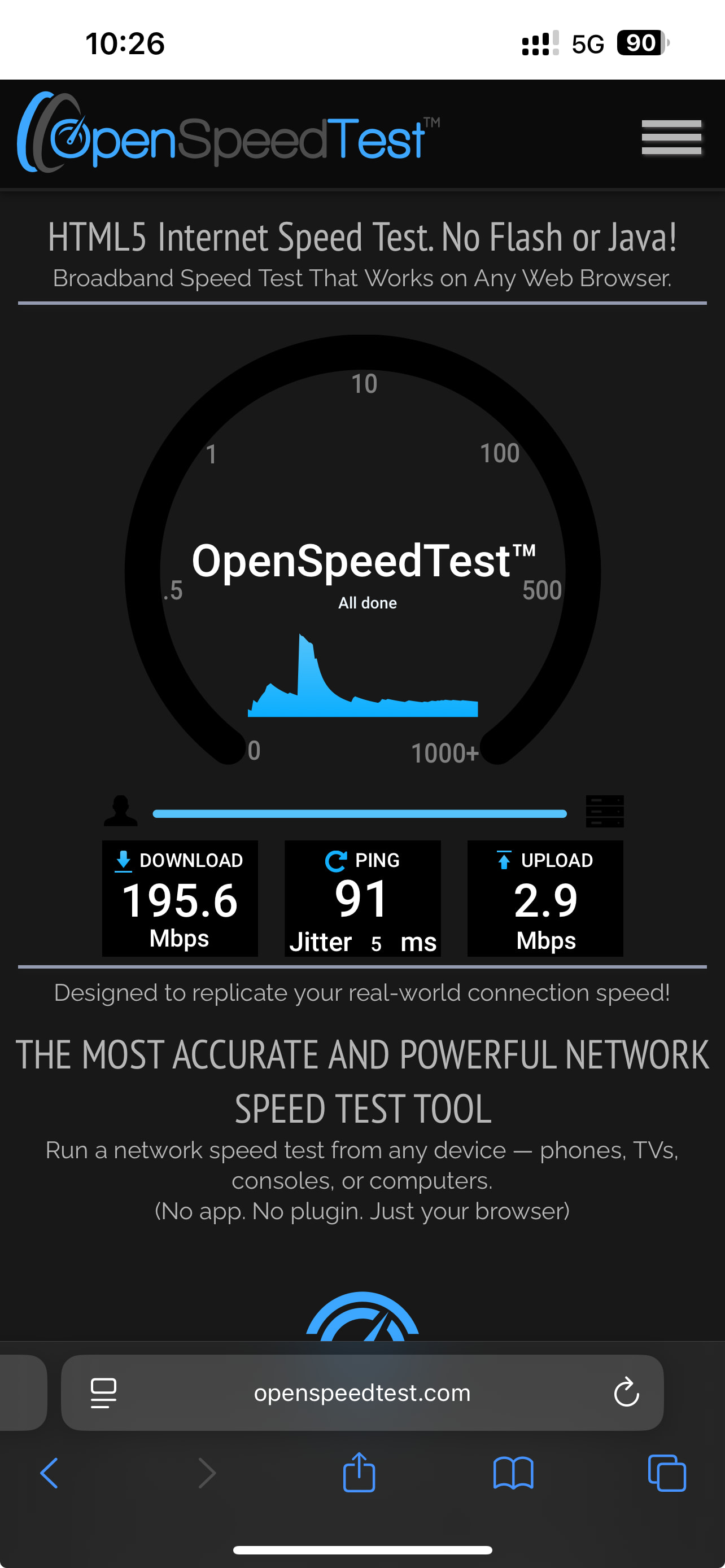

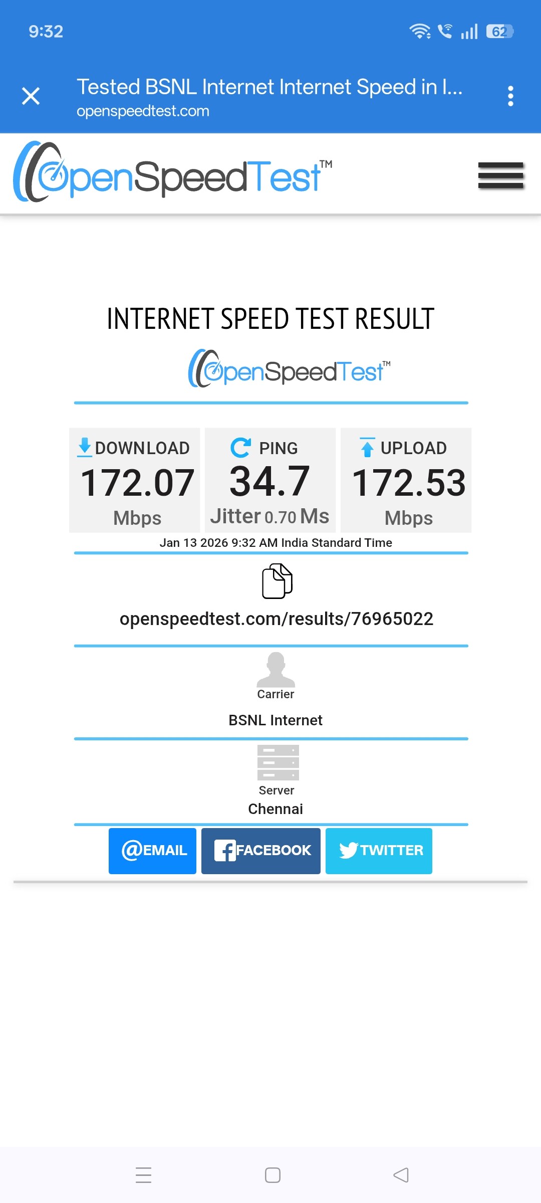

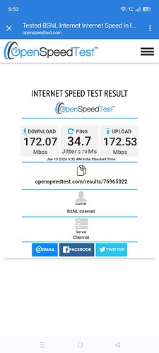

While my 150mbps bsnl FTTH speed is this:
One technology is wired - which is more reliable than the wireless 5G as base.
Check here - https://openspeedtest.com/
BSNL 150Mbps FTTH
Jio 5G
Call 198.

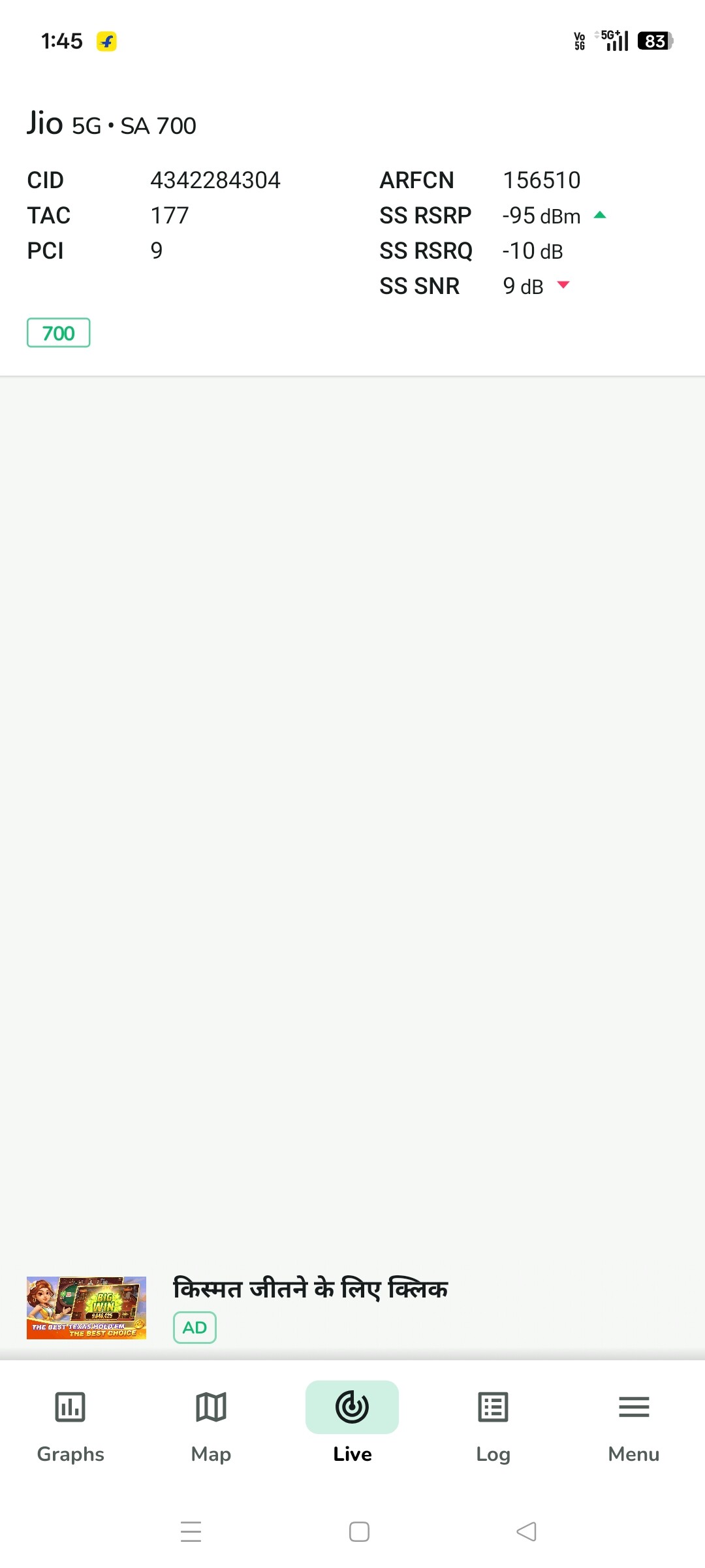

This is mine, re-added to my phone recently. Was in a thinkpad before. Postpaid 4/5G unlimited plan. I get 700Mbps up and less than 25Mbps down.

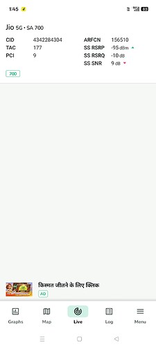

Did you check if you’re on 3500/3700 mhz band? Download netmonster app from playstore and check which frequency you’re on. 850mhz bands travel farther but with lower bandwidth.
Share a screenshot once you check.

Explains why. Move around your place to find a 3700mhz / 3500mhz band. When you do, you can run a speedtest again and report back.

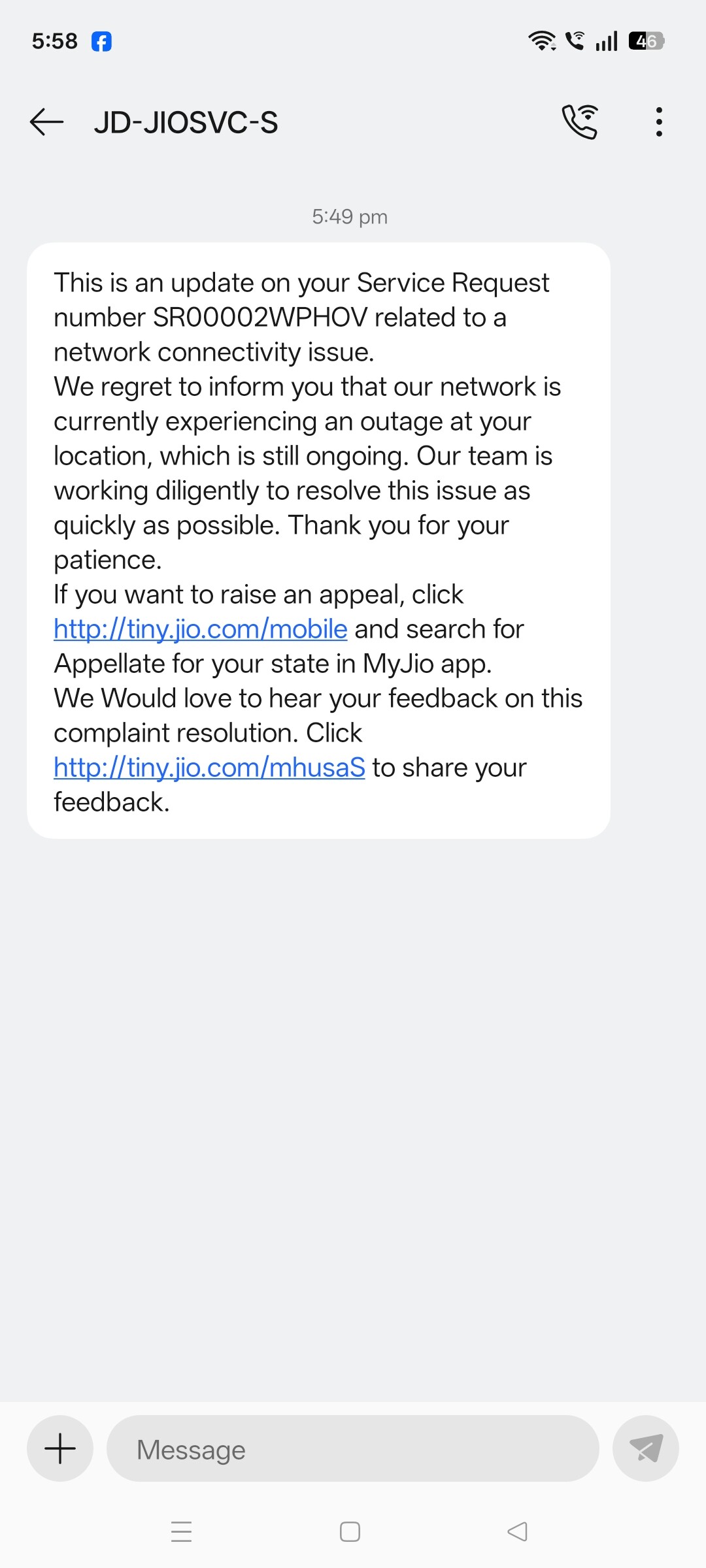

I received this just now after raising a complaint with Jio CC.
As per my understanding, SNR around (9 dB) is usable but not good for 5G speeds. Also, speed is not decided by SNR alone. As @2kool2btrue suggested, try moving around your place to see if your phone connects to 3500 MHz / 3700 MHz. Even if you still get slow speeds or high latency on a high speed band, it could be because the nearby tower is using microwave backhaul instead of fiber, has high user load, or the signal is struggling to penetrate indoors due to walls.

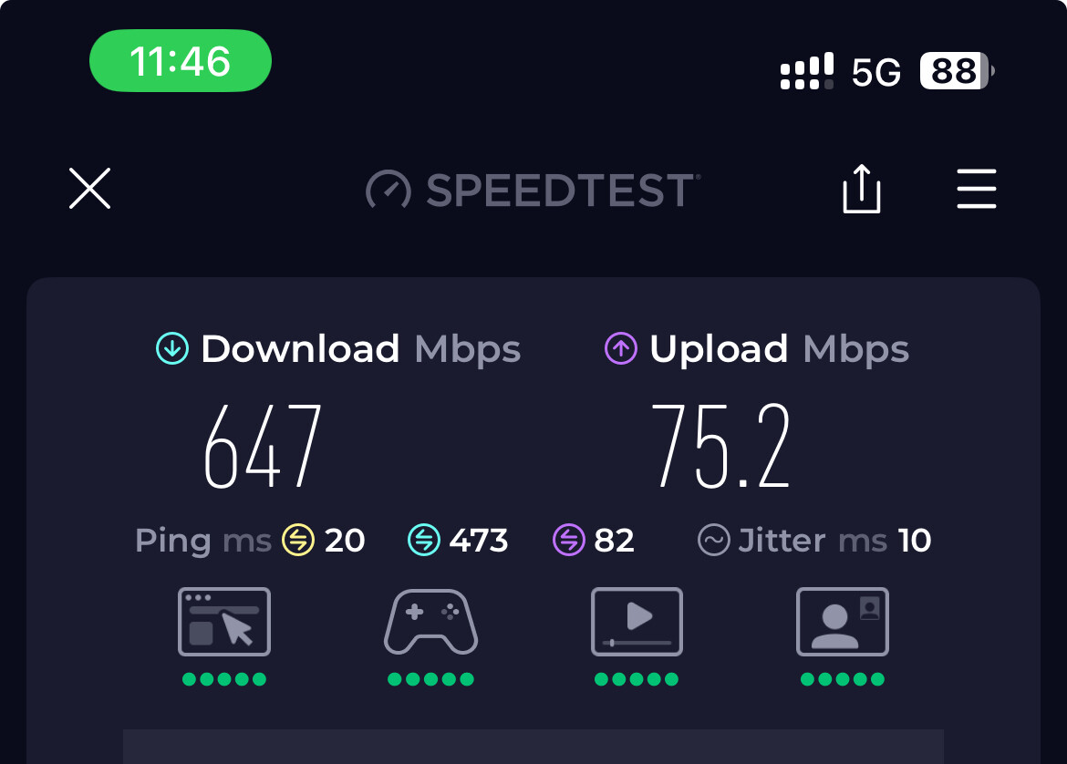

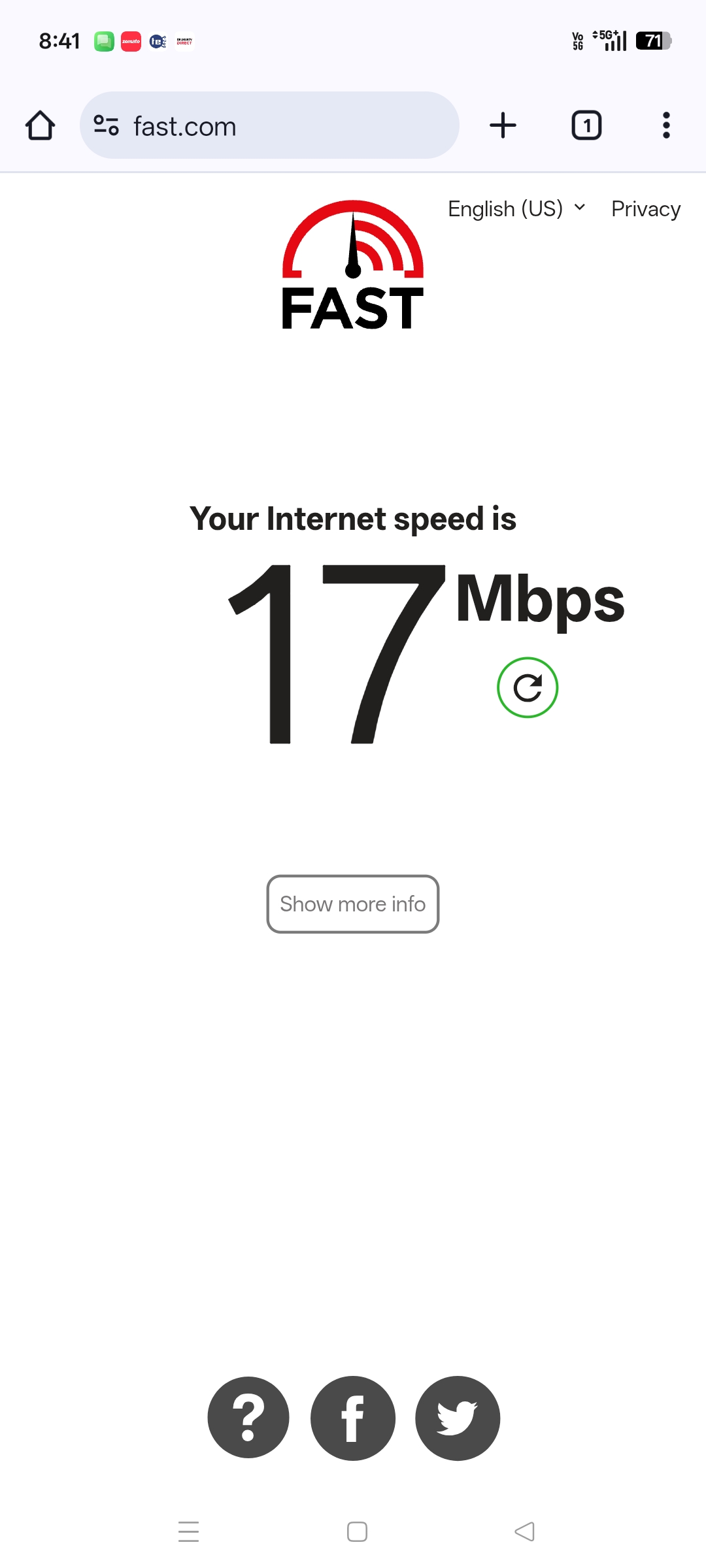

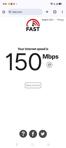

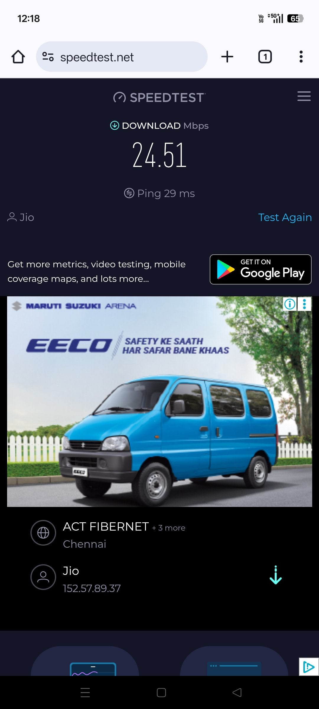

Speeds for me vary wildly on cellular (8-600mbps), depending on time of day. On both Jio,Airtel 5G.
~120 late night, ~600 early morning, ~25 during the day, and ~10 in the evening.
it’s not a signal related issue (wifiman shows ~-81±3 db i.e excellent connection). At my old place, used to get 600-750mbps all day.
traffic congestion, and infrastructure capacity are probably the limiting factors

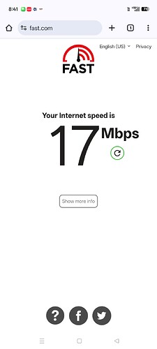

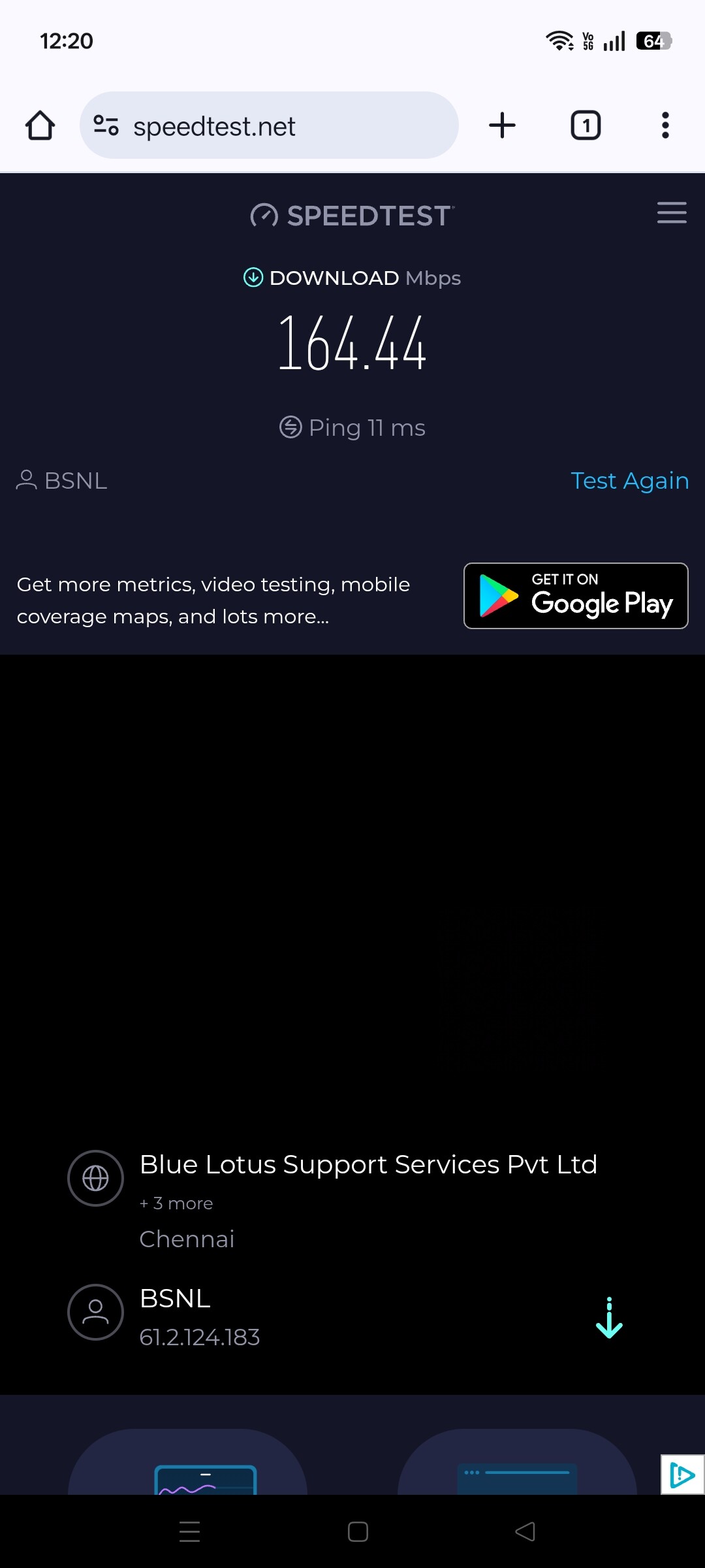

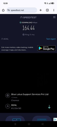

I am getting these speeds at 12.19 AM in the night on my 5G Jio.

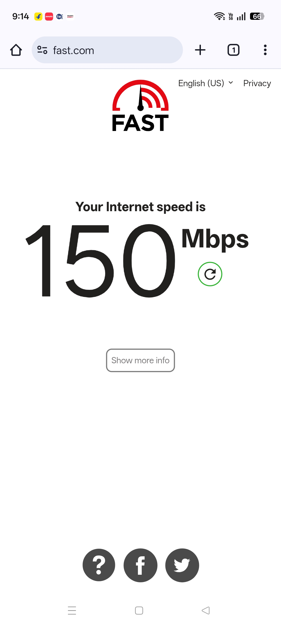

While I am getting these speeds at 12.21 AM in the night on my BSNL FTTH plan 150mbps.
