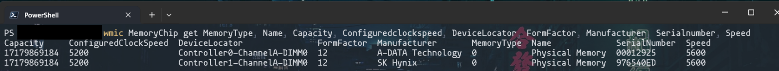

Mine shows this. 5600Mhz rated DDR5 running at 5200Mhz. Although the Manufacturer is different the OEM is same Hynix.

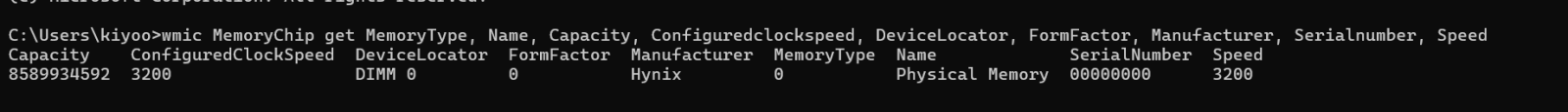

see
Looks like basic Hynix OEM 3200 Mhz RAM. You should be able to find matching RAM in the market easily which should not cause any conflict. If its possible I would suggest a local computer store which allows you to swap in case of mismatch.

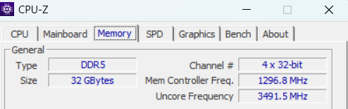

Mine is DDR5 so this is my value.
Channel says : 4x32 bit. This is basically multi channel mode which is different from dual channel or quad channel mode in DDR4.

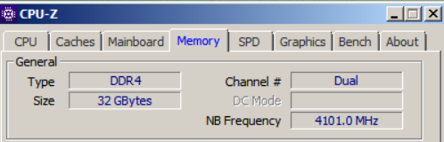

For DDR4 this might show.
