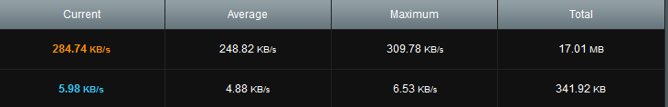

see the attached screenshot. I am downloading a file around 280 KBps and upload is around 6 KBps still being utilized to the remote server. That is handshake and that is how TCP/IP protocol works.[DOUBLEPOST=1415773921][/DOUBLEPOST]Another option is to setup QOS on your router. You can give the higher preterites to WWW and other required services.
