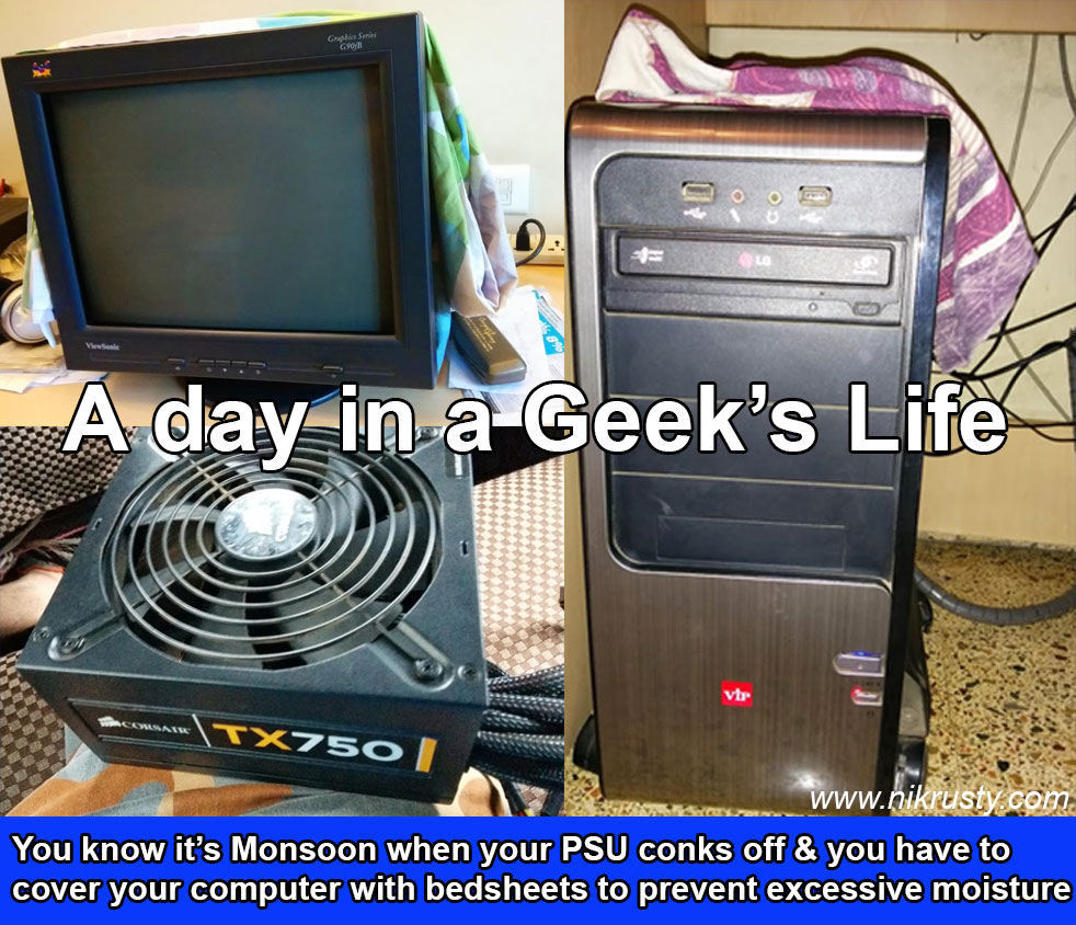

What do you do for helping your PC deal with moisture in the Monsoons?
Things that have helped me...
- Keeping the PC on, this spends the most energy but also keeps the components warmed up
- Use a hair dryer on PSU's and CRT monitors
- Covering the PC with a bed sheet over the PSU
- Silica Gel can help, though don't know the extent to which it does

Is it a good idea using a hair dryer on an electronic item?
Don't they generate static charge in some manner?
Apart from that it will also force minute dust particles and moisture inside, which creates an even bigger problem than what you're trying to solve.
The computer shops open up the cabinet/laptop body fully and only then use the blower. Less chances of dirt getting stuck in nook and cranny. What the OP suggested was using the blower from outside.
