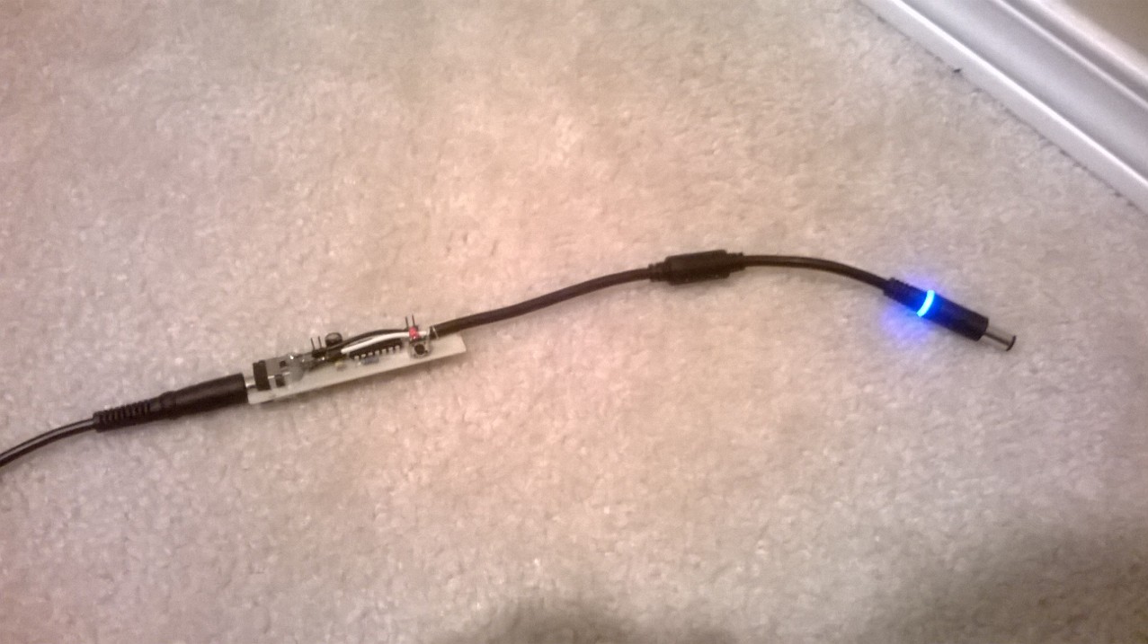

There are third-party power adapters that mimic the behavior of the third, central data pin.
Many Mini PC sellers often bundle third-party power adapters, and they work without triggering any "inadequate" or 'non-genuine Dell accessory' warnings, which can throttle performance.
