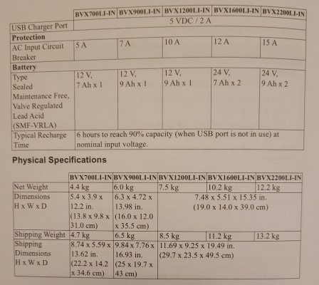

Can you please confirm? APC datasheet shows 24V 7Ah battery but doesn't say it has two
The user manual that came with the UPS says it has 2 batteries.
Reactions: napstersquest
It has 2 24V 7Ah batteries. I got mine delivered yesterday.
It's 2x 12V batteries. Not 24v. There's typo in the manual.
