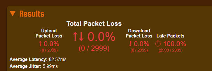

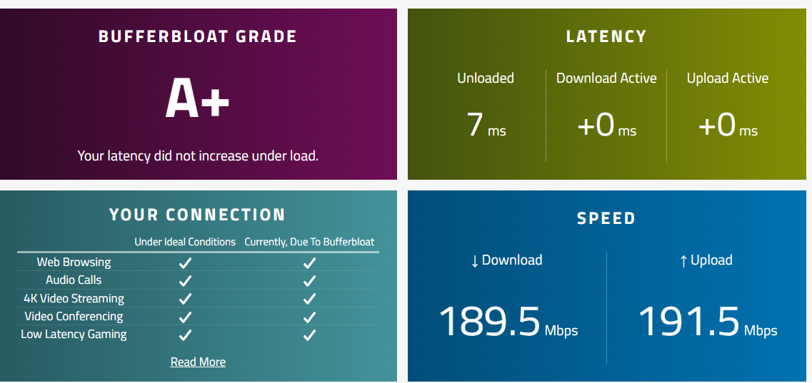

I also have Airtel fiber 200Mbps plan. I'm using x86 OpenWRT router with SQM QOS enabled using CAKE (piece of cake) algorithm.
Here are my results:
