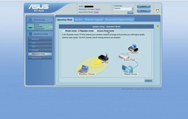

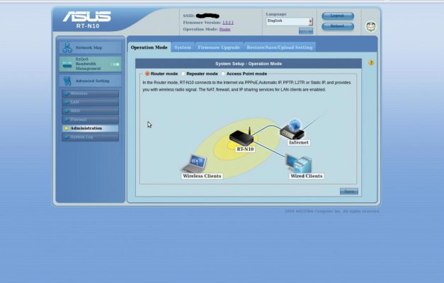

I have Asus RT-N10 and it does have repeater mode, for your convenience I have added the photo also:
[attachment=10665:17636.attach]
[attachment=10666:17637.attach]
  • Screenshot at 2011-12-16 01:01:16.jpg

I think it should because basically what 'Repeater Mode' means is extending your wireless network, that is what you want, I would be happy to help but I don't have any other router to try the repeater mode

It works as repeater mode with any router and yes you can plugin ethernet cable to use it when in repeater mode.

Just pointing out that I just got this router and as far as I can see, it will not work as a repeater wirelessly.
Edit: I guess it will work if you follow the instructions in the link above, but not out of the box.
Edit 2: Saw the pick above, and it seems that I must be having an old firmware, as repeater mode is not there at all. Will update and see.
Updated firmware and I still don't see the 'repeater' option.
Duh, the router I have is the RT-N10LZ
