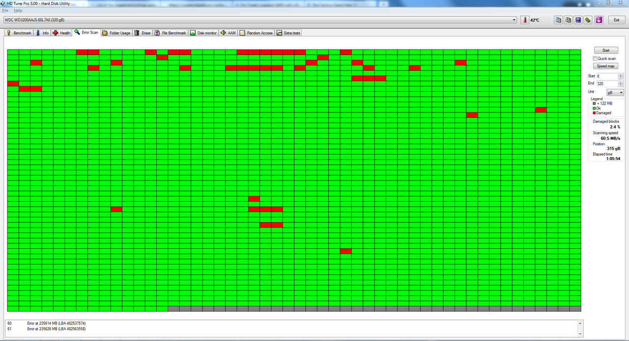

My PC was acting strange from a few days Hanging every few minutes . I was getting random chkdsk on boot . I am doing an error test with HD Tune , i'll post the screen shot once that is completed.
1. Bad Sectors = Drive Dying??
2.Can i use the Drive with bad sectors??
3.Can the bad sectors be repaired??
4.Anything else i should know

Total 61 bad sectors. The Drive is still under warranty. It is a WD Caviar Blue. What happens to the data on this Drive during RMA ? . I have nothing to backup , i should buy a 50 DVD set and fill them up with this.
