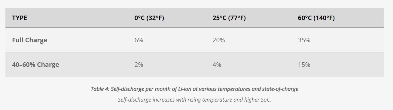

Does it help to disconnect the battery from the mobo if one is not going to use it for many weeks?
Not really, just charge it up to 60% and leave. Disconnecting the battery wouldn't make a huge difference, but if it does then there could be a another problem.
Thank you. So, 15% discharge seems ok in this 40ish degrees, as of now, weather?
You said to charge it upto 60% and leave, why 60%? Why not 80% or 100%?
